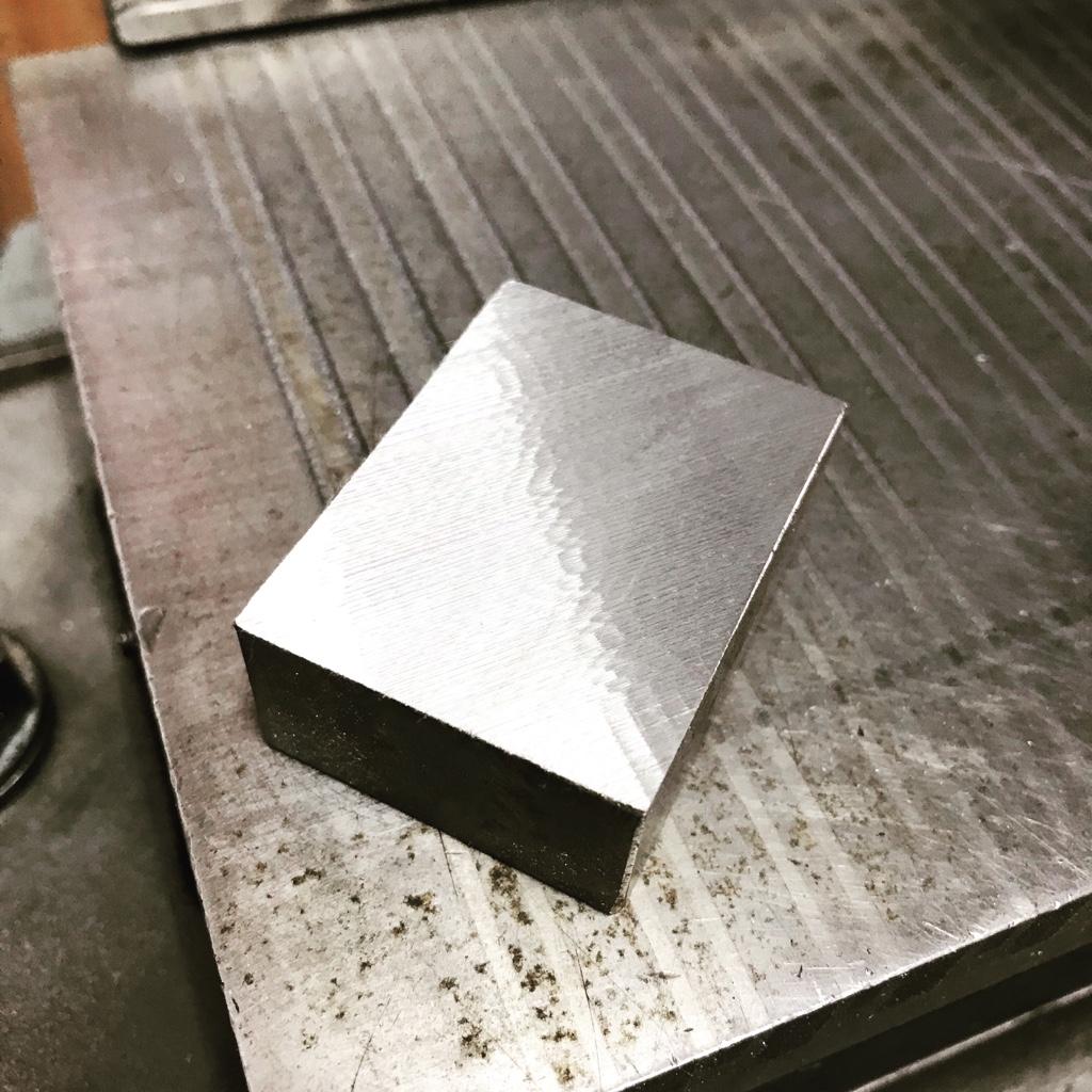

Tried grinding the same piece again.
Slower feed and lighter cut.
Made a difference.

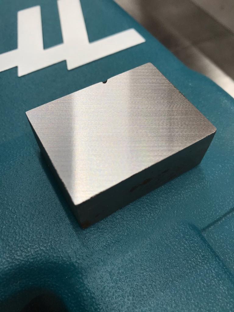

Dressed the wheel with my new diamond dresser.
Slowish passes, .050 step over.
Big difference! This one is glass smooth.

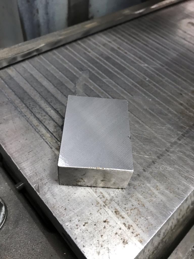

This is with an undressed wheel. I can feel the ridges on this one.
