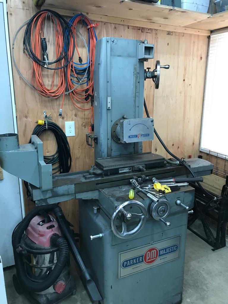

I thought I’d start a thread to document the general clean up of the Parker Majestic.
I wrestled it into place this morning.
I don’t have any in progress pics as I was too busy trying to keep it blocked amd level.
Edit: I used my 2-ton engine hoist to lift and position the machine.
All in all it went well. I used two 10’ long straps each rated for 2600lbs in cradle configuration (12 footers would have been better) and ran a chain rated for 5 tons through the loops of the straps and connected the ends with a 2 ton connector.
The hook was just above the spindle so I had clearance to the beam in my shop.
Once the hoist was bearing the weight I pushed and turned it into place.
Went well actually.

Took some time tonight to start cleaning up the P-M.
Pulled the chuck so I could see the condition of the bed. It looks awful but it’s just dried oil.
The chuck has a funky actuation shaft so I wanted to investigate that and take pictures for the Walker folks so they can ID what’s required for a proper handle.
The chuck came apart very easily. The inside is coated in petrified grease.
There’s virtually no wear on the internals or the lever, the fit on the stub on the chuck and the pin on the shaft is nice and snug. Just need to figure out how to remove the heaps of goo.
Also pulled the table stops and middle limit thing (no idea what it’s actual name is), gave it a good wire brushing and vacuuming.
I don't plan on repainting it but this top surface will get painted so it's easier to clean.

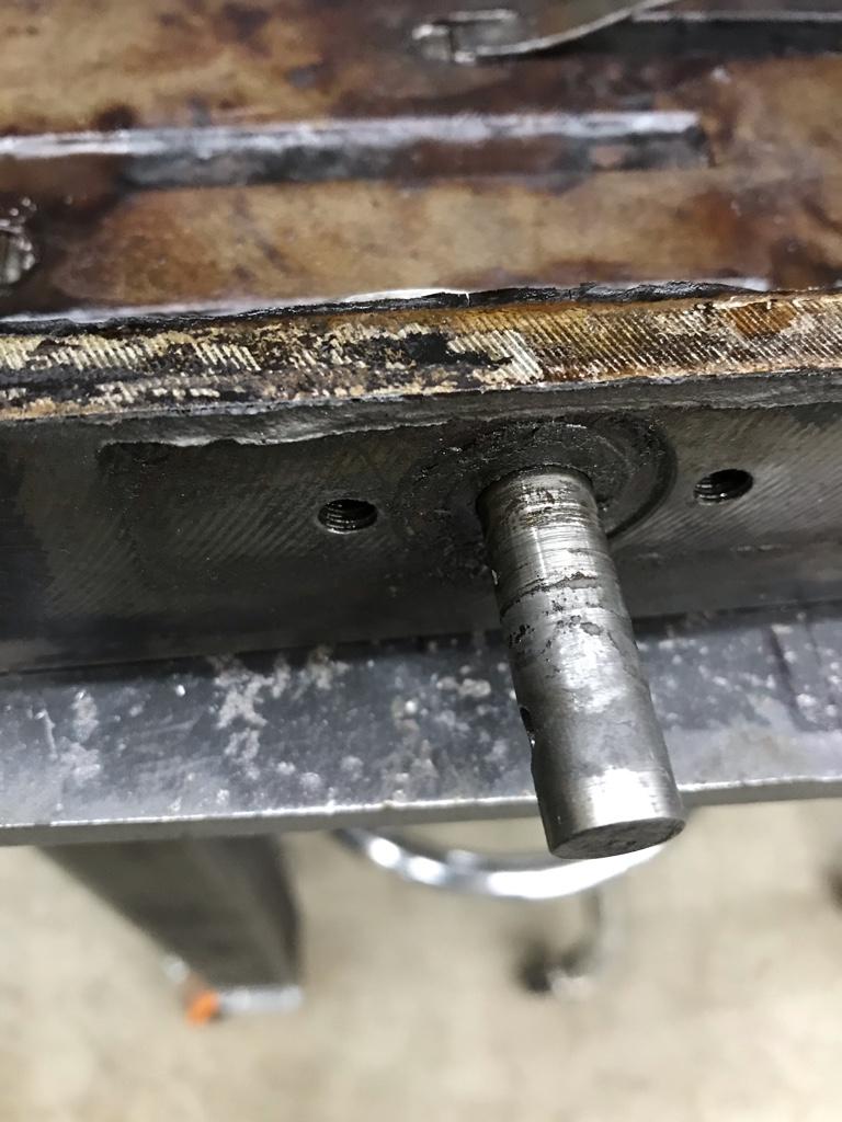

I heard from the Walker chuck folks today.
The chuck has somewhat mysterious provenance. The block on the side must be a shop-made addition as is the square actuation drive.
Advice is to clean all the goo out of the inside but to not separate the magnetic pack due to the risk of injury and damage to the components.
.25" of 90w gear oil is to be added to the base.
I'll have to either make a handle or re-make the square drive because it's a wobble-fest now.

Perhaps the original folding handle interfered with the table edges - so they took it off and made an extension and just used a square drive handle they had kicking around?
the folding handle on my mag chuck is a really tight fit with the table.

That's a possibility. The odd thing is that the handle in the middle of the chuck. I've not seen another like it.
RobinHood
The handle location does look factory, no? Ah, so Walker is not entirely sure about the location of the handle.... I wonder if someone just used a Walker label on a “no-name” chuck?
Once it is all clean and functioning, then it really does not matter.
RobinHood
That handle attachment looks even bigger that the newer, flex handle ones. Maybe it came off (and the extension built) as soon as the chuck was installed as it never really fit the table properly.
That’s a very good assumption I think.
I may just make a new one and use a wrench. Seems like a pretty easy solution.

The rectangular block and the square drive thing are not original.
Underneath the square drive there is this round shaft and similar circular wear pattern which I suspect is from the original lever.
RobinHood
That is good detective work @David_R8. I bet it got sloppy over time and they improved it by adding the rectangular bushing bolted to the outside. I would agree with you that making a new, better fitting bushing and using a square drive will work just fine.
