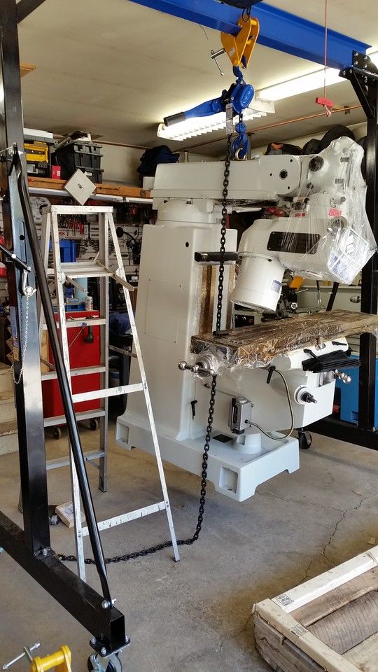

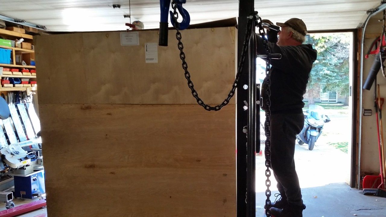

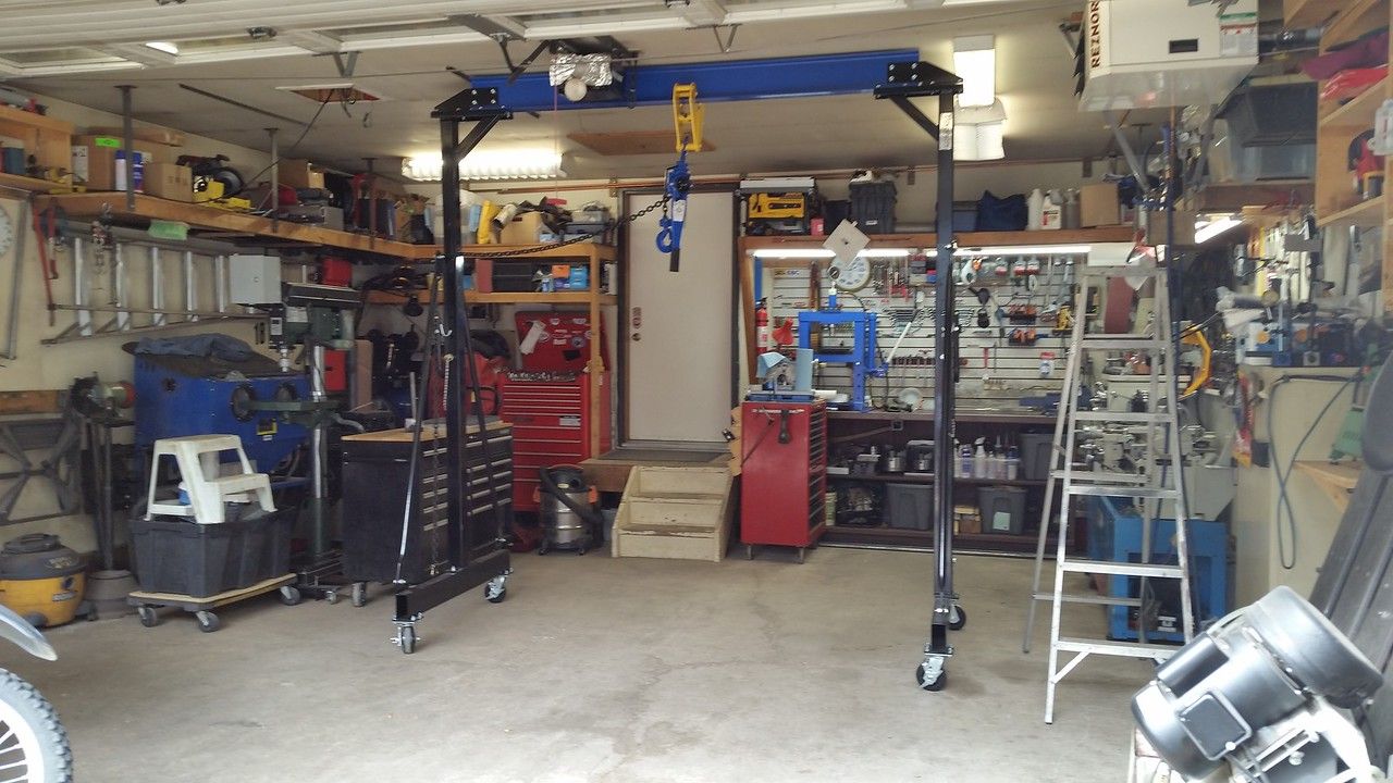

Well we got the new mill home safely. Started the day getting the gantry crane adjusted to the highest it can go in the sweet spot in the garage where there is nothing on the ceiling to hit. The beam clamp and chain hoist in place and ready to go.

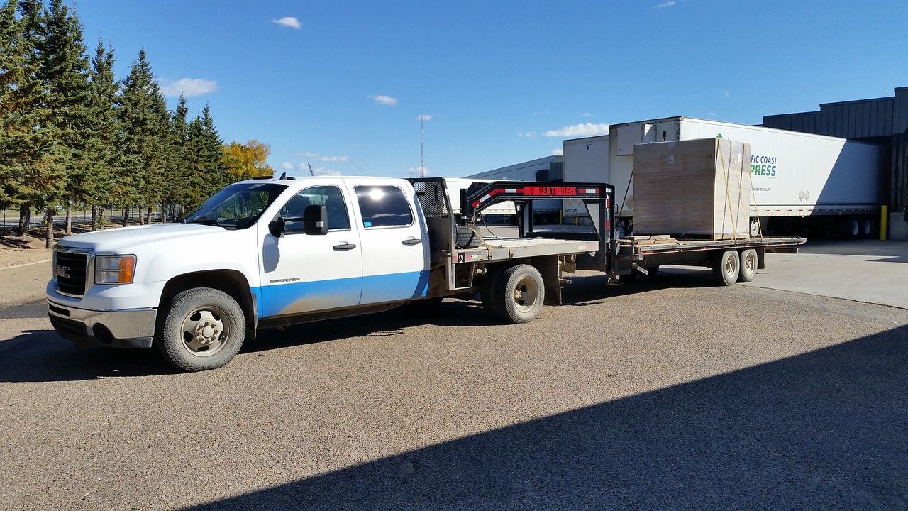

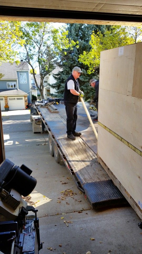

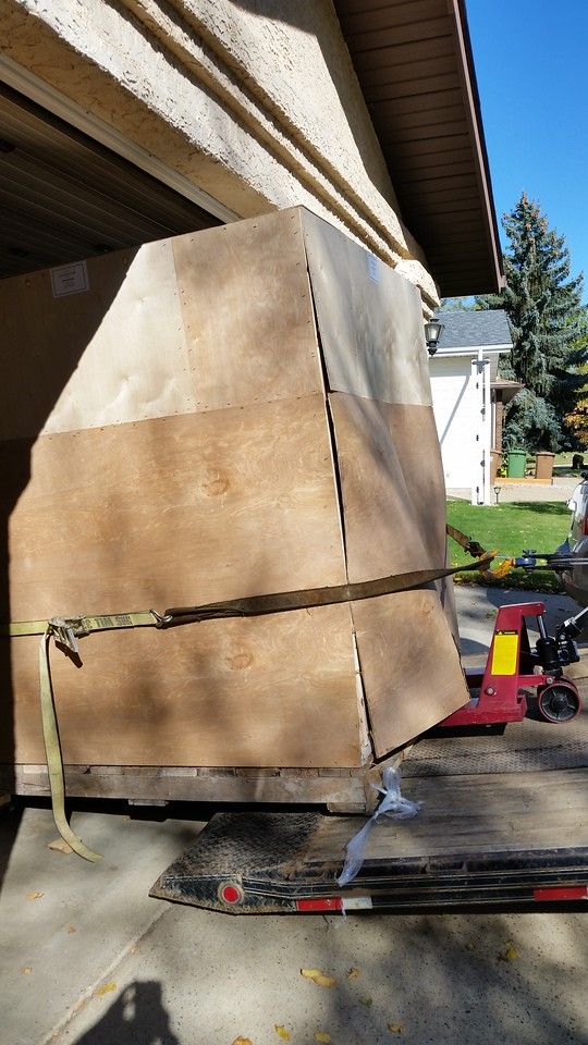

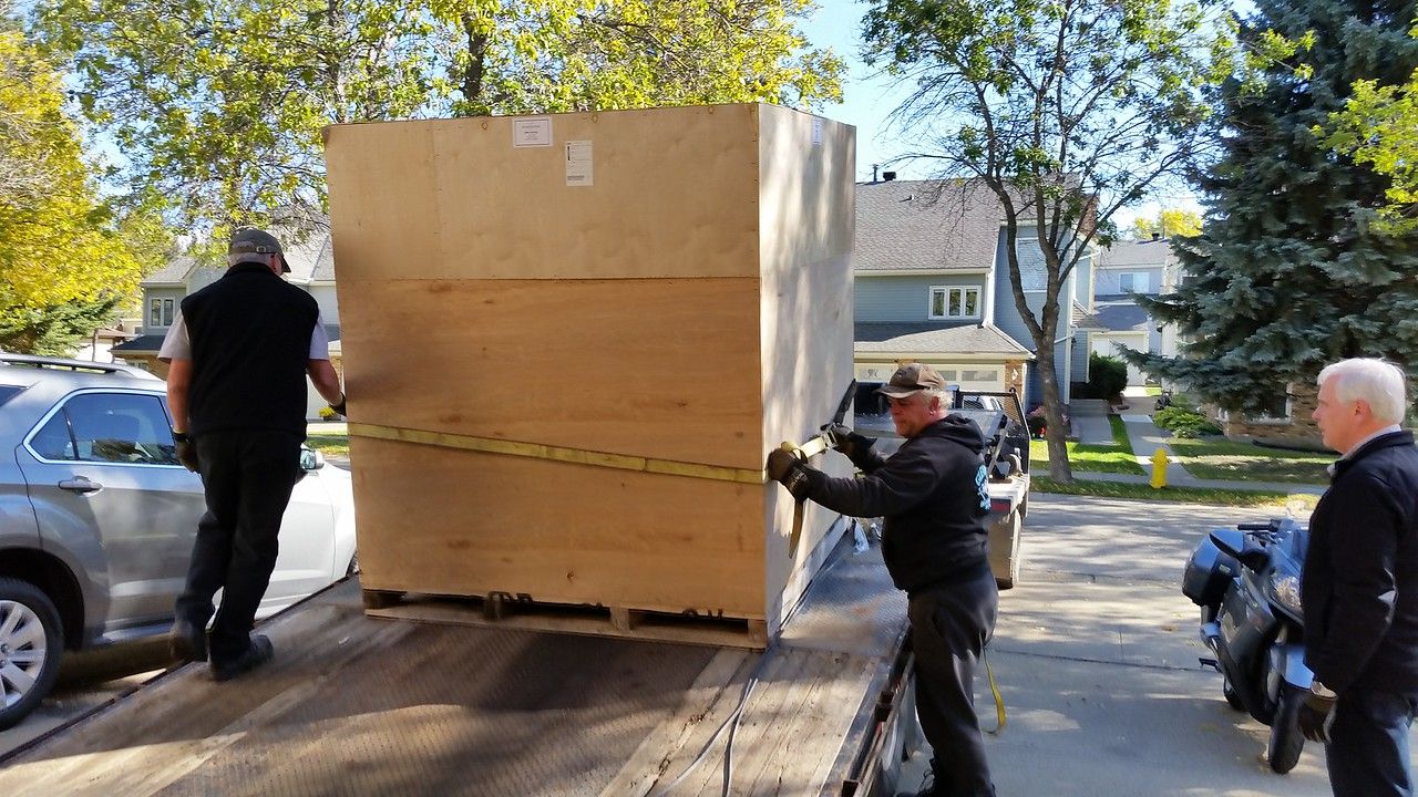

I met my friend Glenn at Pacific Coast Express and they loaded it onto Glenn's' trailer deck. The crate is 66" X 66" X 76" tall and the fork lift operator made short work of it. The crate was in perfect condition which made me very happy.

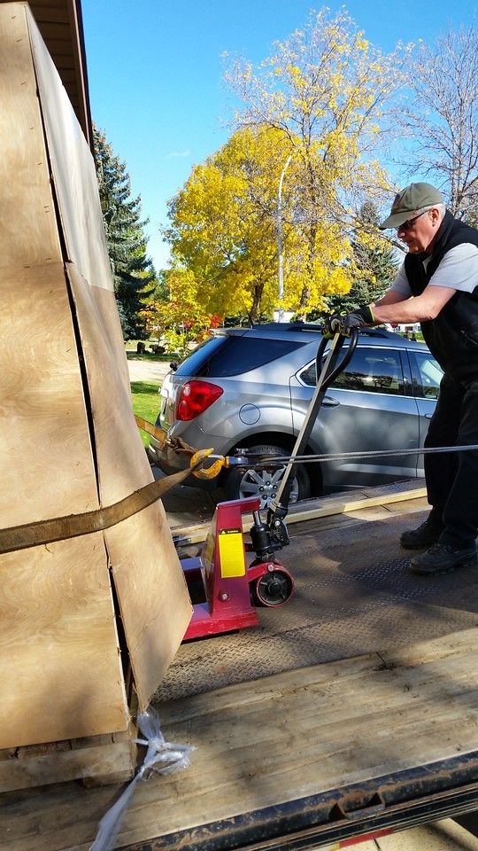

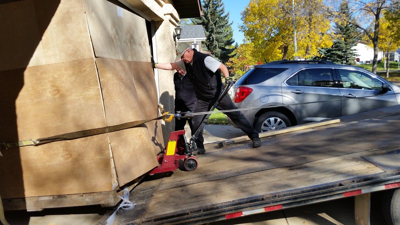

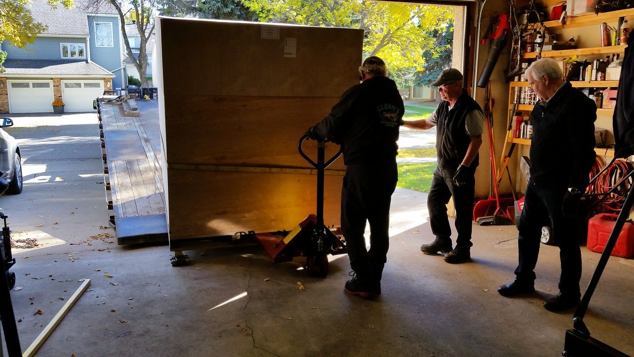

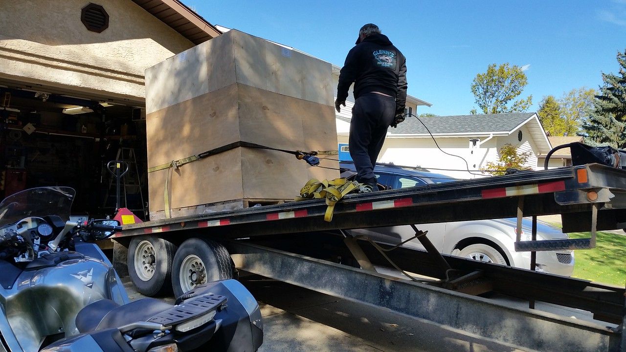

Once at my place Glenn got the trailer backed in with it's tail aligned with the door opening and we double checked the clearance through the 8' tall door opening. We put a strap around the belly of the crate and connected it to the winch cable then put the pallet jack under the downhill side. We lifted the crate just high enough so it would roll down the deck slowly as the winch was rolling the cable out until the bottom edge was off the trailer. Then with the pallet jack raised as high as it would go we put the machine skates under the bottom corners.
Then we moved the pallet jack to the uphill side. The skates allowed the bottom edge to roll into the garage as soon as the weight was raised and we let it down slowly with the winch.
We jacked up the pallet jack as high as it would go and placed the other 2 skates under the front edge and when we lowered the jack the weight was all on the skates and it rolled easily into the garage.
Once all 4 corners were on skates and we rolled it into the garage we celebrated with a cold beer.

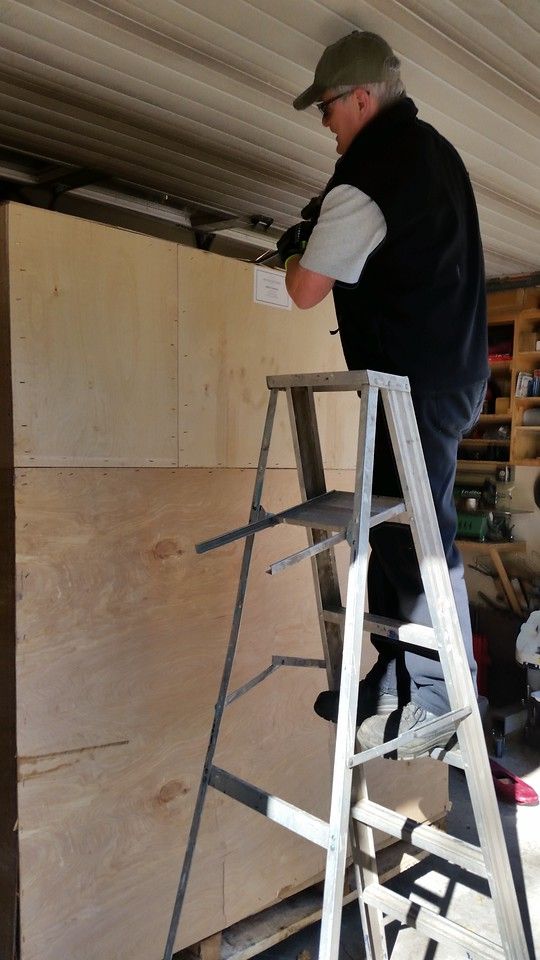

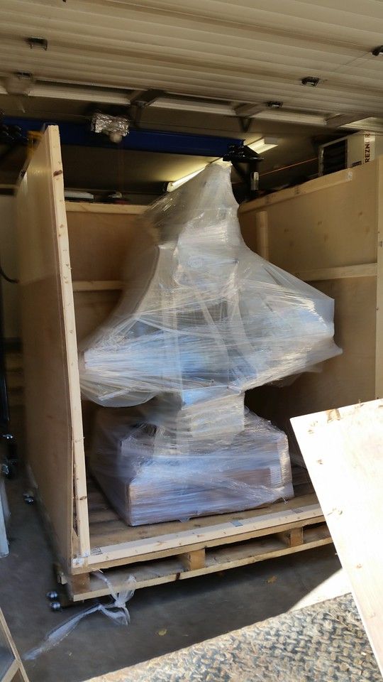

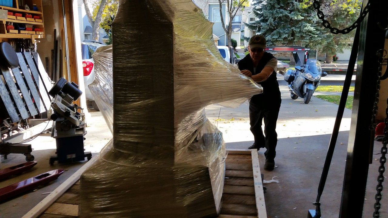

Then we popped the top and sides off the crate, which was amazingly flimsy. I think the plastic wrap around the outside was most of what was holding it together.

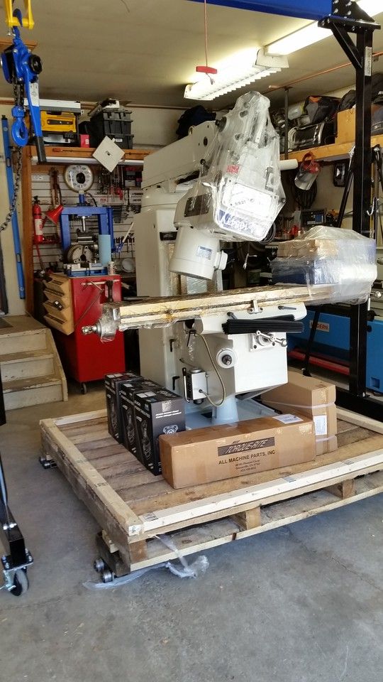

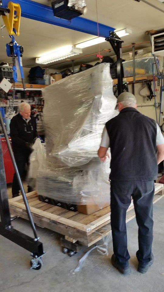

With the shell removed we rolled it under the center of the gantry crane and stripped off all the plastic and removed the accessories from the crate.

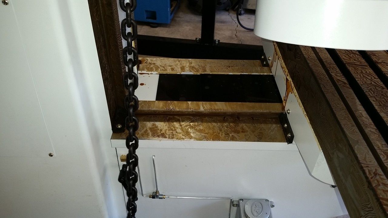

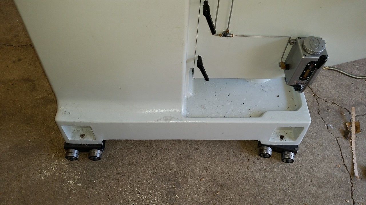

With all that stuff out of the way we removed the 4 half inch lag bolts holding it to the pallet and raised it with the chain hoist so we could drag the pallet from under it .

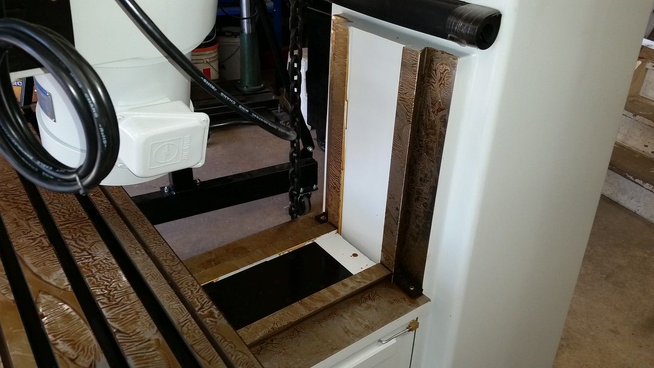

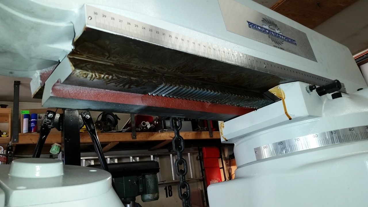

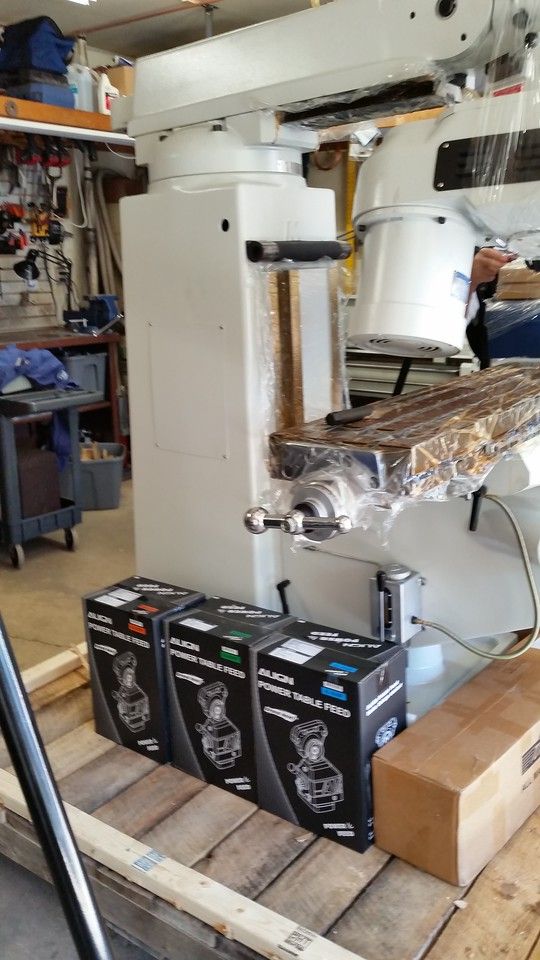

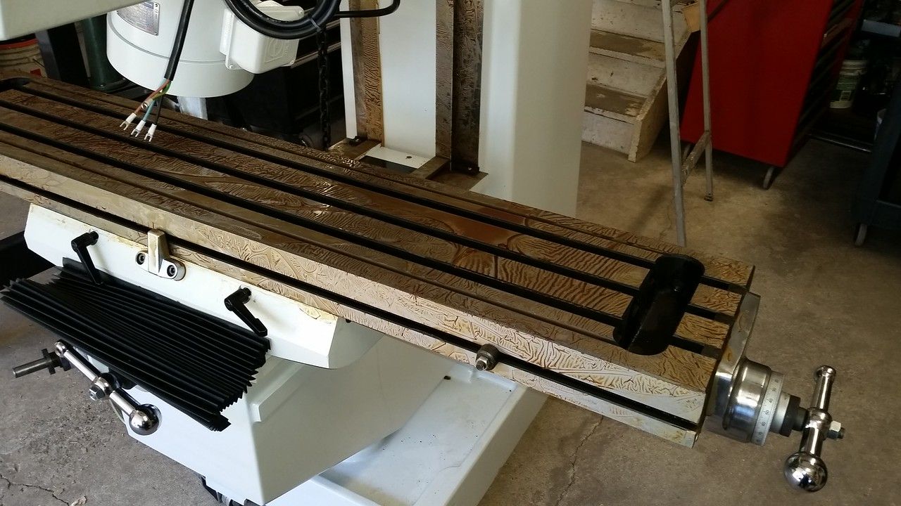

We set it down on the skates and had a close look at the machine. As far as I can tell it all looks good but I'll have to clean off all this packing grease to be sure.

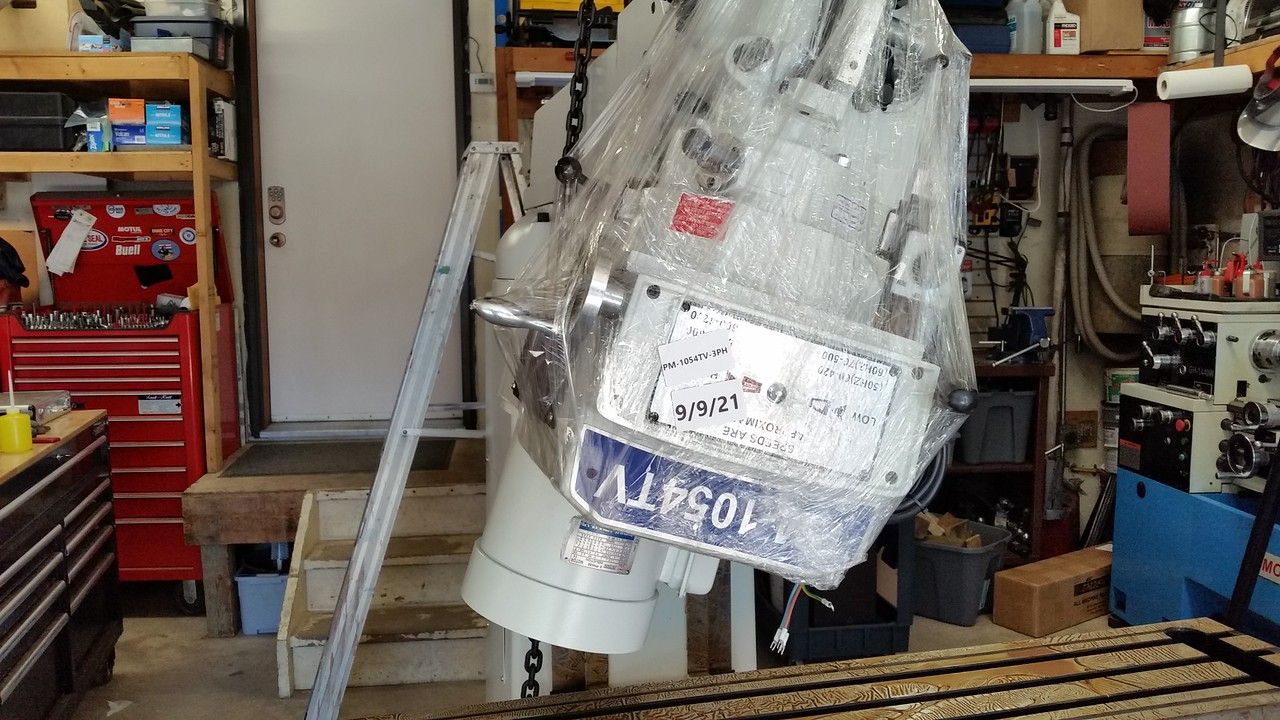

The pre-delivery inspection was done on Sept 9 according to the tag they put on the head.

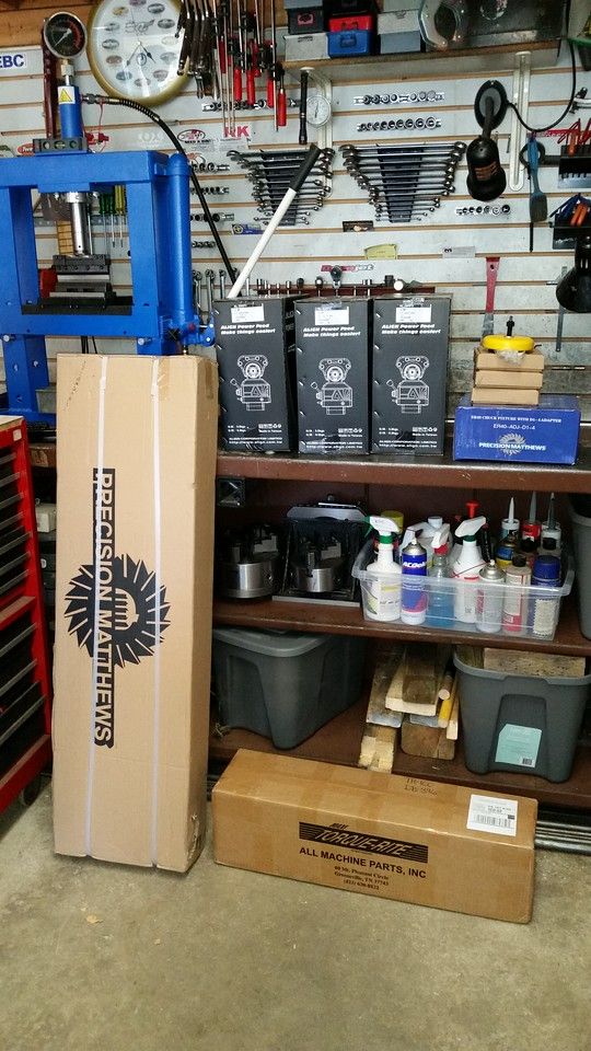

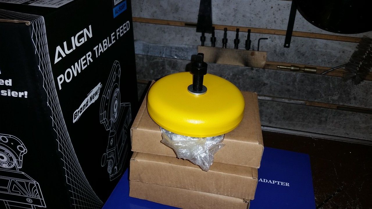

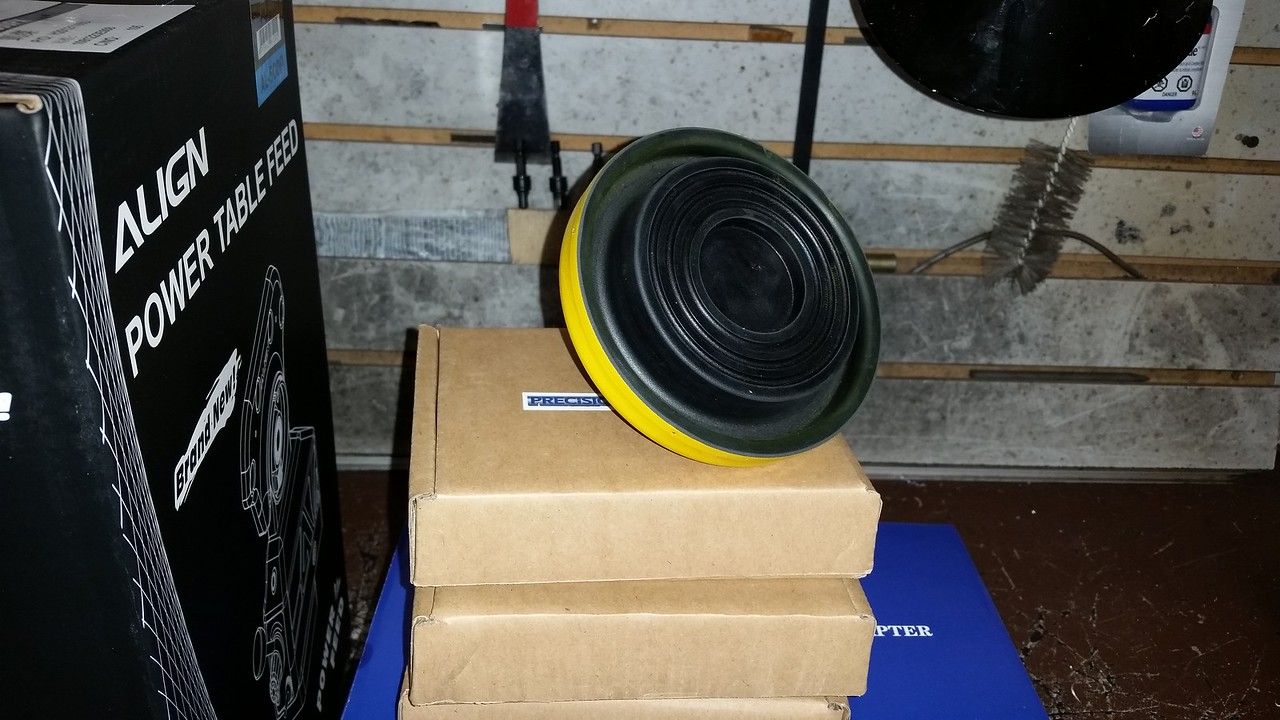

All the accessories I ordered were in the crate and now the fun begins to install 3 power feeds, a DRO, a power draw bar and the VFD.

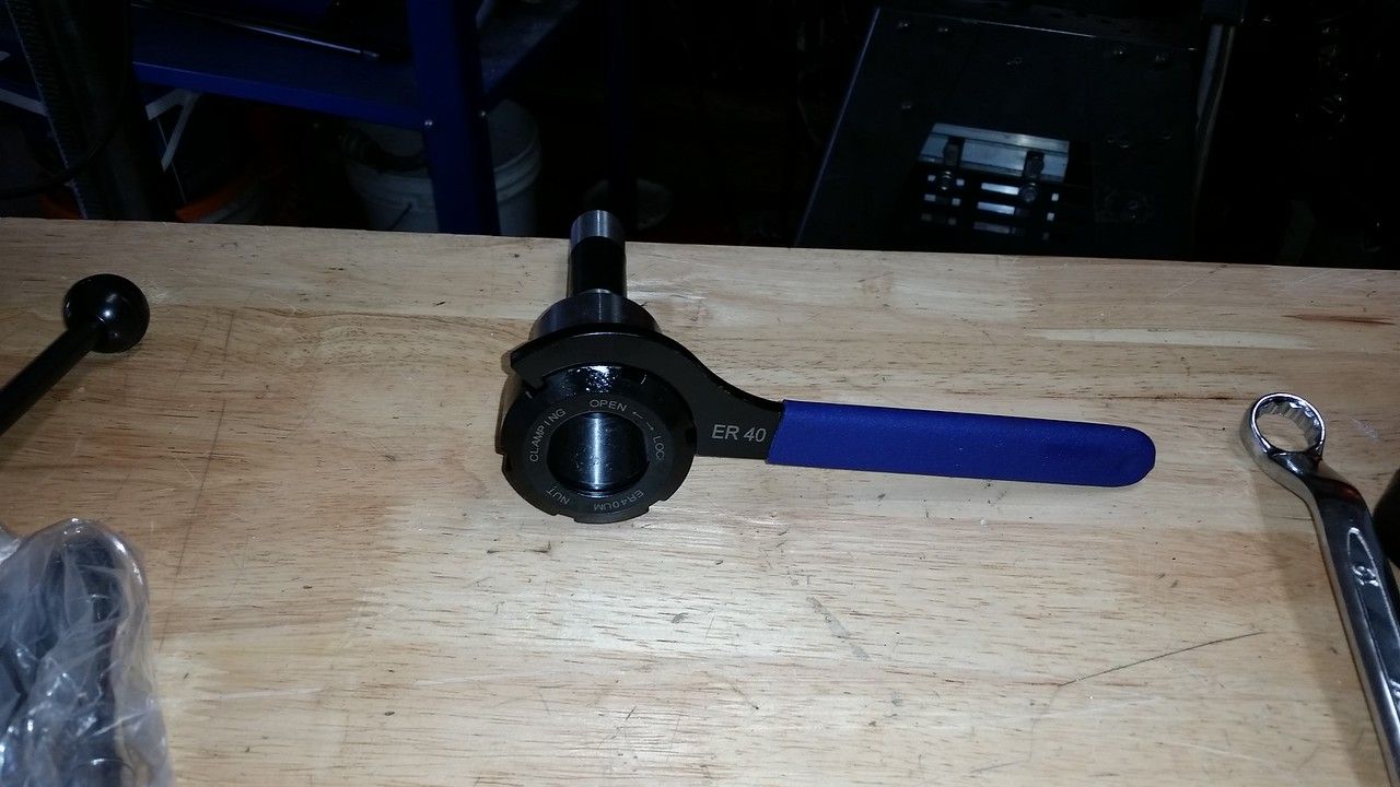

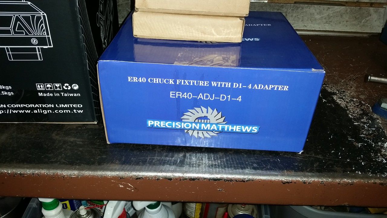

The ER40 collet chuck I ordered for my lathe was in there as well as a R8-ER40 chuck for the mill. The ER40 wrench even fits the chuck Mike!
That's it for today, tomorrow morning the cleaning of the brown spooge will begin.
When my lathe arrived, there were two horizontal slots in the box. Exactly what you would expect when an unhappy forklift driver tries his very best to damage the contents. Fortunately, the forks went into empty space inside and nothing was damaged. I'm glad nobody was there to take a picture of my face when I saw those holes.......
When I saw the photo of you rolling it off the flatbed, that's all I could think. Omg, what if that box collapses? In my experience, everything gets fastened to the base skid, and the box is just a dust cover.
