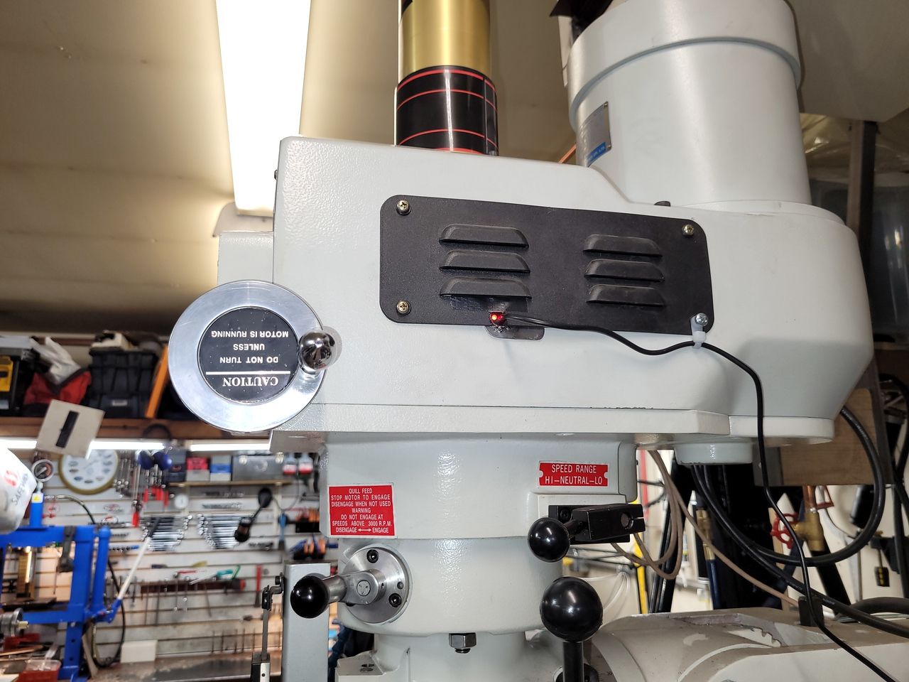

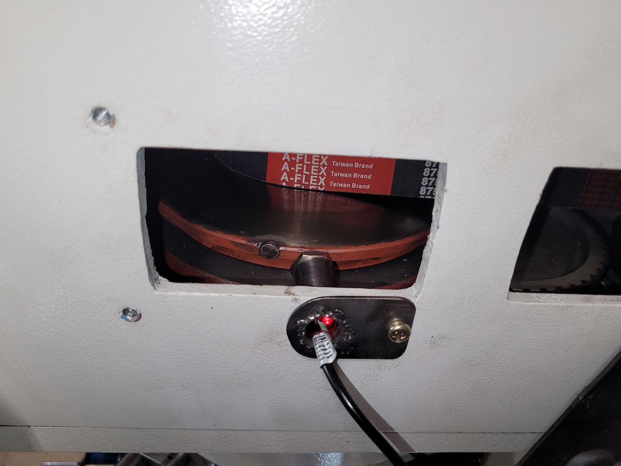

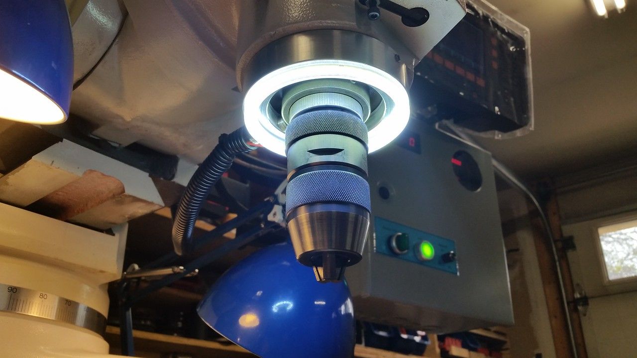

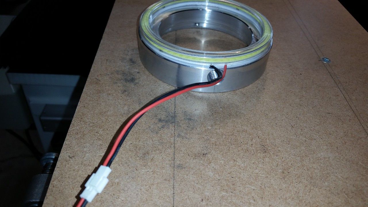

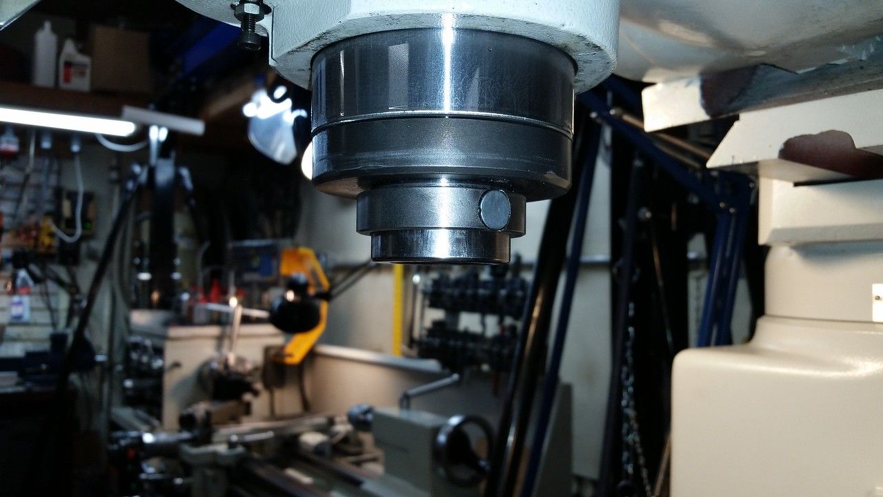

Today I made an update to the tachometer on the mill. I'm using one of the cheap digital/hall sensor tachs available on ebay or amazon and generally have been happy enough with its performance. When I installed it I machined a ring that is slip fit over the spindle nose to mount the magnet and I mounted the sensor in a threaded hole in the same aluminum housing I used to mount the spindle halo light.
I really didn't like the collection of swarf that built up on the magnet. Only a matter of time until some of that made it's way into the spindle taper. I got brave yesterday and drilled a 8mm hole 3mm deep into the edge of the lower sheave on the spindle belt pulley and installed an 8 X3 mm magnet with epoxy. the hard part was measuring the exact height of the pulley compared to the outside of the head casting but I managed to hit it dead center. I started with a 1/8" hole then went to 1/4" then 8mm. I had to make a sleeve with M12 X1.0 internal thread in order to get the sensor close enough to the magnet to trigger. This arrangement will only be accurate when using high range but I'm OK with that.
Of course I dropped the hall sensor and had to buy a new one but it works fine and I'm relieved I don't have to worry about that magnet on the spindle nose. anymore.
