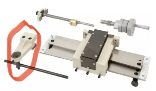

I have this style on my Modern lathe, but I find i have issues getting the part circled in red to clamp tight enough to the ways. I get movement in two joints when moving the carriage . I suspect I have the gibs too tight but wanted to hear if others have issues .

Hmmmmm....... This very fear has been bothering me. When I looked at the way it all it works I realized that this reference anchor is a weakness in the design approach. I had wondered if that part could use a redesign to improve its functionality?
I'll take a better look after it arrives. Might be of benefit for all of us with similar designs.
I'm also planning some other major changes to the cross-slide to accommodate putting my DRO scale INSIDE the cross-slide. These plans will also have to modified to accommodate the scale sensor at the back of the cross-slide.
Should be fun.
Looking forward to the retrofit. Take some pics of the new/replacement feed screw assembly that facilitates taper turning before installation. I think I understand the general principle it but I've only ever seen the same catalog pictures you show & some rudimentary part schematics. Unrelated but I've been collecting ideas for better ABL nut vs the standard slit & set screw approach. Some good ideas but many of these might not be a good match to our particular layout constraints with yet more mods.

Kevin - I have problems with mine too. I think the taper attachment on the Modern 602A is really poor. It's crummy and really fussy to set. The angle gauges only get you vaguely in the right area. I don't see how that hand wheel on Susquatch's attaches but that looks pretty appealing. Anyway I tried to use mine once and gave up, went back to setting the compound and living with 3.5" of travel. This dial indicator thing John Chaychuck @Dabbler invented makes that a lot easier. https://www.printables.com/model/297110-lathe-compound-taper-angle-setting-tool .. there is a thread on here somewhere about it.
