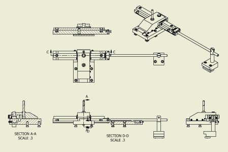

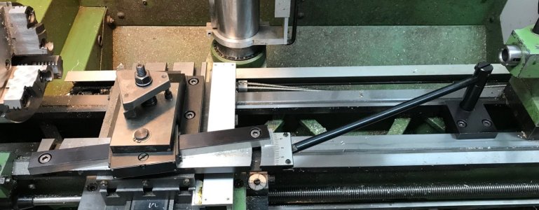

To achieve that, it looks like that slide is tethered to the lathe base with a rod so it is fixed in position on the Z axis independent of carriage motion. You can see the rod in one of @Darren ’s photos of parts in post #88.
Yes. I guess I assumed that all taper attachments did that. The OEM TA for my lathe does it like that too. So for me, that part was the easy part (the light bulb glow). I just couldn't see how that got translated into a solid tool movement to cut the taper.
I also wonder how much of cosine angle effect the tether bar has when doing large angle tapers.
Assuming that it's like the one for my lathe, it doesn't matter because neither the bar or the taper guide move once they are set and locked in place. Whatever sine error is there simply becomes part of the taper itself!

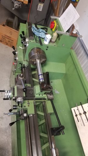

I have an EMCO taper attachment for my SUPER 11 which is a similar design concept to the one on Darren's V13, although smaller. I changed mine from the EMCO designed assembly so that I could turn from the front. This increased the angle of the tether bar from what it would be if the TA was attached to turn tapers from the rear in reverse but it really is of no consequence.
I was curious about the "nit-pick" so decided to lay out the geometry. Here's the layout for a 0.010 DOC.
The angle bar shifts along the Z-axis - in this case of a 0.010 DOC it shifts 0.00316. The DOC dialed in on the cross slide is reduced from 0.010" to 0.00949".
So I think the effect you describe only affects the resultant depth of cut FOR THE ENTIRE LENGTH OF THE TAPER, it does not play a role in the taper itself.
Correct - the resultant DOC does not play a significant role in the taper itself. I think that the resultant Z-axis shift is also not significant.

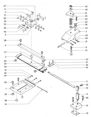

Well, I believe I have Darren's/Emco's tapering unit figured out. It took a bit. Read it all over about 5 times, slept a few times, looked at Darren's pictures, then seen eotrfish's picture,that helped, realized Darren had 2 different PDF's, tossed out the South Bend set up I am familiar with, and enough dirt came off the old rock to see some light.
The unit itself has " 2"dove tails' "and then a "slide" on the sine bar! This makes it very much independent, while the cross slide can set the depth of cut.

That is very true, once I found out the cutting head/holder block was moveing on a dove tail, it started to make me wonder. Then the sine bar being mounted on a bar with a dove tail, what the devil ! Eotrfish's picture with the link bar in it made me realize the link was able to pivit.
