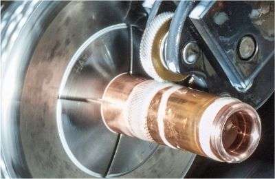

Very nice knurls. Accu-Trak is good stuff. Spendy at current FX but what isn't these days. What I like about that design is good mechanical advantage for applying required pressure & the tension rod comes back to operator. I posted this elsewhere but here is an online calculator for initial stock sizing using knurl DP inputs & all that stuff. I made a spreadsheet from Accu-Track formulas but the web calculator is easier & from what I can tell similar results. What I did in the past was make an table of incrementing 'optimal' diameters in a range you work in, say .5" thumbscrews to 1.5" whatever, then you have a handy shop reference to turn the stock diameter to for whatever knurl wheels you have.
Another thing I'm considering is a constant air blow nozzle directed at the wheels/stock made from a simple bleeder line off the compressor. Re-munching the chips on certain materials is yet another reason for mucky knurls. Operating the lathe controls & knurl & directing air seems to require one more hand than I have. I bought some of this line with those quick insert connectors for another project but it might be a good way.

I was thinking about compressor air too for knurling, but I use tons of cutting oil from a spray bottle for this application, so using air would just blow all the oil away. I don't know which would be better...oil or air?
Now to make the knobs to move the fingers in and out. Looking around the shop, I found some cutoff stainless 400 series that will work. I turned the piece down to 1.250" diameter, and decided to knurl it first before any other machining, in case the knurls don't cone out right. I'm using a Accu-Trak HD Staddle knurling tool with 96DP convex knurls.
1.250" ÷ 96 = 120 Whole number, therefore it should track properly.

Those are very nice crisp knurls. All the pyramid tops are consistent points. The streets & avenues are straight lines with no other litter or potholes LOL
