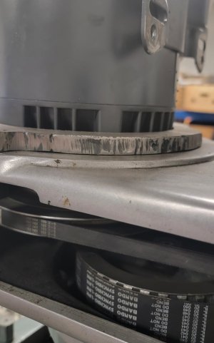

Here is one of my recent torch jobs. It's a half inch plate cut with an OA cutting torch and cleaned up with a bench grinder.
That beaver sure ain't pretty, but she is mine! And I actually like the hammered look it has. At least that's my story and I'm sticking to it! Ya, that's it. I like the way it looks!
I am a self confessed OA red-neck. But I don't find that a cutting torch really puts that much heat into the plate. Prolly a lot more than I think it does, but I think that the oxygen jet actually cools the edge while it burns the iron out. The worst of it is at the start to get the cut going. I like a lot of oxygen to keep the cut going despite my shaking and poor eyesight.
Now, I fully confess that that is a total guess. I suppose I should know the facts of this, but I just don't. So that's that.
What I can say is that the plate above is a plate I made to adapt my new motor to my mill head. It was as flat afterward as it was before. I know that for absolute certain because I had to mount it in my lathe to cut the motor countersink and there was essentially zero wobble because I didn't have to true it up or face it off at all.
That's my story but your mileage may vary.......
