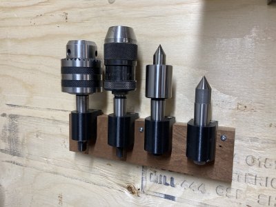

@gmihovics was kind enough to help me out with a couple more 3D-printed parts. I was looking for something to help organize the drill chucks and centres for the lathe. I'd found a holder on Thingiverse that was almost right except that it didn't actually have a MT2 tapered hole. @gmihovics modified the design and produced the following for me:

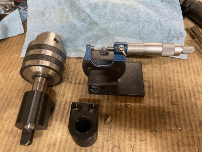

I'd also found a design for a holder so you don't have to have 3 hands when measuring an awkward part with a micrometer. You can just barely make out that there is a screw at the back that clamps the micrometer in the holder. Works well for the style of micrometer shown but wouldn't be able to clamp on a classic Starrett or Moore and Wright mic that has a cast metal frame. The picture also shows a couple of the MT2 holders before they were mounted on the wall.
Many thanks to @gmihovics. It was great to meet him briefly today.
oh the micrometer stand looks really good! I'm glad it ended up fitting.
It was great to meet you too Craig. I'm looking forward to meeting more of the members.
Very cool! Does tooling ever fit so tight in these holders they get stuck? Is it possible to get stl files for this design or for that matter an MT3 version? What is the infil %?

As a matter of fact, the tools do stick. If I just pull up, it is not easy to dislodge them. Weirdly, I find that if I press up on the portion sticking out the bottom, the tool comes out pretty easily.
@gmihovics would there be any problem with wiping a bit of oil in the holders? Oil won't dissolve this material, right?
That's a good question actually, I have never thought about that. Oil shouldn't be a problem along as long as it doesn't have any detergents in it I would think.
Prolly the same reason you can push screw driver bits out of their plastic holder but it's harder than a frozen tree stump to pull them out. Just guessing it's all in the way you deform the holder when you hold it.....???

Just remember to ipe off oil residues from Mt taper before using.

Can't help wondering if internal ridges were in the design maybe that would reduce the sticking by reducing the surface area in contact? A design improvement?
I haven't looked at them closely but there are a bunch of MT3 designs on Thingiverse for free:

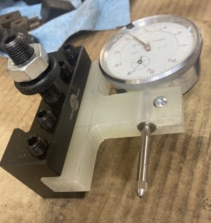

So, I couldn't leave 'well enough alone'! The 3D printed indicator holders worked OK-ish. Bu I wanted to check the run out on the perimeter of my 3-jaw chuck and found that I could get the tip of the indicator far enough away from the center line to get on the chuck. After a little head scratching, it came to me that basically a "T" shaped holder in a spare quick change tool holder would let me position the indicator pretty much where I wanted. With a 0.5 inch thickness, it would fit in the holder and be thick enough for the 3/8" stem of a standard indicator. I found I'm lacking 1/2 inch aluminum, which was my first choice, but then remembered that I have a box of 'plastic' cutoffs from an auction a few years ago.
This is what I threw together:
I think the material is a nylon (?). It is aggravating to work with. It cuts not that badly but the swarf is partially melted and forms large burrs on the edge of the piece. Same problem whether cutting on the table saw, band saw or milling machine. Easy enough to remove with a razor knife but it makes it hard to see what you're doing while working.
The following is a super-brief video of it in action:
https://1drv.ms/v/s!AgYZqfsw641WgSpFhxsER6Csxh-j?e=2787JG
(Could we allow embedding videos from Microsoft OneDrive?)
@trlvn - simple but very effective. It is hard to tell from the photo. Is the indicator end split horizontally and then clamped over the indicator shaft with that small screw?
