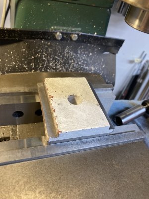

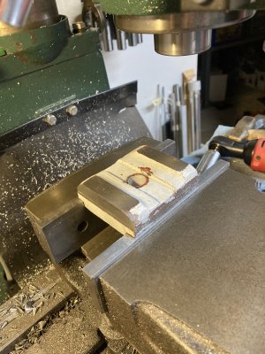

My clamping problem was mostly due to paint/filler on the clamp block (#36 on p.33 of the CX706 parts diagram). Sorry, I don't have a "before" picture. I used my mill to take a skim cut along the two surfaces that clamp up against the lathe bed.
You might ask how I was able to hold this irregular shaped casting. I first set it up with the existing machined surfaces in the vice and used a fly cutter and end mill to make reference surfaces that were flat and parallel to existing clamping surfaces. See following.

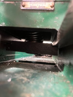

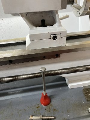

Now to reassemble the tailstock...this can't be hard, right? And it wouldn't be if I had room to slide it on from the end of the bed. Or if I had three to four really small hands. ;)
The clamping block needs to be held up against the bottom of the bed so there is room to start the nut underneath. However, I need to push down on the threaded stud from above because the spring is causing it to lift. Eventually I found that an extra long bolt in my machinist's jack under the clamping block would hold it up while leaving my hands free to get the nut started.
Note that there is a groove or slot cast into the underside of the clamping block. This captures the nut to prevent it from backing off after you get it set. The quick-lock lever is adjusted by this underside nut--a 1/6 turn of the nut is the difference between the lock working decently or being uselessly loose.

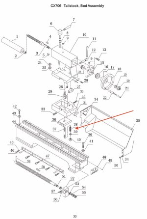

@whydontu If I understand correctly, I think the CX706 already has such a spring. See the following:
It doesn't show very well, but the spring (#38) and washer go on top of the clamping plate ((#36). I wondered if the spring was really necessary but I guess your experience suggests it is?
I do mine either of two ways.
1. I have the room to slide it off the end. I just have to remove a stop pin.
2. There is a big hole in my bed that I can reach through to hold the bottom clamp up with.
On my lathe, you adjust the bolt so that the lever will almost but not quite go over center. This provides the required clamping leverage AND takes up any irregularities in the casting under the ways!
@Susquatch Yup, that is the same on the CX706 except the hole in the lathe bed is not much bigger than my hand. Also, the eccentric that the lever operates provides a really small movement. That's why a 1/6 rotation of the bottom nut is the difference between working or not!

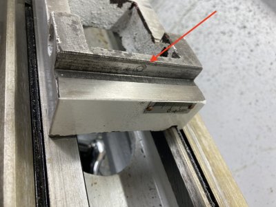

The stud for the bottom nut is 12mm diameter which I believe is 1.75mm pitch or about 0.069 inches per revolution. A 1/6 turn would be about 0.011 inches; 11 thous. The nut bears against a painted and unmachined surface:
As you can see, some of the paint is worn away and the red undercoat is visible. In some areas there was also a Bondo-like filler. That wear was probably a good part of the reason why my quick-clamp lever basically stopped working! The paint layer was would have been quite a few thous thick.
If I need to remove the tailstock again, I think I'm going mill down so the nut bears against clean metal.
