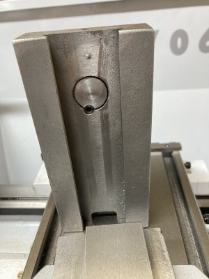

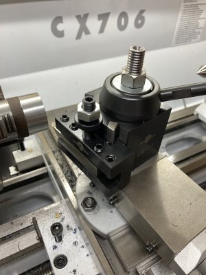

I finally got enough time in the shop to get my QCTP mounted to the new lathe. The following are the relevant parts:

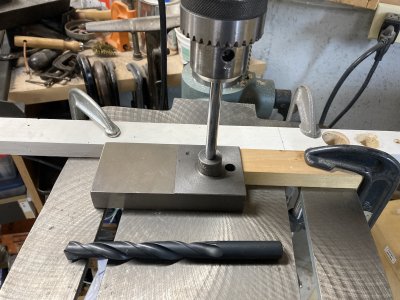

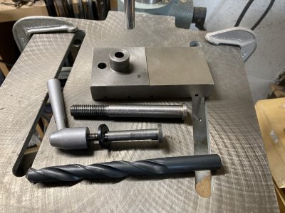

At the top is the compound as it comes from the factory (ie with the boss and 10mm hole). Below that is the new 9/16" mounting 'bolt' that I turned. I had previously disassembled the factory components and carefully measured the head of the supplied bolt. It was a light press fit in the compound and I think it was secured with some LockTite. After a bit of heat, the arbor press convinced it to come out. Note that there is a small index pin (just visible at the bottom of the old part) that prevents it from rotating when you tighten the tool post down..

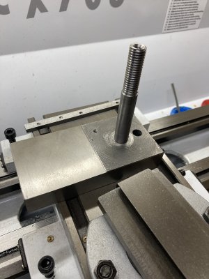

To locate the existing hole, I used a short 10mm rod held in the drill chuck. BTW, I'd planned to do this drilling operation on the mill. But the 9/16" drill (shown above) is too big for the chucks I have on the mill which max out at 1/2". Only my drill press had a big enough chuck.
The actual drilling went easily--cast iron is so sweet! I had expected the hole to be a little oversize bit it was a very snug fit on my new bolt.

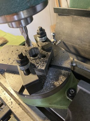

Now, I moved to the mill to remove the boss:
I did plunging cuts to remove the bulk of the boss. Only the final clean up cut was made using the rotary table. This is the first time I've used my little rotary table 'in anger'!
I didn't want to use a large diameter end mill to remove the boss all in one cut since such cutters have a little relief in the centre and might leave a slightly higher surface towards the centre.
All went well and a trial fit of the new parts is shown below:
There was just one more step:
I used LockTite to secure the new bolt in place and then drilled and tapped for a set screw to prevent it from turning or falling out. I used a fine thread set screw since the 'head' of the bolt is only about 0.150" thick and I wanted a few threads to engage. LockTite might have been enough by itself but I figured why not go all the way and provide a mechanical lock between the parts.
Here is the new quick change tool post in place:
Yes, I made the bolt a bit long and then forgot to cut it down before assembling everything with LockTite. I may still do that and modify the handle that came with the 4-way tool post to fit the new bolt.
Seems to work well. You can see that I'm done a couple of test cuts without running into any problems.

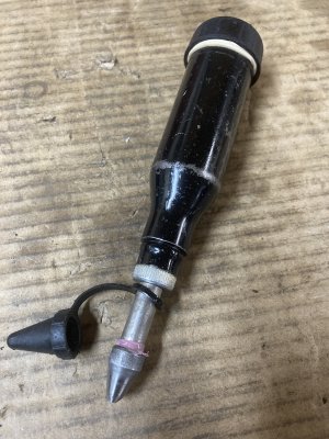

@Canadium posted about a push-style oiler in another thread which reminded me that I had gotten a similar one in an auction box lot. I cleaned it up today and I'm actually very pleased with the way it works with the ball oilers on my CX706.
#26

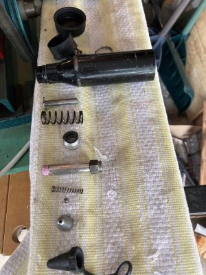

My oiler, a Umeta 43, had been used for grease so I used mineral spirits and brake cleaner to clean up the innards.
The tip of my oiler was too big to fit the oil ports on the lathe. I was surprised to find that the tip is hardened steel. Files wouldn't cut it at all. Eventually, I put a little grinding stone in my Dremel and successfully 'sharpened' the tip to the necessary size. What size is that, you ask? Just about 2.6 mm. I poked a 2.6 mm hole through a scrap of aluminum and used that to test the fit of the tip so I wouldn't have to keep moving it in and out of the lathe chuck.
And here it is:
It delivers a nice size shot of oil with a single push stroke. There is just the slightest amount of weepage were the piston goes into the body of the oiler.
