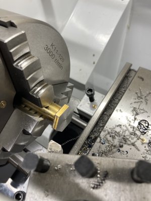

I finally got lathe pretty well cleaned up and lubricated, bolted to the bench and it was time to have at it. The first thing I want to do is get the quick change tool post mounted. I need a bigger, longer bolt for that so I decided to start with 5 inch 9/16-18. The idea is to turn the head down to fit in through the compound like the original:
All I could get was a Grade 8 bolt and the interrupted cut seems to have knocked the cutting edge off my tool bit. And what a pain finding shims to get it close to centre height. Now I need to dig out the grinder and refresh the cutter. Then finish reducing the head thickness and turn it to the right diameter.
Still...CHIPS!!
