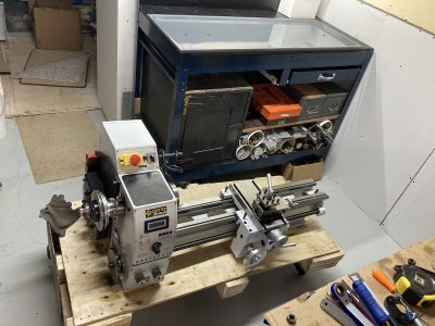

I planned to use a 2-wheel cart to move the machine to the basement. In hindsight, renting a proper appliance dolly would have made it slightly easier. I decided to leave the machine bolted to the base of the crate for the move since it was otherwise going to be very difficult to strap it to the cart. In any event, my son, my daughter and I got it down the stairs (including a right-angle turn) and into the basement. Only my son got his fingers pinched when we lifted it off the crate base and onto the bench*. ;)
Not that I also took the backsplash and gear train covers off for the move. The gear train cover is just held in place by a couple of small studs--no where near strong enough to be a lifting point. I was concerned the backsplash was going to make it more difficult to maneuver down the stairs and again it is not strong enough to be a lifting point.

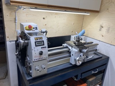

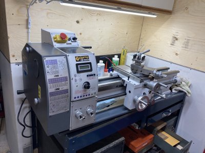

I've spent a fair bit of time cleaning and lubing my new toys. Disassembled both chucks; the 4-jaw had a large metal chip fouling one of the screws. In the picture below, you can see some of the grit and dirty oil that was on the machine. I disassembled, cleaned and lubed both the compound and the cross slide. After adjusting the gibs, I think the operation is pretty smooth.
I wanted to take the gears off the banjo to clean and lube but I've put that off for now. There was a Blondihacks video where she noted that the gears on her Precision Matthews lathe were and extremely tight to the studs to begin with. I believe she used a reamer to ensure the hole in each gear was a good fit. That would require a 14mm reamer (ideally spiral) which I don't have. May need to buy one.
I'm also debating about changing the oil in the headstock and apron. Now or wait until I've used it for a few months?
The next step is to retrieve the QCTP I ordered. I had it delivered to a service just across the border in New York. This will be my first crossing since the pandemic started. Fingers crossed that it goes OK. BTW, I'm 90% certain that I'll have to modify the compound slightly to fit the QCTP. The tool post that comes with it sits on a boss that sticks up too high. Should be no big deal to mill it down.
I also want to try taking some measurements. I've ordered a test bar from India and the tracking says it will be here in 3 days.
Or course, I've played with the controls a bit. All the basic functions seem to work OK. The two knobs on the front (left-right travel and A-B-C feed speeds) don't give good feedback that they're engaged. Also, the lever is quite stiff going from longitudinal to crossfeed modes. I know you don't want to do by accident but it seems pretty sticky.

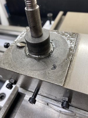

Pictured below is my Precision Matthews AXA QCTP sitting beside the 4-way tool post that came with the lathe.
You know, you do the measurements and check what other people bought for the same lathe but it just reassuring to see that they are roughly the same size sitting side-by-side!
My current plan--subject to change--is to mount my parting/cutoff tool in the 4-way. I think it should be just slightly more rigid than the QCTP and that a smaller lathe like this needs all the help it can get in that respect. I might put the scissor knurler in the 4-way as well. More because it is a pretty low-use tool.
BTW, I note that the screw for the 4-way is much lighter than one for the AXA QCTP. The 4-way has an 8mm threaded portion while the QCTP uses a 9/16 inch screw (need to verify). That's about 14.3 mm. My initial thought is to modify things such that I can use the same screw for either tool holder. I can open up the hole through the 4-way to the same diameter as the QCTP. I think I'm going to have to make some slight modifications to the compound to capture the end of the hold down. Need to do some 'ciphering!
Craig I had the same situation with my qctp in the end I put the bottom of the tool post in the lathe and turned a boss on it to retain the most threads, I opened up the hole in the compound to match the boss and I also milled out more area of the bottom of the compound to allow more meat on that part too. I can take some pictures after work if you want after work.
