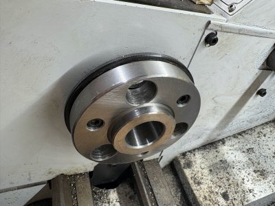

One of my 'maybe-one-day' plans has been to add a collet chuck to this lathe. Finding the correct backing plate to adapt from the spindle nose to the chuck has stymied me. Previously.

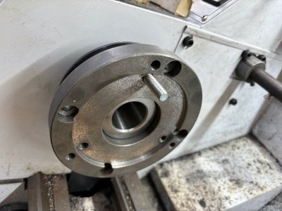

BusyBee, in their Christmas in July sale, was offering an adaptor plate for the CX615 (lathe/mill combo machine). It turns out it also fits my CX706 (10 X 22). Here are 2 views of it on my lathe:
I found that the threaded holes for the mounting studs are different. The CX706 chucks come with M10 threaded studs but the pre-drilled holes in this adaptor plate are M8. I've use a simple M8 bolt as a mock-up above. The adaptor plate does not come with any mounting studs at all.
To work around this, the adaptor plate could be drilled out and re-threaded for M10. Or, I could make a custom set of studs with M8 on one side and M10 on the other. I think I'll go the latter direction since I'm going to need studs anyway.

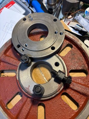

For comparison, the picture below is the CX615 plate compared to the CX706 face plate.

I paid $127 plus HST for the plate but the sale ends tomorrow (August 3, 2025) when it will go back up by over $30. I probably could have gotten a slice of Durabar for maybe a little less money. It would not have been easy to handle on a machine of my size.
Now I can start looking for a decent collet chuck!

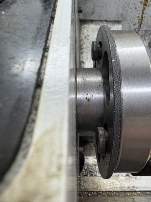

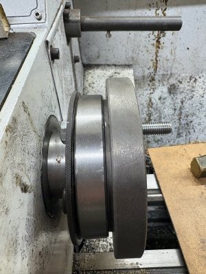

(Also attached a couple of picture of the bare spindle nose for those curious.)

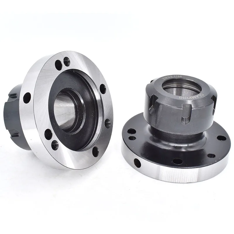

Nice work. I opted for an aliexpress chuck and a amazon D1-4 backing plate.
I have if memory serves me right - 0.005mm TIR. Or was that .001mm....
Here is the link for the collet chuck. quality is top notch for 70$ shipped !
