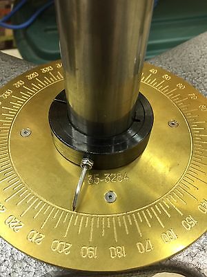

Possibly flogging a dead horse, but take a look at the position indicator. Pin, not a scribed line. I suspect this would be much easier to align with whatever degree plate or degree tape you implement.

I found what is called an R-Axis Table on the web.
The biggest is 125mm diameter and comes with, the graduations already marked. 125mm gives me 5mm bigger than my compound plinth. That would work fine. It just costs too much. Cheapest I found so far is $84 plus $40 shipping on Ali - YUK! But it is a start.
All I need is the table itself. But it does come with a vernier already setup for the 125mm table marks.
