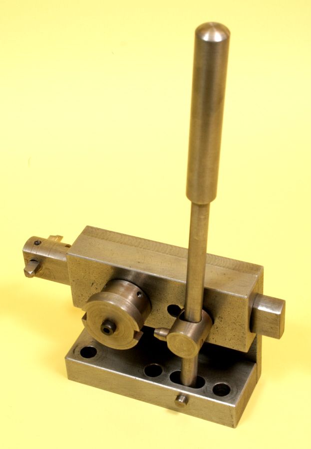

@Tom O - Is the line maker you're thinking of by Harold Hall? I have one started but it's moved into the "roundtuit" list. There's a video of it in action on the page as well.
Yes that’s the one I haven’t finished mine yet either but here it is I even have the 1/4” square broach for it. It’s the dividing head book by Harold hall.

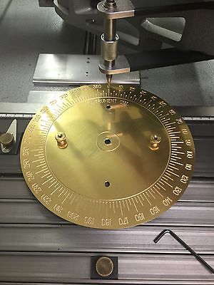

My New Hermes ITX-L engraver (look it up) came with an indexer to engrave cylinders (bowls, mugs, etc). I think I can index fine enough to do degree markings, and might be able to do the numbers as well. Seeing as I’m learning how to use the engraver, this could be an interesting practice piece.

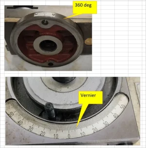

I think you could increase the accuracy of compound with 3 improvements
1. replace the pointer with a full 360-deg increment indicator as a band/sleeve over the circular base segment
2. replace the arc window degree indicator with a vernier scale to yield more exact even degrees & fractional degrees
3. add a magnifying bit of lens to enlarge the engravings of both
- either 1 or 2 should be adjustable/lockable to a less frequent compound set against using dial to some standard
1. replace the pointer with a full 360-deg increment indicator as a band/sleeve over the circular base segment.
This is my current direction - the plan I like best. In this scenario, I can correct the current error plus get a 360 degree readout plus add a vernier refinement someplace off the main scale.
YES - See above.
Although I am virtually blind in one eye, my other eye has good resolution - good enough to read a vernier quite reliably!
