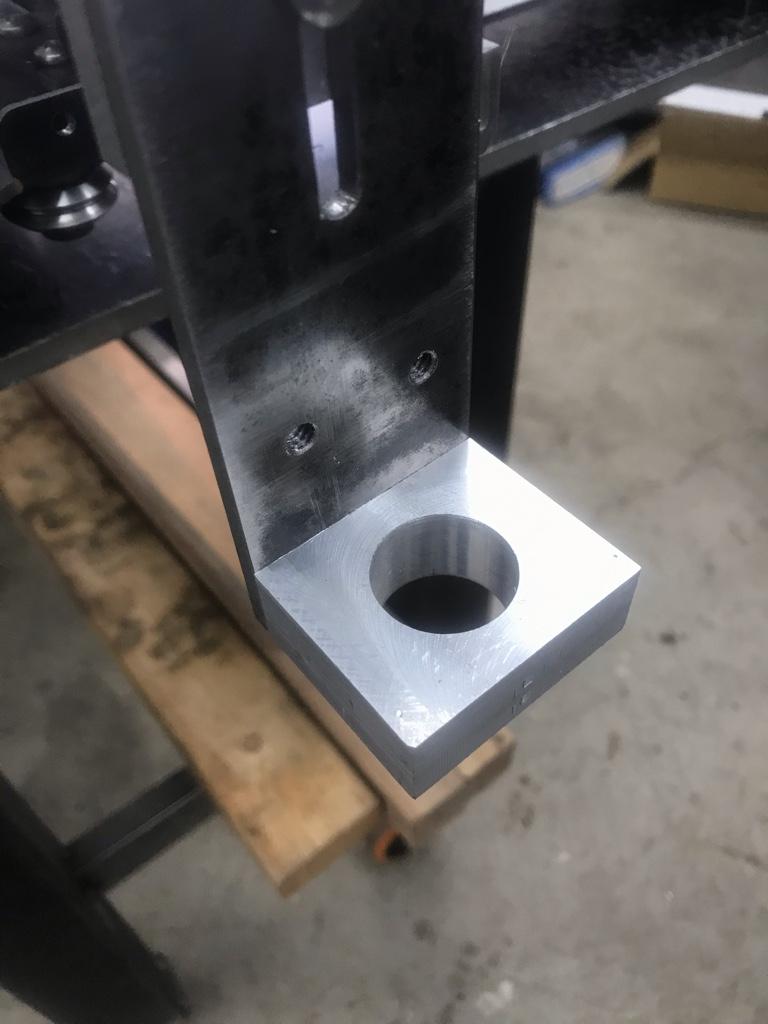

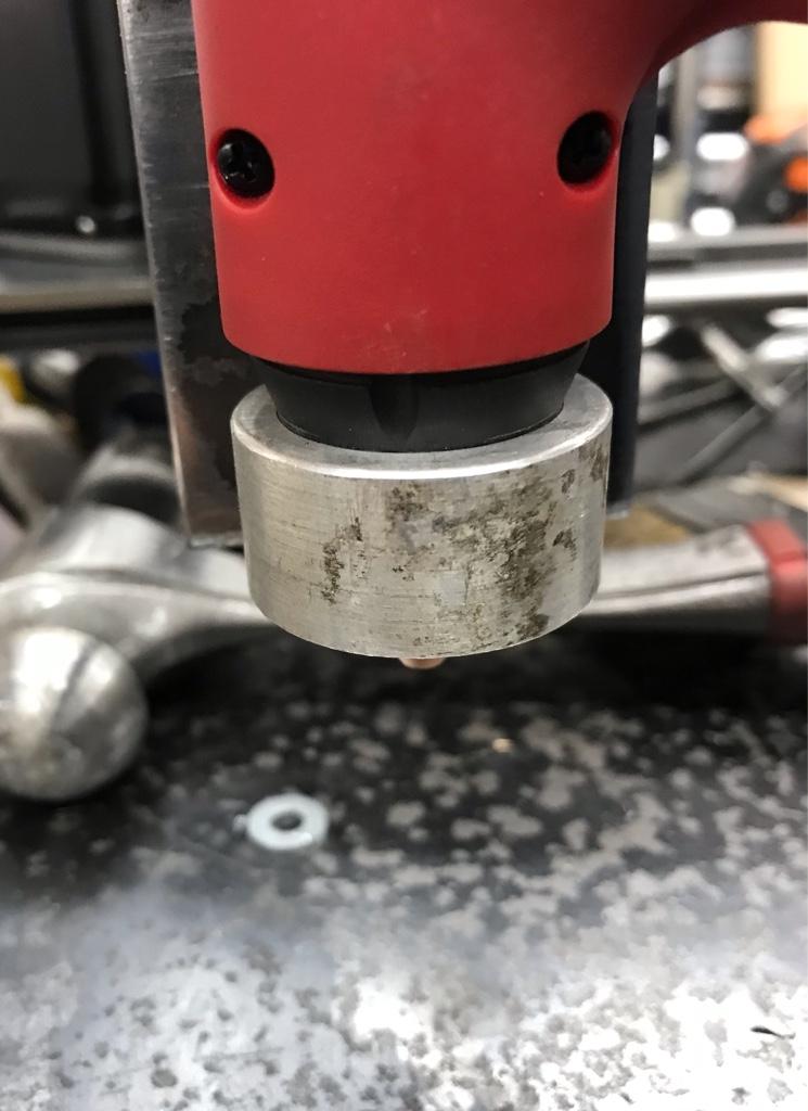

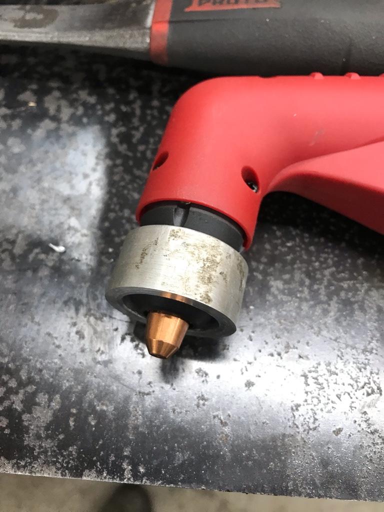

Bit more progress today.
Made the bracket that mounts the torch holder bracket.
Made a start on the actual ring to hold the torch.
Had an aluminum piece with a hole almost the same dimension as the torch head. Bored it out on the lathe and parted it off at the right length.
Now I just need to figure out how to attach the ring to the bracket.
I might TIG a rectangular piece to the side of the ring, drill and tap it for a cap screw through the upright bracket.

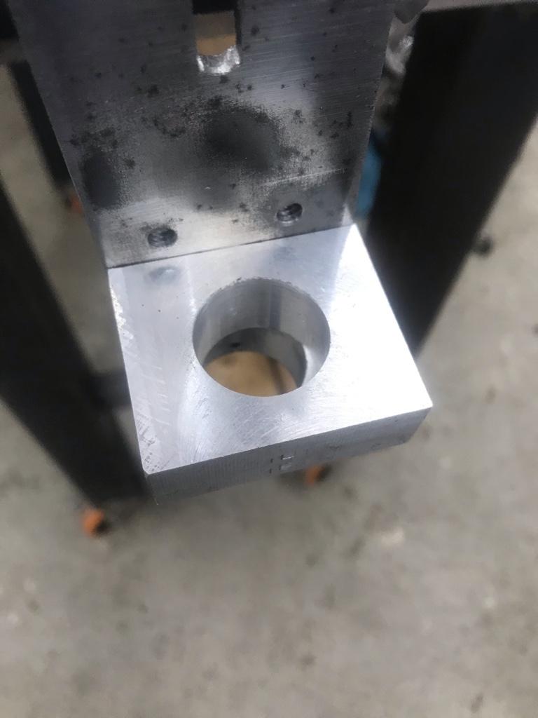

Now I just need to figure out how to attach it to the bracket.
LOL..... a bracket for a bracket, an actual ring, and a piece with a hole in it? Sorry couldn't help it:p
What I have liked for attaching circular objects to flat surfaces is to drill a larger hole in the outer portion of the ring and the right size hole in the side of the ring that mounts to the bracket. You can then use the screw drive through the outer ring larger hole? ...or weld it as you say....;)
I like this idea too.
I have a roll pin I could use to stop the ring from rotating about the screw.
Or two screws? top and bottom? Don't know what stresses will be on it as it drags the cable around but you could put a strain relief on the arm. I plan on suspending the cable above the table. I saw that DAC had his dragging over the edge but anyone that tig welds knows the cable dragging over something messes up the welds sometimes...or is that just me...? :oops: That dragging stress will wiggle the fasteners loose eventually. Welding might be the best solution for long term reliability. Just my 2 cents

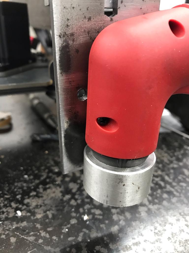

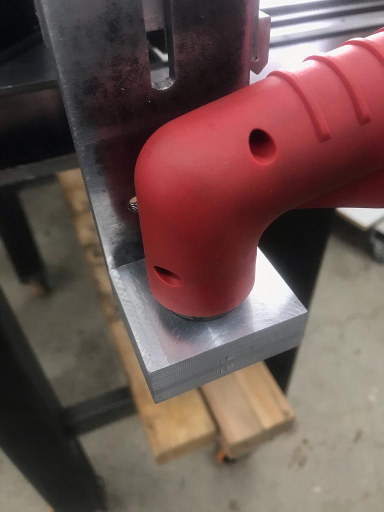

Today’s progress.
Took a couple of iterations to get here.

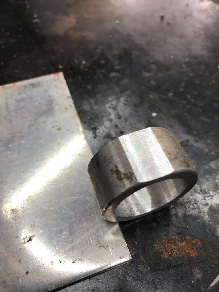

Milled a flat on the torch collar so it would stay in one place while I messed around with locating it.
See the hole peeking out from behind the torch? That’s a 1/4-20 hole that I made to mount an aluminum plate which had the collar attached.
Turned out the screw heads interfered with the torch body so that version was scrapped.
Second iteration ended up by drilling the steel plate and directly attaching the collar. Should have started with that in the first place.

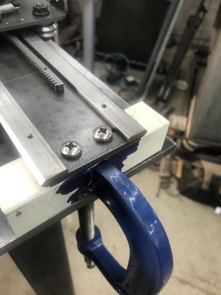

I have also been thinking ahead to how to hold the thing down to the table and made a happy discovery.
The X-axis is exactly 24” wide, the same as my welding table.
So it fits perfectly across the width.
I think I’ll swap out end plates for a couple of pieces of square tube. I’ll cut out one side and mount the with the open side facing out so I can clamp it down.

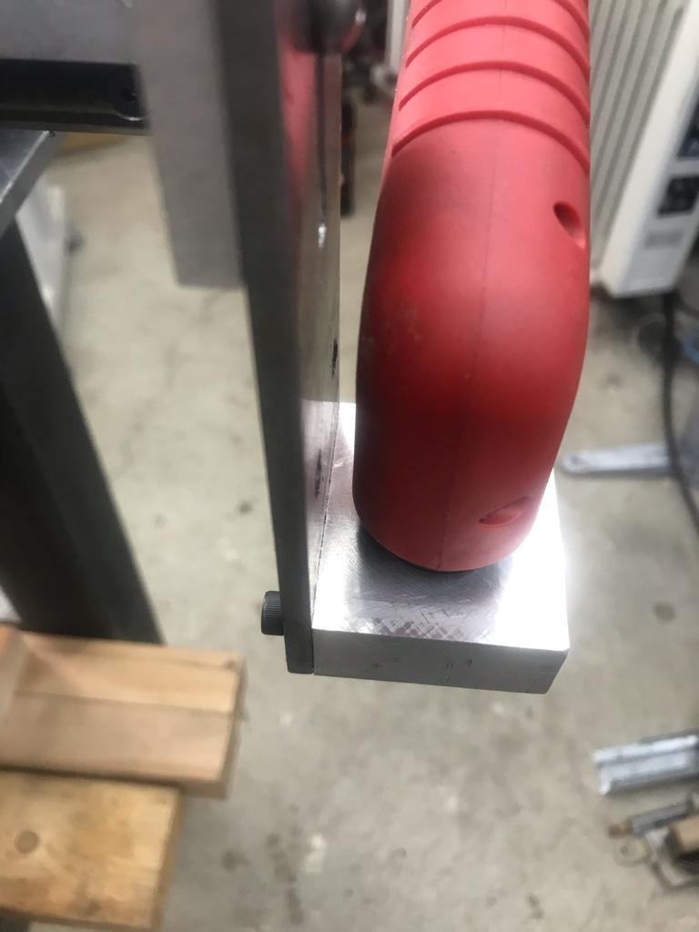

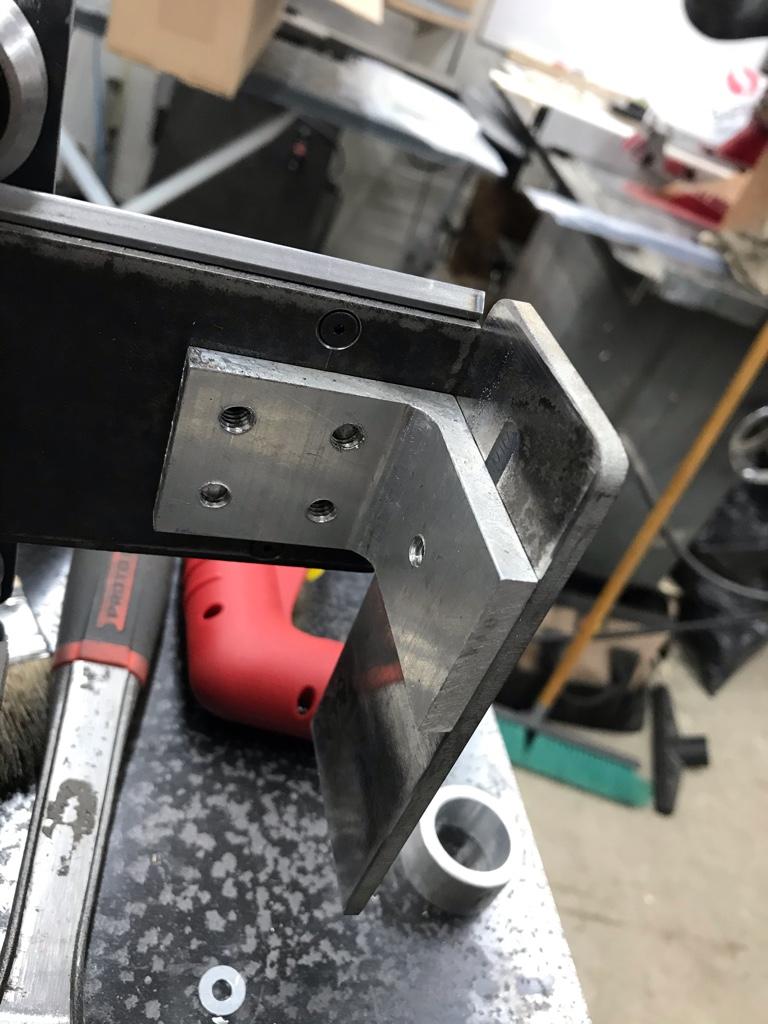

A bit of work last night to make a better torch holder.
2x2 block, bored to 1” in the 4-jaw. I plan to cut it vertically, parallel to plate so it can clamp the torch head.
Also need to mark and drill to attach it to the vertical plate and mill recesses for 10-24 SHCS to hold the two halves together.
I might also break out the rotary table and radius the front [emoji1]
Ignore those two holes. They are from a prior attempt to make a mount. [emoji23]
Torch holder is done.

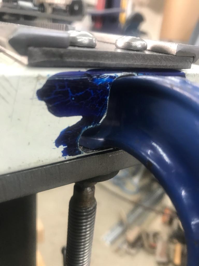

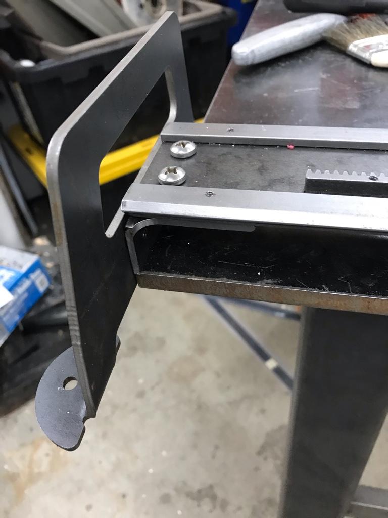

Had a rethink on how to attach it to the table.
Some 1x tube with openings cut for a C clamp.
I don't see any smoking holes in metal:(
Well, alive in the sense that I made a CAD drawing, converted it to G-code, sent it to the controller and the steppers moved the right amounts in the right directions.
Next I have to build an enclosure for the electronics and fab up the actual cutting table.
