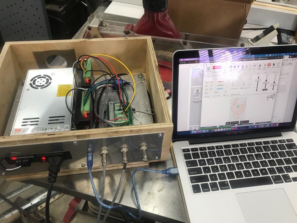

What software are you using on your Mac? And how do you handle backlash? Nice project!
Thanks John, it was fun and a real learning experience.
I'm running an Arduino loaded with GRBL as the controller. I started out using Universal Gcode Sender (UGS) to drive the controller but I found it pretty funky to use. Calibrating the axis with UGS was an exercise in frustration. I switched to OpenBuildsControl and it's a pleasure to use. Calibration was dead easy and turned out to be quite accurate.
There's almost no backlash as the pinion gears are pulled into the gear rack by springs.

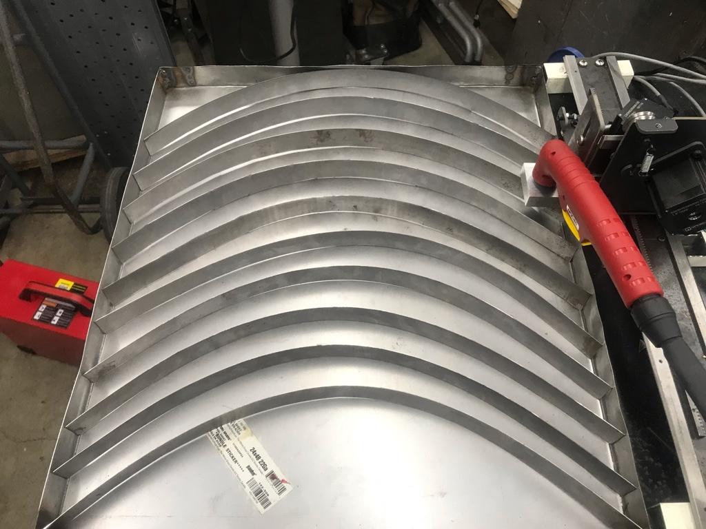

If I get some time today I’ll cut the slats for the water table.
Have some extra connectors coming so that I can still use the torch as a handheld cutter.
Used my metal shear to cut strips for the water tray. Not perfect as I need to add a couple at the near end.
I was going to use the plasma cutter to cut them but the torch switch is wired to the black box.
I have some new connectors coming so I can also use it as a handheld torch.
