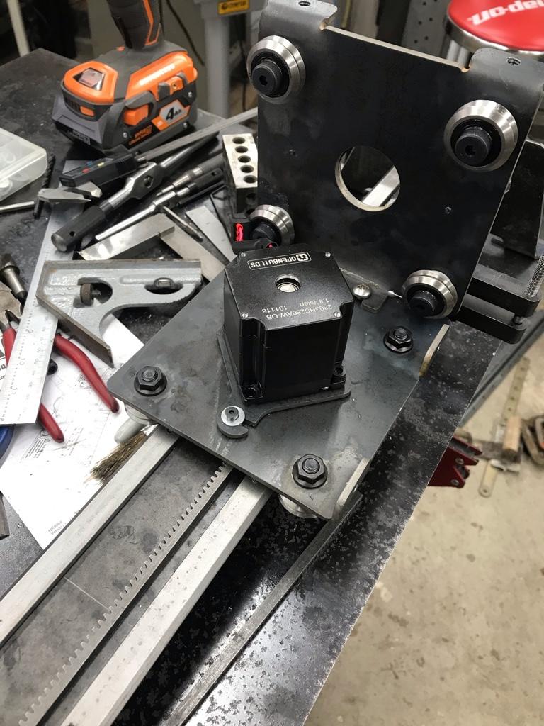

Legs on and laying out the gear rack.
Stepper motor mounted.

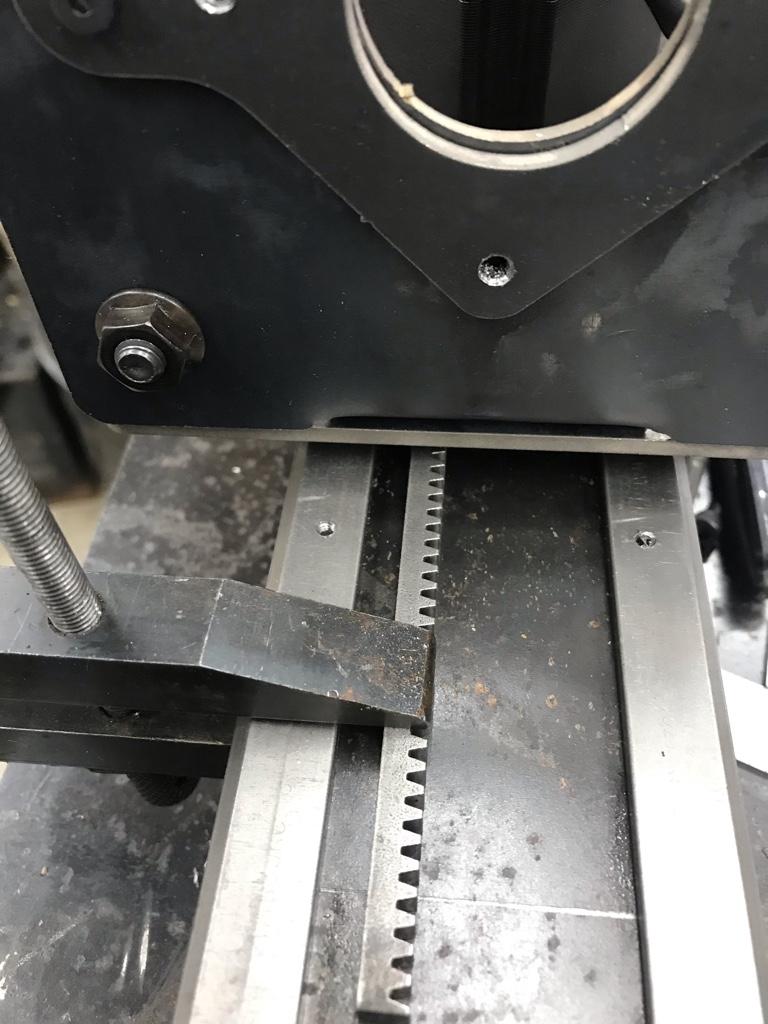

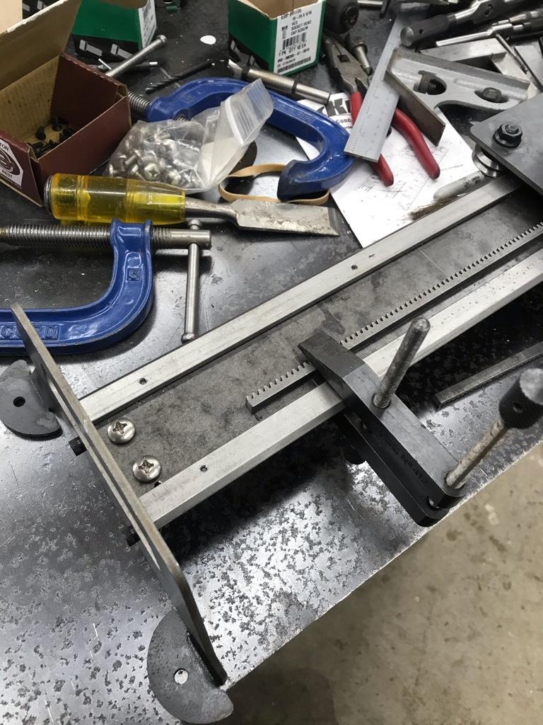

Last update I was laying out the gear rack.
Today I drilled and tapped it, counter sunk the holes for the flat head mounting screws.
I had been fretting over how to maintain the .269" spacing from the V-rail. I measured the height of the gear rack at .25" so I decided to use the cut off pieces as spacers. The stepper motor mounts have provisions to adjust the gear mesh so the .019" difference will be made up that way.
The rack is pretty narrow on its face and I was drill and tapping for 6-32 screws. I could only place holes under the gear peaks other wise there wasn't enough material. Needless to say I had my magnifiers on for this.
This is the back of the Y-axis. The top and bottom screws are securing the v-rail. the single screw is for the gear rack.

Did a trial fit to make sure everything was copacetic.
Looking down into the Y-axis at the pinion and rack. Definitely a tight fit!

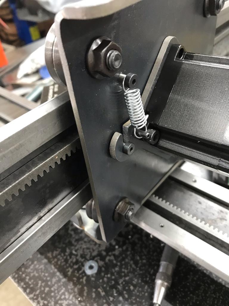

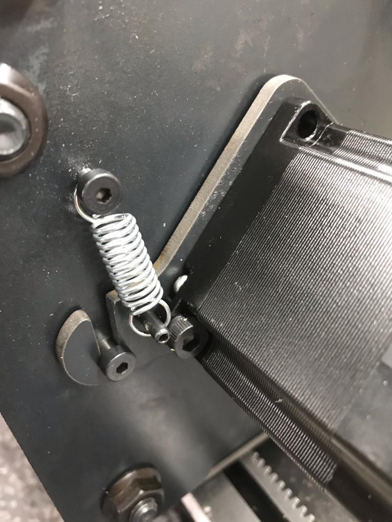

As @extropic on the Hobby-machinist forum sagely noticed, having the Y-axis gear rack oriented teeth facing up was inviting a build up of crud in the gears.

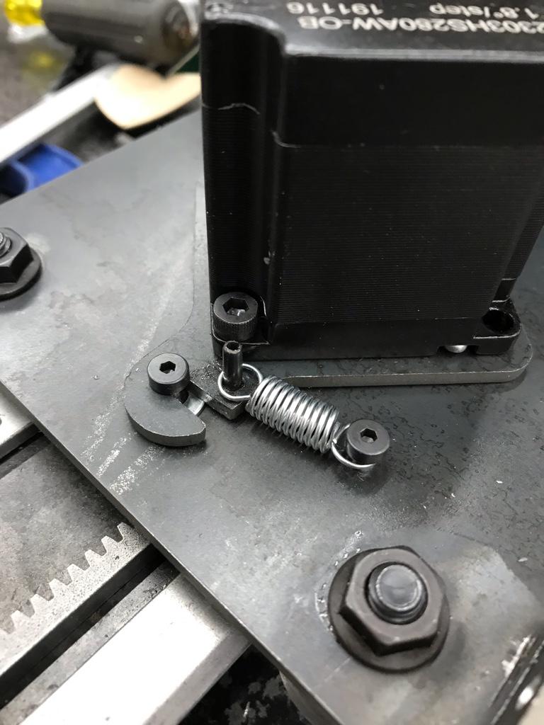

So I flipped the axis end for end and added a tensioning spring to maintain good gear mesh.
Though looking at the photo I should probably flip the motor mount so the slot faces down.
I also milled .05” off the motor shafts as they were too long and rubbed on the axis plates.
I liked how the tension spring took away the gear lash so I added one to the X-axis too.
@ShawnR when you build one (see what I did there? :p ) the holes in the motor mount plates may be too small to accommodate the motors which have a small boss on the mounting face.
I solved this by using my Noga deburring tool to create a small chamfer. A few turns around the opening and the motor fit like a glove.
