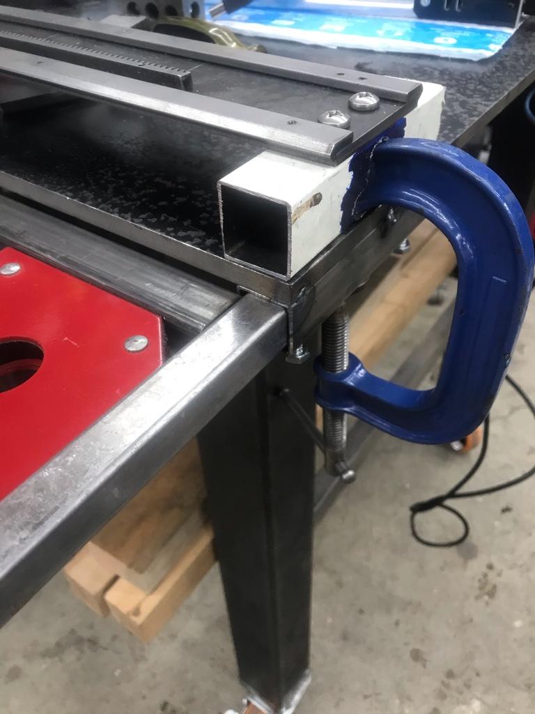

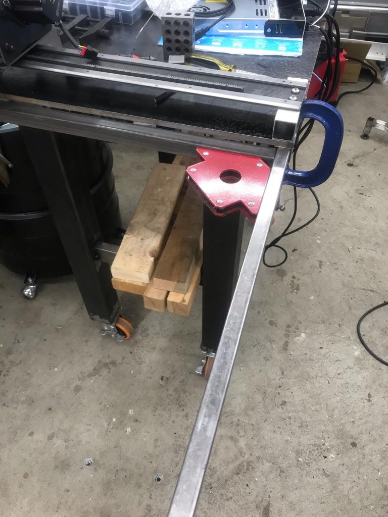

Built the removable table. Used 1” square tube for the receivers under the table.
3/4” square table arms with 1” cross members.

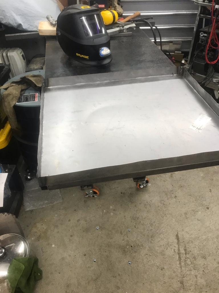

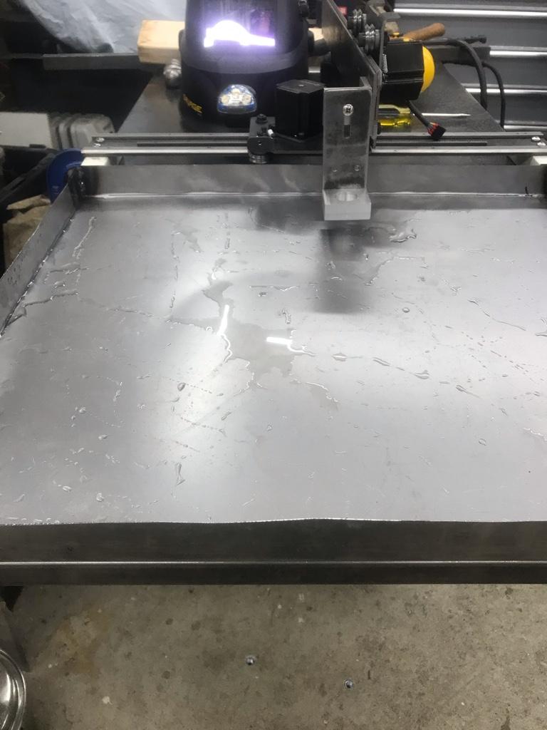

Made a water tray out of 22ga sheet metal. Folded and MIG welded the corners. It’s watertight shocking no one more than me.

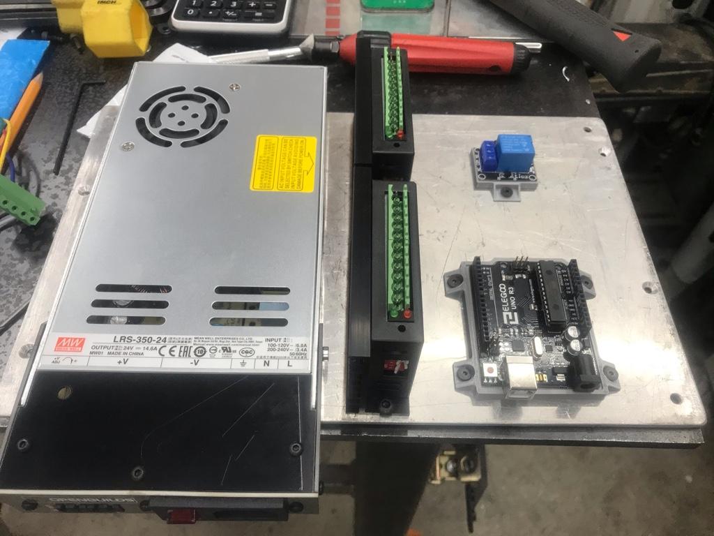

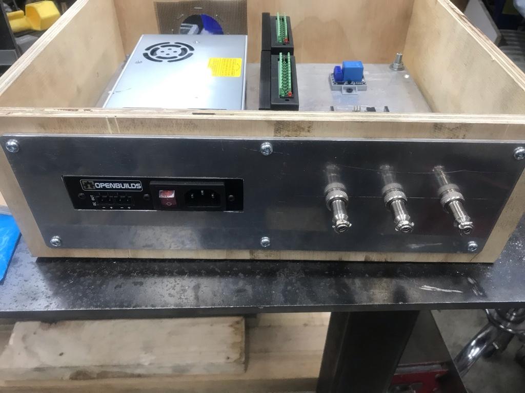

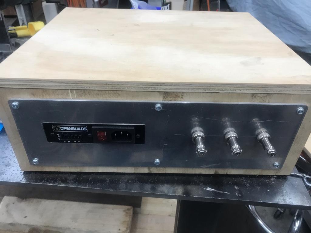

Lots of progress today.

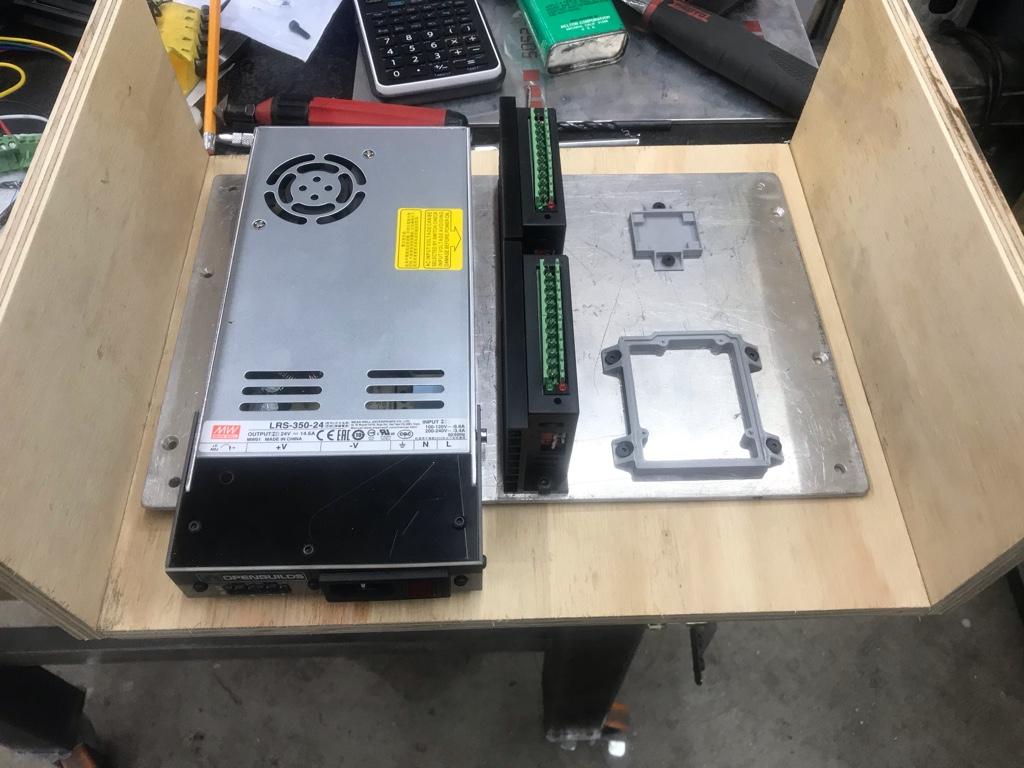

Built the electronics enclosure.
Thought about buying a readymade enclosure but I couldn’t find one with the right dimensions.
So went into my lumber pile found some sanded 1/2” plywood.
Used a piece of 1/8” aluminum sheet to mount all the bits and cut another piece to make a panel to mount the aircraft connectors and 24v power supply.
Once I get all the wiring done I’ll paint it.
Black of course because the magic happens inside the black box :D
Left to right is power supply, X, Y axis and torch control. Still need to do the internal wiring and then make the wiring to go from the box to the motors and torch.

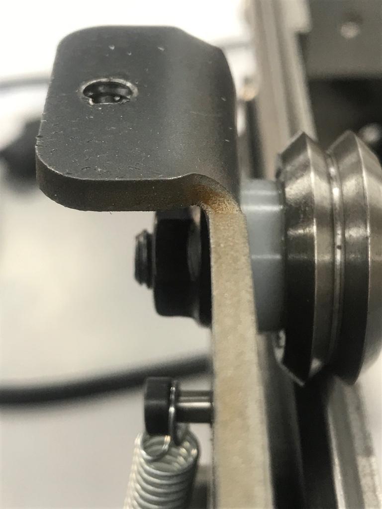

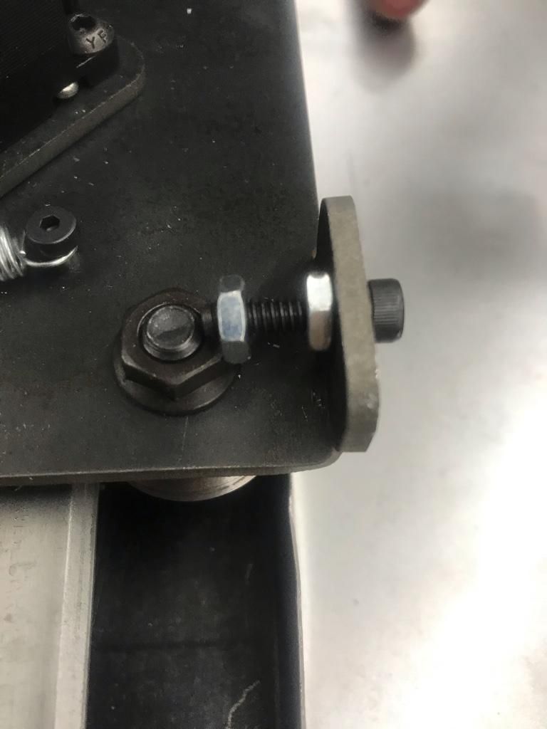

And I sorted out the v-wheel tension screws.
DavidR8
Scrap maker
Almost like you knew what you are doing ;)
Do you think a lock nut will be needed to keep the tensioning nut from backing off?
Yes, I think so. There’s enough room for them.
The top ones are a bit of a different story as the hole is further outboard of the nut.
I’m not really keen on rebending the tabs or cutting them off and replacing them.
I may TIG up the holes and redrill them closer in.

YotaBota
Mike
If you redrill is there room for a longer bolt and have the lock nut on the outside of the tab using the end of the bolt to tension the v-wheel. This would mean one bolt and one nut, saves on hardware.
