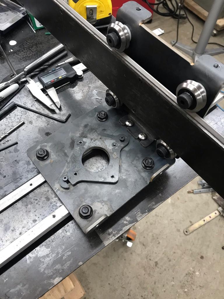

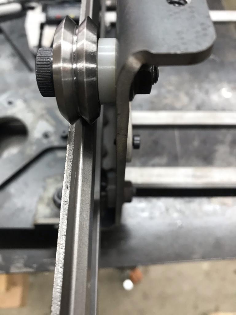

More progress today.
Built the rails.
Lots of drilling, countersinking and tapping. Ten fasteners in each rail.
Lots of learning today too.
On the bottom rail I miscalculated the width of the flat part of the v-rail and drilled the holes in the flat stock too far inboard which meant the holes were to close to edge of the v-rail. All ten of the holes... :(
And I thought I could accurately transfer the hole locations from the flat stock to the v-rails. Not so much...Doh!
For the second rail I carefully measured the width of the v-rail in decimal inches, divided that figure in half and then scribed marks for the hole locations. I also clamped the flat stock and v-rail together to drill the holes.
Looking good what is the weight of the top sliding arm? I’m just wondering what the weight would be fully extended.
Well that’s not much I was expecting a few pounds at least. How does the rigidity look any noticeable flex?
If I bear down it will flex but there’s very little weight on it in use.
