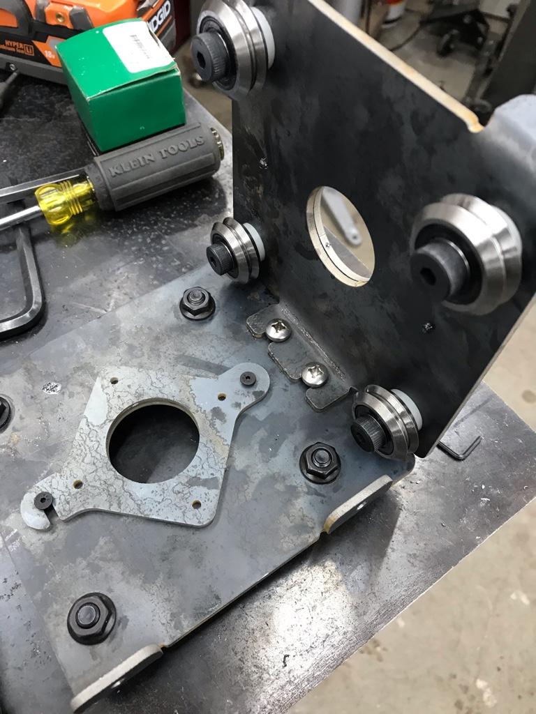

Ok I didn’t see that one, I did get the plans from him to pick through and am looking to see what can be improved like 1/2“ for the legs and a t slot for the adjustments of the v rollers.
There is this adjustment for the v-rollers.

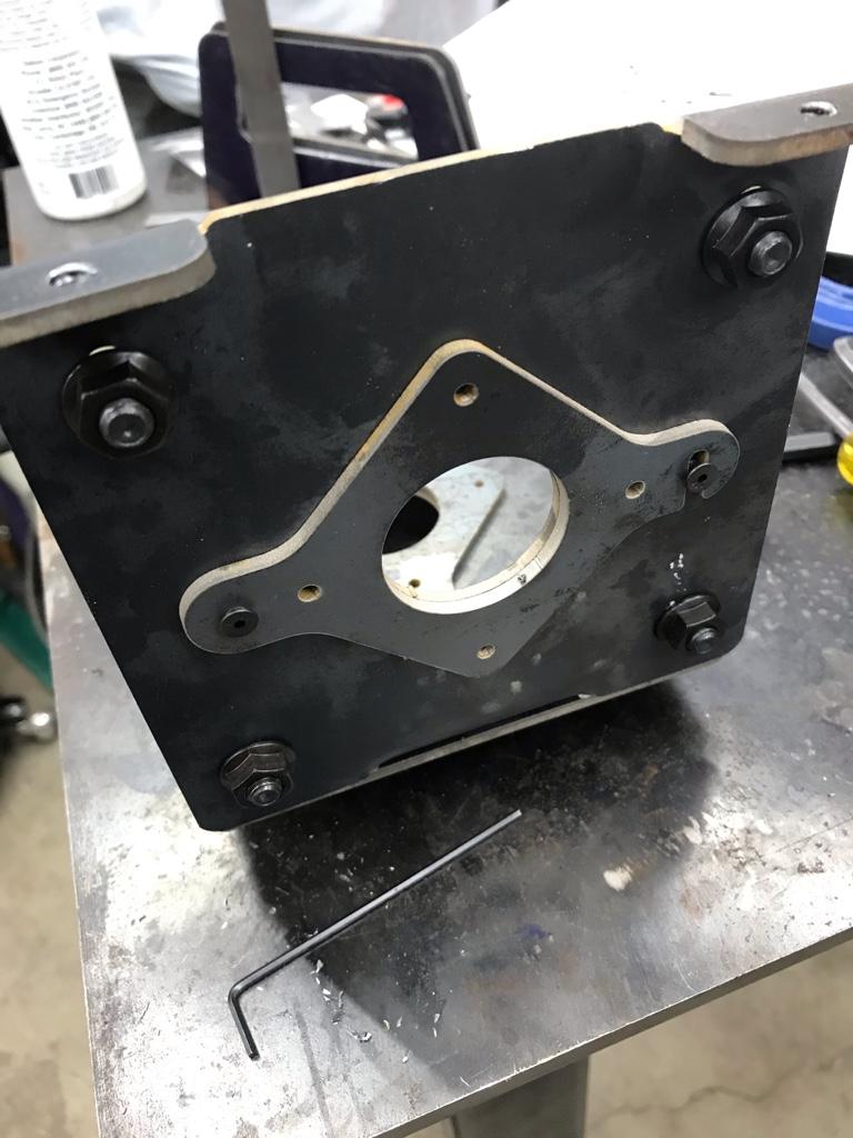

Made some progress today.
Did the rough assembly of the X and Y carriages.
I may have to make some changes because the mounting flange on the V-rail I have is wider than the spec’ed V-rail from McMaster-Carr which pushes the gear rack too far inboard.
Or I might just order the spec’ed V-rail

I mocked up the rails tonight because well I'm like a kid on Christmas Eve. :D
I realized that I couldn't use the other rails because they are about a 1/16" thick so the end of the motor shaft and pinion gear would have been rubbing on the plate holding the rails. The new rails are 1/4" thick which is necessary for there to be sufficient clearance.
