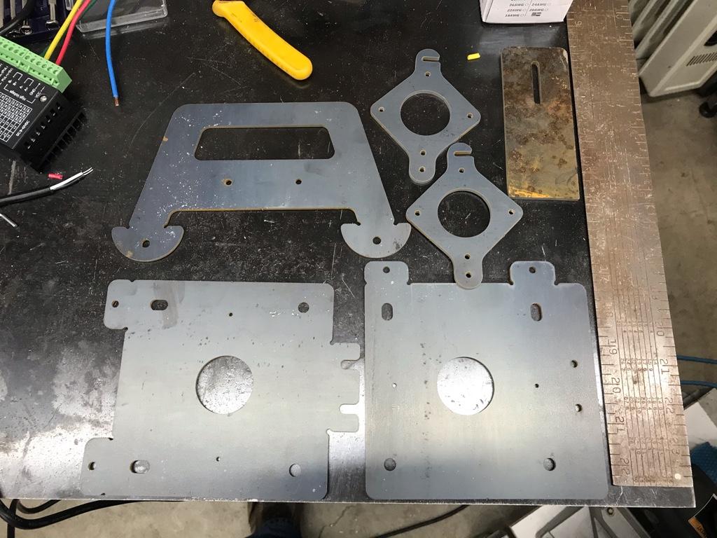

Picked up the steel today.
Slight hiccup in that I didn’t communicate the cut list clearly so they only made a single of a piece that I need a pair of.
I’ll need to make a duplicate of the piece by the yellow handle.
The two diamond shaped pieces are the stepper mounts, the big square’ish pieces are the X and Y axis mounts.
Not shown are the two 24”x 2.5” arms.

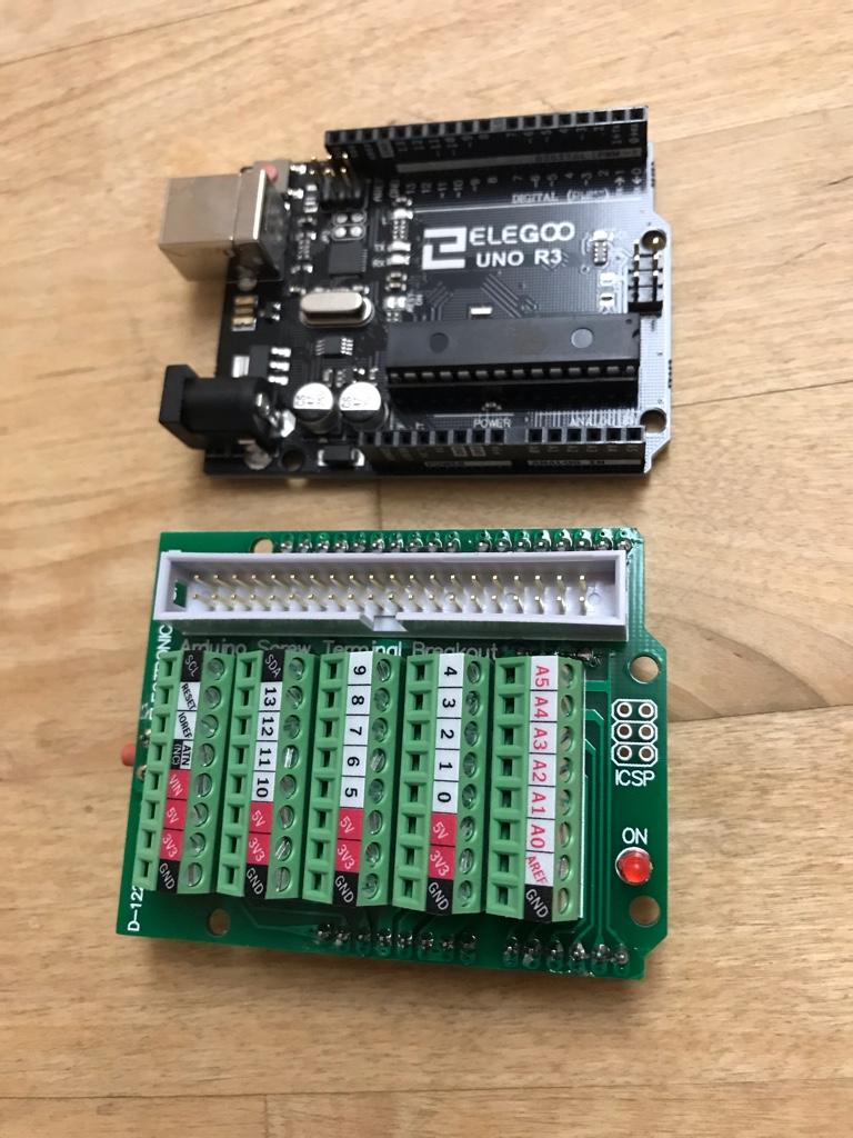

Breakout board for the Arduino Uno board showed up today.
With any luck I can get the electronics wired up and see if they work [emoji16]
Oh and I printed a mount for the board on my new 3D printer [emoji16]

Final price David?

Whoops I said I was going to post that didn't I @Janger
Steel and cutting was $100 plus tax, $112 all in.
There's two 24" x 2.5" pieces of 3/16" as well that aren't shown because well they don't fit in the picture. :D

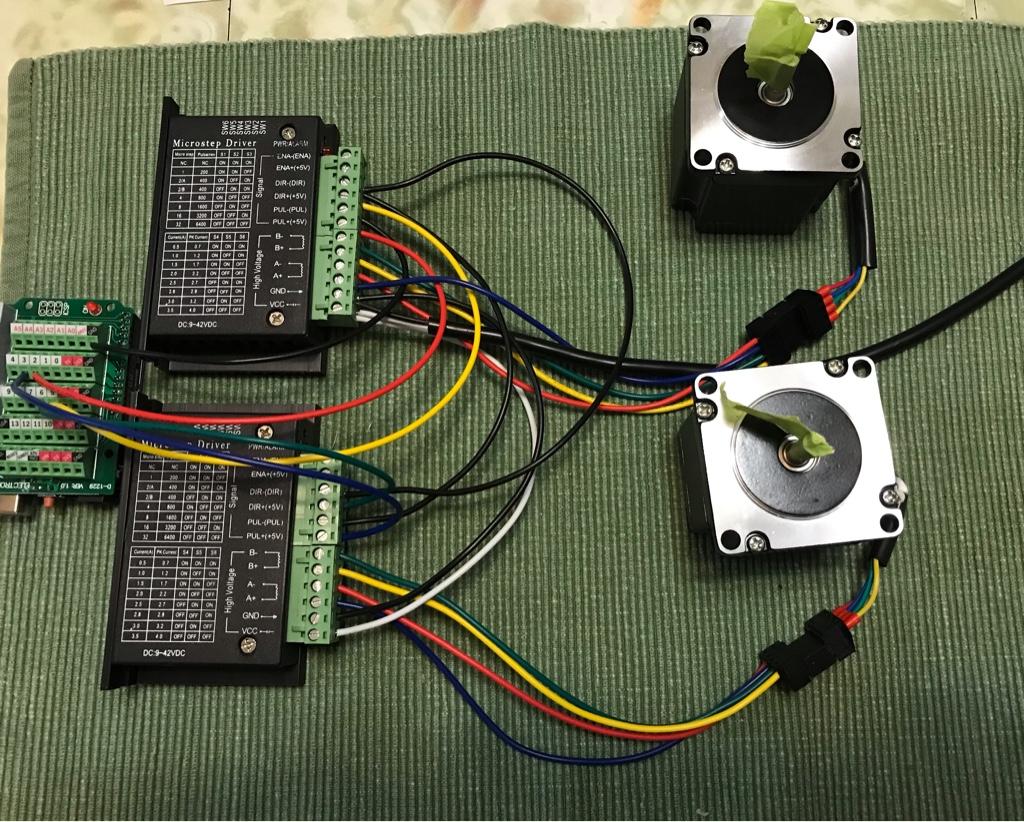

Well I had partial success tonight. Got the X-axis working but the Y-axis is not responding.
Not quite sure what's wrong yet...
DavidR8
Scrap maker
Got it working!
Still need to set the steps correctly but the steppers are responding appropriately :D
HUGE win for this CNC electronics (heck all electronics!) newbie!

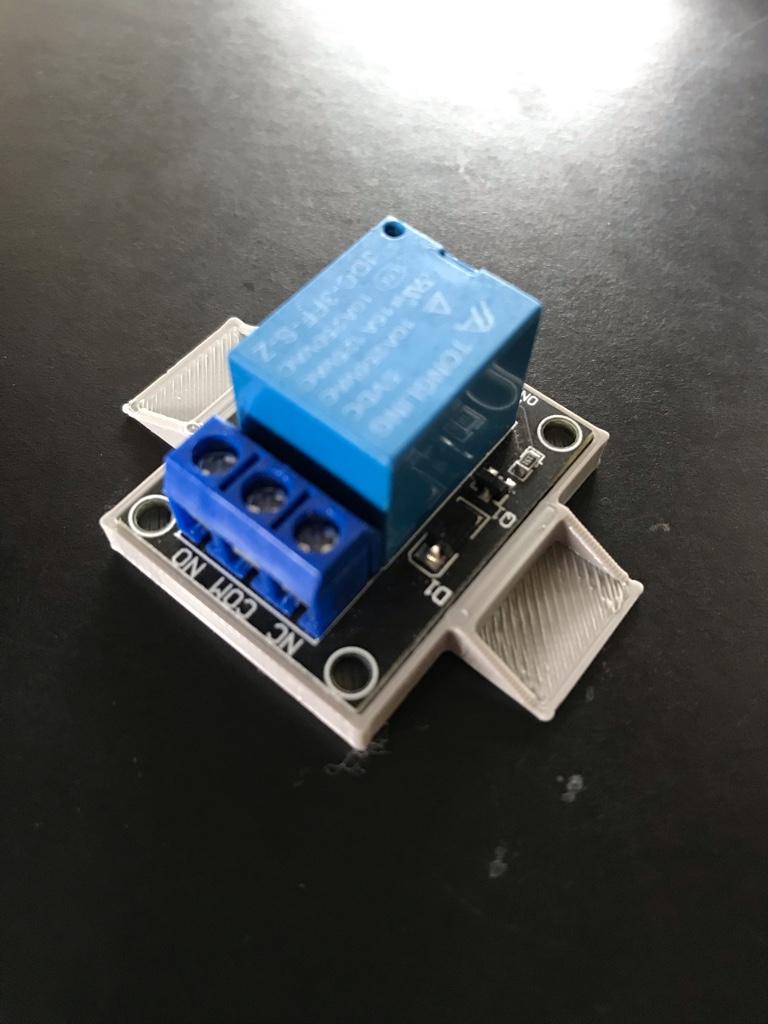

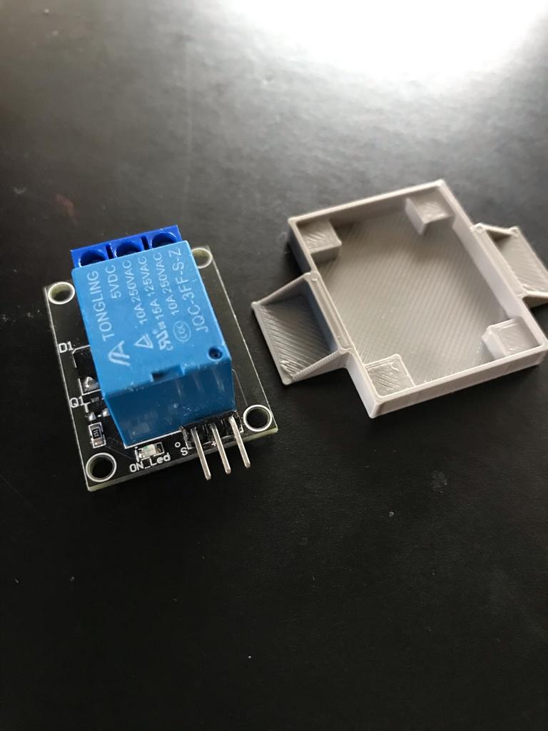

Small progress today.
Designed and printed a base for the 5v relay that will control the plasma torch.
