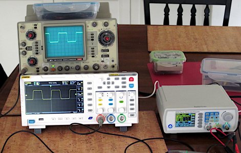

The new oscilloscope showed up today and so far I'm impressed. I compared it to my Iwatsu SS-5706A and they both read very close.
The signal generator I used has a tough time with a square wave once over 2 MHZ. The iwatsu probably cost as much as a new car in the mid 1980's.

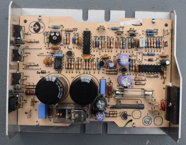

I got this 15A DC motor speed controller from Princess Auto today for $3. I was wondering if I could use it to control a DC motor on my South Bend lathe? The current motor is about 1HP and I would want about the same power. Is there a particular variant of DC motor I would need to use? The board has pins for external connections labelled L1, L2/P1,P2,P3/T1, T2/ and M+,M-. I'm guessing these are for a switch, a potentiometer, a motor, and power but not sure which is which(I'm guessing M+- is power, P1,P2,P3 is potentiometer). Any thoughts?
I'm going to guess L1, L2 are line 1 and 2 input. M+ and M- are the DC motor and P1..P3 are the potentiometer for speed control.
I second @jcdammeyer 's guesses.
L is almost always Line in.
M is almost always Motor.
P can be many things but a voltage dividing potentiometer makes the most sense since there are 3 connections and most pots have three connections.
Lol. I bought a couple of them today as well and just sat down to ask the same questions.
T1 and T2 is a bit odd for an MC60 controller. These terminals might be for a thermal cutout switch inside the motor. If nothing happens when you wire up your pot/motor/line, check for line voltage across T1/T2.
Other thing to watch for is many of these have a zero-start function, so the pot has to be zero before the motor will start. Think treadmill - we don’t want Gramma to be launched across the room if the treadmill starts at 90mph.
The "T" connections may be for "tach" input. That leads to the question what are they doing with it?
