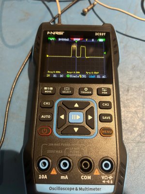

So I recently received one of these bargain basket $101 shipped Fnirsi 2C53T oscilloscope/meters.
+The GUI could be better, however it is usable.
+ Battery powered, so really convenient for field type measurements
+ Advertised 250MS/s sample rate
- I wouldn't trust the CAT ratings
- bandwidth is limited as expected, even at 1/10 of sample rate the displayed signal is highly attenuated, so don't expect to catch anything fast
I have not evaluated in detail, however I did try it with a couple of 200ns bursts just to see if it would capture a half quick pulse and it did, see below.
At the advertised 50MHz limit the displayed signal is okay, you just can't believe the amplitude (at all)
Faster than that is a crap shoot. I tried 1GHz just for giggles and nada as expected.
Overall I'm happy with it. For a $100, it's a bargain and a great tool for poking around lower voltage circuits when you need more than a meter reading.
I mentioned the GUI is useable (not great).
Keep the following in mind if you pick one of these up, as the manual is next to useless.
Near the top of the screen there are four pairs of symbols, these symbols change colour to represent what channel, and change symbols to indicate what the four cursor keys will change. Until you understand what those symbols indicate, it’s frustrating trying to setup the scope, once you know what they represent it’s easy. I found a YouTube video (some British guy), that explains the symbols meaning.
In the image above the symbols are V and H, they change to various triangular icons as you cycle through the modes.
In this mode V represents the vertical or Volts/div, (up/down cursor buttons), and the H represents the Horizontal axis or time with the left/right cursor buttons. The other modes are similar, trigger level, position etc.

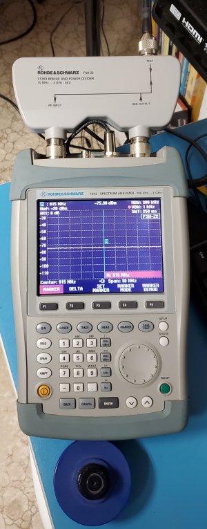

Hi Guys,
Spectrum Analysers are brilliant if you need one particularly if it has the built in sweep generator. The usual problem with these is the front end gets zapped because someone overloaded it. Unfortunately they are next to impossible to repair ! The front ends are like a mobile phone both IC and circuit wise. I've tried to repair one and failed, badly. The manufacturers will offer you a re-manufactured one at a reduced cost. But you need to be rich...
Yes they are a powerful tool.
I'm very, very, very careful with my SA. I have had the over-power alarm come on briefly a couple of times, but I was just over the warning threshold , not dangerously above. If I'm unsure I connect a series attenuator before the input until I know what I'm dealing with. The tricky part is your focused on your signal of interest and meanwhile somewhere outside your selected B.W. there is something nasty that your not looking at and might be unaware off.
DC block is another good defense.
I regret now not getting the 6GHz version but even so the 3GHz has for the most part served me well. Haven't really used in in anger, so to speak, for a number of years. It even has the software in it to be able to find a short circuit in a wire.
Used it for developing the little Blue Wireless Operated Replica Mine (WORM) and my CANRF project.
Reflectometer...is that essentially the same idea as a SWR meter?
Yes but the output is fed to the vertical input of the scope whilst the sweep generator also drives the horizontal scan. The net result is you get an impedance trace with frequency vs impedance. The reverse also works but you may need to use a leveled amplifier on the input.

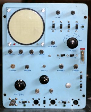

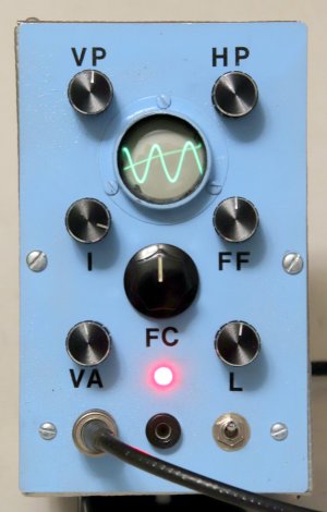

Wow I've not seen 1" or 3", or 5" inch scope tubes for years and years. I think the first scope tube that I had came from a Gov surplus sale. Brand new in a cardboard box covered in waxed paper and tape.
I remember making a 350 volt power supply for it, about a half of what it really wanted.
The 3" tube came from a surplus store on Queen street in Toronto as well as a 3KP1 tube I have. I also have a half dozen 5CP1 and 5AP1 tubes in my attic that I got in a surplus store in Edmonton for 50 Cents each and a couple of Textronics 3 inch CRTs! One of the 5CP1s was going to be made into an electron microscope, which never materialized.
John
As a youngster, I moved a lot. Some time in the early 70s, Pop Tronics had an article and a vendor selling a kit for a 1” oscilloscope using a 1CP31 tube. Seemed like a good idea to buy the kit. That kit and tube probably traveled 5000 miles and moved houses 10 times before I finally realized that I was never going to build it and gave it away.
