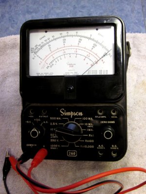

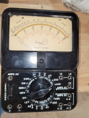

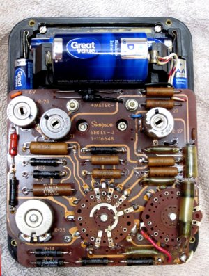

I picked up a Simpson 260 meter from Kijiji for $35. Seller said it worked a few years ago the last time he used it. I gave my last analogue meter to an apprentice when I bought my Fluke 77 decades ago. Working on an ATV with no spark recently an analogue would have been nice to have.
I took it apart to replace the batteries, the old ones in it were starting to leak. I replaced the batteries but the Ohm scale would not zero. So apart it came. I found the manual for it at simpso260.com and was surprised to find out it was made in 1958 or 1959. Following the circuit through the meter I found a poor connection between the board and the post where it connects to the meter. A serrated steel washer had rusted. I cleaned that up and put it back together now Rx100 and Rx10,000 would zero but Rx1 was unstable. I followed the Rx1 circuit and found a resistor that was not properly soldered to the trace on the board. This would have been a problem with it from the day it was new. It works but reads slightly low on the scales I tested. I will use my other two digital meters to calibrate it to.
I now have a very nicely made piece of Canadian history.
It takes five batteries. According to the manual it takes one "D" battery and four "Z"batteries. I believe "Z" batteries were smaller in diameter than "AA"batteries the AA's almost fit but the rear housing will not tighten up against the front housing completely not a big deal.
Once upon a time I had one just like it. I loved that meter.
A friend of mine asked me to come over so he could use it to check his Hotwater Tank Elements. He didn't disconnect the circuit. So I warned him about doing that. He was a master electrician in grid control at Ontario Hydro so I figured he knew more than me! He crawled behind his tank, took the cover off, and damn near killed himself when my meter blew up. It quite literally exploded!
Apparently, they don't disconnect circuits to test them on the grid and they use amps instead of Volts. Don't ask me to explain that cuz I don't get it. After 20 years working with high voltage, he assumed that low voltage was done the same way. He put my meter on amps and put both leads across the connection......
We both learned something that day. I don't Fk with high voltage and he doesn't Fk with low. But it cost me my Simpson. Someday I'll figure out why the methods are so different.
IIRC, I used AAAs with a thin tape collar at the bottom like a barbell, and a piece of brass recessed to take the battery and extend the length at the other end Worked great. Today, I would have made a brass collar for each end. Even way back then AAAs had more capacity than those old Z's. Some modern lithiums today and you would be laughing!

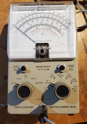

My first meter. Doesn't work anymore. Not sure why. The tubes light up. But the On Indication lamp is missing. Maybe that's why. Might have the assembly instructions somewhere.
That's beautiful! Never had a vaccum tube voltmeter. But I did have a vacuum tube oscilloscope with a green CRT Screen!
Bet we could find the assembly manual for your meter if you can't find yours!

I found it and the schematic is in the back. Now it's just a matter of time to hunt down the issue. I replaced it years ago with a Beckman 310 DVM
Bought that when I worked at Cardinal Industrial Electronics in Edmonton.

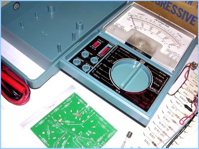

IMG_6707.jpeg My second VOM, bought with my employee discount when I worked at Radio Shack in the mid-70s. Still have it, still use it. Bought the kit because it was an ego boost to say that I built it, even though it took maybe 45 minutes.
