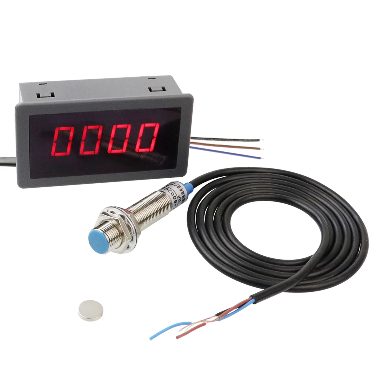

Good day, I'm looking for a bit of advice on hall sensors and RPM displays.
Question 1, for an NPN, 3 wire, Normally Open type of hall sensor like the NJK-5002C as found on Aliex:
and as part of an RPM display:
is the output I should expect a +5V(?) square wave at the black wire? Why does the simple circuit diagram show the black & +V line "connected" with the square/diagonal line block?
If I wanted to replace the hall sensor with the output of a simple reed switch and drive the display module would I have to provide a +5 source to send to the (black) input to the display or could I just use the +V from the display and use the reed switch to relay it back to the display?
Why am I asking these questions? I have the sensor/display unit and I'm trying to measure the slowest speed on my brushed DC motor conversion on my drill press and I'm not satisfied with the RPM I'm getting from the display, it's unstable which may be just because it's a cheap Aliex thing but since I have it I'm experimenting a bit.
I do not have access to a "proper" PA RPM sensing tool but I was contemplating using my O-scope to figure out the frequency of the signal, I think that would be about 3.3 Hz/200 RPM.
Your thoughts & suggestions would be appreciated!

One aspect of the ali switch is the supply voltage needs to be higher than 6 volt. If it’s below 6 volt the sensor will be very unstable and slow to react to the magnet. 12 volt works best.
The black wire is switched, goes to ground-ish when the magnet comes within range.
A reed switch is tricky, they won’t react fast enough to read anything over about 1000 RPM. 1000 RPM is 16 hz, means the reed switch needs to switch faster than 60 ms, and not bounce.
I just checked my tach (same as the ali express except 110 volt), and the brown wire is at +11 volt, blue wire is ground, the black wire outputs a 7 volt signal that goes LOW (0.5 volt) when triggered by the magnet. I get reliable readings from 30 RPM to 2000 RPM (the fastest my lathe will spin)

After some fiddling this evening I got the sensor to give fairly steady readings with the slowest speed being about 180 RPM or about 3 Hz for the 1 MPH setting. I was also able to get to the highest RPM of about 1600 for the 9 MPH setting. The treadmill RPM is measured at the driven (walking belt) pulley which has the magnet mounted at about 4" dia. I've also swapped the drive sheave size down by maybe a factor of 15% so the actual MPH calculation would be compromised but it's not important for the application.
I managed to get the RPM display to run more or less stably by carefully aligning the sensor perpendicular to the magnet at a very close distance. I had bought another sensor (same P/N) in case I wanted to instrument another machine and I tried it with the display but it would only offer an overspeed indication. It did clearly show sensing/switching via the LED on the sensor so I don't know at this point why it did not communicate correctly with the display. The sensor that came with the display has an LED also but it doesn't work......
I was able to see pulses from both sensors using the o-scope although I was not satisfied with what I was able to display, probably my fault. I was hoping to be able to count pulse timing with the 'scope.

I played around a bit more this morning and discovered that by moving the sensors away from the head bearings/quill the display became more stable and the second sensor now works as well as the original. Not completely stable but good enough to think I’m getting useful RPM data.
For testing the magnet is taped to the aluminum driven pulley Away from the bearings and the sensor is on my nauga DTI mount.
Filling in some of the data, I see 11.8V at the brown wire and ~7 at the black except when it goes low/signal.

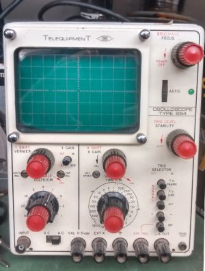

My ‘scope is an ancient Telequipment Type S54 if that means anything:
Settings suggestions? Let's assume I'm trying to catch a 7 Volt, 3 Hz square wave for about 180 RPM. About 2V/cm & 200 mS/cm?
When you speak of a small RC circuit are you speaking of a series resistor (value?) with a small (a few pf) cap between the signal side of the resistor and ground?
