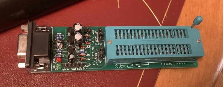

John, took a little research but I did find some info on your unit. It sounds like it will work. The "enhanced" gives you the ability to use an external voltage (Vpp). Some serial ports did not supply enough power to enable the unit to work correctly while programming.
The first post on this page has a file you can download. (JDM_CD.zip)
direct link to file
www.mcumall.com/JDM_CD.zip
It tells you the correct positions to place various chips in the socket. Has a few different software options and a brief readme file.
I would like to take you up on your offer to try your programmer. I'm in no rush. Thinking maybe around the end of August. I have more then enough summer project to finish up right now. :)
