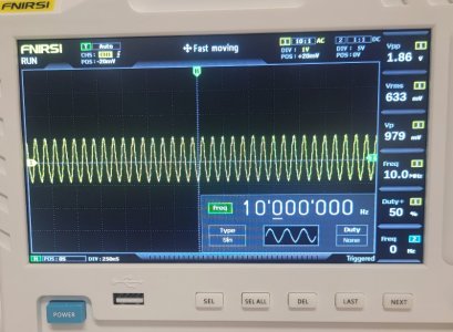

I went out into my north field and spent a chunk of the morning pulling mature curly dock. Then I did a quick dunk in the hose to cool off.
SWMBO is gone for the day so I felt a strong urge to play and my curiosity got the better of me. I didn't know what frequency the signal generator supported. I assumed it might be 100KHz and perhaps 1MHz. So I hooked it up. It is 10MHz clean as a whistle with no voltage loss! Shockerooo!
Clearly, this also demonstrates that the scope is good to at least 10 MHz too!
I also tried the other wave forms, which all looked good but with reduced frequency limit of 2MHz - I'm not shocked. Square waves showed some corner rounding but totally usable. I'm not even sure it's the Signal Generator. The output lead for the signal generator is plain unshielded wires, so sorta worst case too. Plenty good enough for Arduino projects
Sensor circuits, and basic problem investigation.
YUP NICE SCOPE! VERY IMPRESSED! I don't care what others say, this thing is a great first scope for new users!

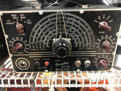

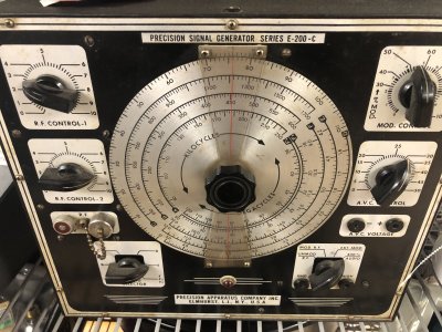

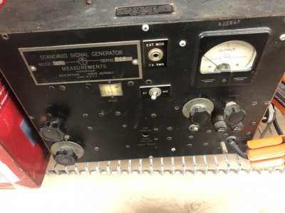

These worth scooping? It's amazing how the universe works some days
Back in the day, I'd have arm wrestled for those.
Today, not so much. There are really good ones available for a song today. Eg the one that comes built into the 1014D. But many others.
If he only wants a song for them, they are prolly worth it just for the parts or the basic functionality. But I wouldn't pay more than about $10 each.
Actually, I take that back. The bottom two will modulate the frequency output with an audio frequency. That easy to do with a small circuit but it's nice to have it built in. They would be fun to play with but still not worth big bucks. I'd give $20 for each of the bottom two.
