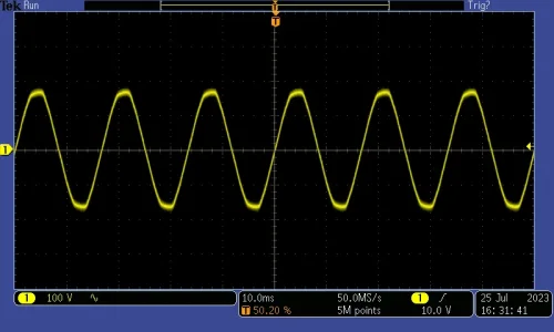

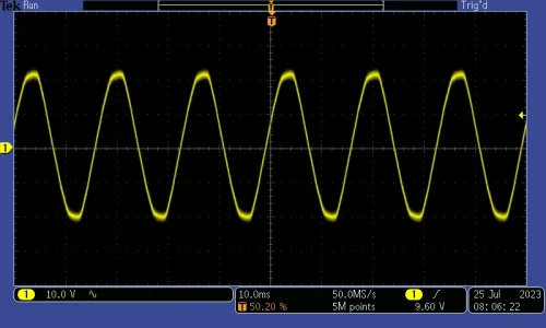

From my Tek scope connected to the unloaded output of a small isolation transformer.
Doesn't look much different with a 39K resistor load. I know it's not the scope so either the transformer is the issue or the power line isn't the nicest after all the power bars and PCs plugged into the same circuit.

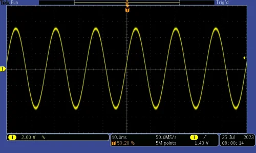

OTOH, using my Agilent 20MHz Arbitrary Waveform Generator and telling it to make 60Hz 10V it's very pretty.
And just to make sure it's not the scope somehow limiting I put two resistors across the output of the transformer. One 33K and one 3.9K and measured across the 3.9K.
So this is definitely either the power line or the transformer but not the scope.

If it's a small cheap transformer the core is probably saturating.
1)Try passing the agilent waveform through the transformer. More than likely will pass through with minimal distortion, giving the impression that the original mains waveform is distorted, but it's probably not. The Agilent probably has maximum output of 10Vpp or so.
2) Then using mains to power the transformer insert a series resistor in the primary to reduce the input voltage at the transformer input terminals to say 60V and the secondary will likely look like a nice clean sinewave.
And the frequency response of the transformer is?
Likely 60Hz since it's a small isolation transformer.

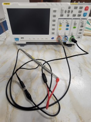

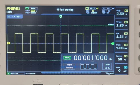

Hey Janger. Here is a step by step procedure for calibrating (setting the compensation) on the 1014D Oscilloscope.

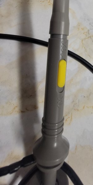

Connect the probes as in the photo below. The alligator clip lead is connected to the green "Gen" output, and the test probe is connected to the orange "CH1". Set the probe to 10x.
Generally speaking, it's always best to leave your scope probes set to 10x. They work best that way and it reduces the risk of overloading the scope inputs. You don't actually have to connect the two grounds as both the signal generator and scope input already share the same ground internally as @slowpoke has already mentioned. In this case, it won't matter if you do or you don't. The 1014D is nice in that regard because it doesn't have a mains ground.
Then turn on the scope.

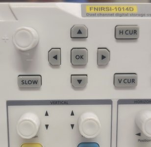

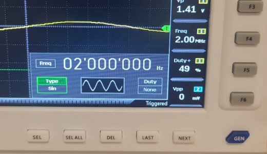

Next press the blue "GEN" button to the left of the CH1 input connector. (bottom left corner of the following photo) You will get a popup box that looks something like this:
The green type box should be highlighted. If it isn't, then press "OK" in the center of the control panel above the channel boxes.
Here is a photo of the OK button location.
Each time you press ok, the green active box will cycle through the options. Press ok till the type box is green.
Now press the up down or left right buttons until the box under the type says square.
The box to the left should say 50%. If it doesn't, just press ok till the duty box is highlighted and then press up or down (but not left or right) until the box says 50%.
Now Press ok again until the "Freq" box is highlighted Green. Now you can press the right or left arrows until the digit you want to change is underlined. Then press Up or Down buttons to change the digits. You want to set the frequency on the 1014D to 1000 Hz like this:
That is it for the function generator. Just press the blue "GEN" button to close the generator menu. It should be busy making a 1KHz square wave signal on the alligator clip leads.

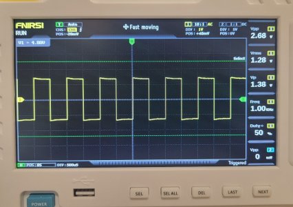

Next, you can be lazy and just press the light blue "AUTO" button at the top right. This will automatically set the time and amplitude settings for channel one. It should look something like this:
I deliberately offset mine to show a distorted waveform.

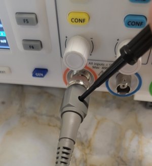

Now you get the small plastic flat blade screwdriver that came with your probes, insert it into the compensation port at the connector of your probe as shown in this photo.
Gently turn the adjustment one way or the other until the display shows nice square waves like this.
That's about it.
Higher end Scopes usually have a special Calibration loop right on the front panel for convenience. Not to worry, this Calibration method works just fine. You can also reset the compensation at higher frequencies if you wish, but 1KHz is common.

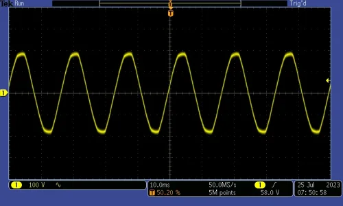

Turns out I did have an isolation transformer. It was sitting on the far corner of the table saw extension table with the #42 on it. Along with the terminal blocks, Bridge Rectifier, Fuse etc for creating a 165VDC supply for my 4th Axis Harmonic Drive. Now that I'm using the AC Servos I don't need the massively large 105VDC drive for the 3 DC Servos and Harmonic Drive but I kept it in the cabinet because it's running the harmonic drive (Casting mount for that is project #42).
Anyway, I wired it up as 115VAC in/out and plugged the scope into that. Now no worries about frying anything because the scope ground is touching the hot AC. (Like the fridge compressor drive).
This is the AC waveform from the power bar now. Nothing in the way. But there are a number of computers and adapters all plugged into this same AC circuit.
So that's what the AC line looks like inside my office. May look different on the pole but I'm not climbing up there.

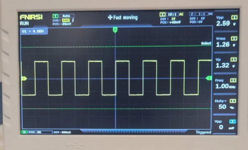

Well I just calibrated my two probes - Thanks very much John for the tutorial. It was very easy to follow. Both of the probes needed calibration
After calibration the 120V AC power still looks about the same on the scope. It is connected to a power bar. The power bar is also running the scope, a computer, and the power bar has a power light. I gather these other peripherals could create a difference from an ideal sine wave?
