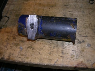

This is the stock I started with. A @Tom Kitta donation (thanks Tom)

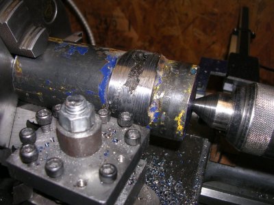

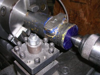

After numerous manipulations using the steady rest, I got the piece to a state where I could attempt to turn off this welded on bracket thingy. I didn't want to waste 2-1/2" of 2" round stock.
It was a bumpy ride turning that wart off, but at lease the weld wasn't as hard as I imagined it would be.
Eventually ended up with this and then it was on to the final product.

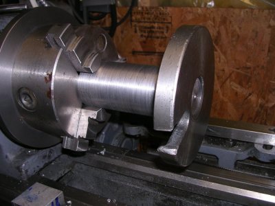

And the final result.
Way to Go Craig!
So explain this to me please...….
Once I had threaded to target depth, I ended up having to re-thread at target depth 5-6 times before sufficient material was removed for the dog drive plate to thread on? I was surprised at how much material was being removed with those subsequent threading operations.
Boy am I liking this arrangement for drilling on the lathe...….
This is way more stable than a drill chuck....
