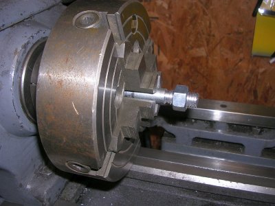

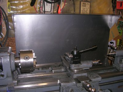

So today we tried threading away from the headstock.....

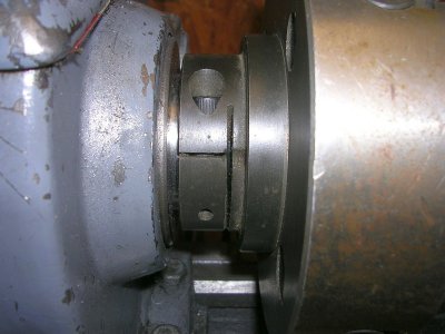

To do this I needed to run the lathe in reverse.... It has a threaded spindle.

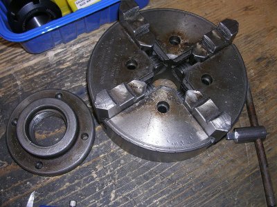

I was able to run in reverse because @Johnwa traded me this clamping type 4J chuck for my standard 4J chuck (Thanks John!)

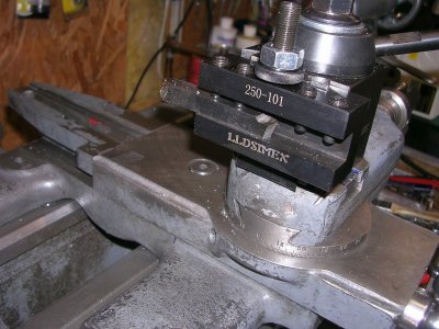

Approaching the work piece from the front required the tool to be inverted.

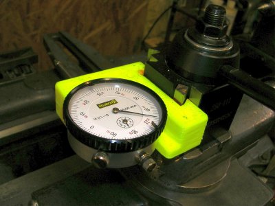

@johwa will recognize this. He 3D printed it for me quite some time ago. (Thanks John).
All in all this went rather well and it is sure is a lot less stressful than threading towards the headstock.
Nice work!
(I wonder if anyone has ever made a clamping collar for a chuck...)
If you ever take that chuck off, I'd love to see some photos of how that clamp works.....
