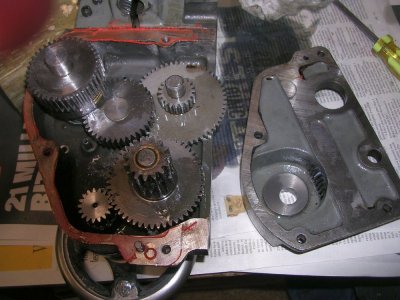

I finally got fed up with my apron leak and opened it up.....
All the external shafts are above the oil fill level so it must be the leaking from the housing. The gasket material that was used is next to non existent. The good news is that all the internal gears etc appear to be in great shape. The pinion gear does show some wear, but not a lot.
What do you suggest I use for a gasket? Would an instant gasket in a tube work, that is what was on it. Would cardboard work?
@Hruul , @YotaBota what did you guys use?
That’s arguably the best gasket maker out there. Or you could make a gasket from gasket paper, smear some regular black silicone on the paper both sides before assembling

I'm kind of curious about this too. I've put some aluminum parts together with various gasket makers & the problem was it stuck too good. I had a heck of a time parting them. His apron is a more rigid piece of iron where some leverage would shear the goop & not probably distort the part. But generally for oil holding seals like this, should there be a gasket plus goop as opposed to goop alone? What does it depend on?

Interesting question. I’ve never been worried about disassembly so much, as I’m more worried about leaks.
For seals we always used to use Loctite plus grease or tranny assembly lube to help seat things
Sometimes silicone on the outside of seals or loctite then grease or assenbly lube on the inner part to lock the spring in place

Not sure where your oil level is in the case ( you say lower than all the shafts) but , for my money I would want a deeper oil reservoir than that bottom shaft shown. the shaft outlet on that cover has no seal or gasket provision so I think maybe your oil seep originates from that shaft. I know the carriage gearbox for my "China Doll" has a constant oil seep from the shaft journals on the inside face.
A couple of points on gasket material. Like Chicken, I have basically gone away from paper gaskets and use strictly goop of one brand or another ( they all seem to work) unless it is something built that only a thick paper gasket will work. The thing is that on most aplications, gooped up pieces can be tightened but not over tightened and work fine.
The thing with thick paper gaskets is that they need to be tight but not over tightened especially with cast or alum. box's. They are brittle and can crack between bolts if tightened too much. The paper gasket will compress at the bolt positions but the casting will bend & crack between them.
I would use paper gasket only on a top "splash cover" that doesn't have oil bath to hold in over long periods of time....goop in your apron case.
That gasket discussion makes good sense. I need to get educated on the goops. There's gasket sealer, maker, different chemistry, silicone, rtv, urethane... different durometers... I also wonder if aluminum activates differently than steel or cast iron.
My (Taiwan 14x40) lathe similar shafts riding in holes in the cast iron apron casting. But I think mine is the last of the vintage before they went oil bath apron. You could pull a parts manual of some of these machines to see how the sealed. I suspect some kind of O-ring or rubber washer, but maybe inset into a machined groove. To avoid machining & experimenting I've read where people have siliconed a loose fitting rubber washer on the casting face. The excess goop makes kind of a fillet around the shaft. When cured breaks free from the shaft (acting as kind of a mold). I'm not sure if the shaft is treated with something like a release agent? Sounds a bit ghetto & never tried it but sometimes that's all it takes.
@YYCHobbyMachinist : make sure you clean off all the old liquid gasket and then use acetone or some other non residue cleaner to be sure both plates are oil free. Apply a thin amount of the sealant as you do not want it gumming up your gears - once you re-assemble let it fully cure before you add oil. I cannot recall any gasket or sealant on the donor lathe. If the apron piece is still in the junk bin I will see if there is any tell tail signs.
