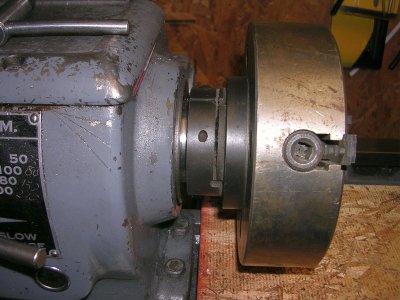

Which line are you trying to spilt it at? Red arrow or green?
Looking into the bore from the front / back, do you see a step? If there is a step, you might be able to use an aluminum or brass drift and a hammer as a persuader to help it separate.
My guess is there is corrosion or just old, dried gunk holding it together.
Red arrow, there is no seam at the green arrow. You're probably right about it just being corroded on. @Brent H said it was a rust fur ball when he took possession of it.
Hmmm.... hang on here. Maybe there is a seam at the green arrow. That would explain why it wouldn't tap off.

They can take quite the hits to get them apart. If you don’t like metal on metal, use a piece of hardwood.

The 4jaw doesn’t screw on. My measurement of the bore on the crack plate is 1.495” and my spindle measures 1.503. I will have to bore a few thou out of the backplate.
I’ve taken the chuck apart. The backplate just popped out..
You got that back plate off:confused: It wasn't going to come off for me without beating on it. Did you remove the jaws or anything like that? As I said I have another 4J with backplate inbound from @140mower. You want to wait and see what that one measures?
Well I did use a hammer. Only 1 vigorous tap and it came apart.
