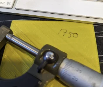

And all the pulley wheels have now been re-intalled correctly - first set the screw to the flat, then the cross-lock screw. Both X and Y were experiencing small amounts of backlash from wobbling on the shaft.
Nice clean calibration part: height within 0.02mm, X and Y both about 0.05mm/cm. I didn't particularly pay attention to thermal expansion in the slicer or in "generic PLA" parameters, so I'm reasonably pleased with that.

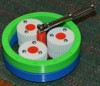

I hope I'm not sounding negative. But as far as I know there aren't any CNC milling machines out there that take a 3D STL drawing and can automatically set up the raw stock and machine it automatically. To get to the point of taking a drawing, creating CNC G-Code, setting up the machine with the tooling and work holding and then machining it all automatically doesn't exist. And if it did it would be way out my price range.
Even the ability to design out of metal, machine and put together something like this in metal at the moment is outside my abilities. The spur gears I can do. The ring gears I've not yet got the setup for that.
And I believe the learning curve for 3D printing is way lower than metal working.
My 2 cents.
