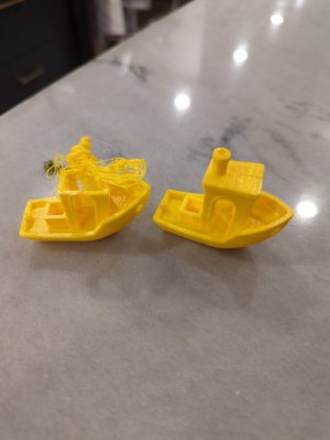

Benchy apparently had a print error 2 hours and 30 minutes in.
Still something to get right in there.
Hows the belt tension?
Nominal. I just got in to find it in this state. In the morning I'll check the print errors. At a glance I'm guessing the nozzle is dragging some crap. Need to pull it and clean it properly, which I haven't done yet.
But do you get a free blob and snarl with yours? I clearly need more calibration.
No. It's about half way through and looking pretty good.
Now I still prefer the Repetier Slicer program but the SOVOL program that came with the printer uses CURA and I've mostly used it out of the box so to speak.
I'm running my first layer at 0.1mm and 150%. I'm not sure the 150% is working right because unlike my Repetier driven glass top printer the first layer strands don't run into each other. It's something I've been meaning to get into but work-work at the moment is keeping me very busy with of course also the family stuff.
The slicing was done at 20% infil and the speeds all stock as it came. However it may be important to mention I was having a heck of a time with the infill earlier. Was not impressed. I contacted my friend JoeMac and asked him since he has the same printer and it turns out he wasn't having those problems. What the F?
Well his software was an older version. Mine was newer and apparently had a bug. I updated to the latest and my infill issues suddenly went away.
I'd suggest if you are using the SOVOL application the first thing to do is update to the latest version.

I believe it shows most of the parameters in my setup. My Benchy is still printing.
So here it is. At first I thought it really screwed up the drivers seat. Then I realized (and confirmed) it was the throne made with all the swords.
I suspect if I slowed the printer down a tad it might print better quality. But this wasn't bad.
Still something to get right in there.View attachment 42874

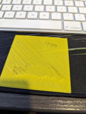

I'm going to guess you have adhesion issues. It comes loose, moves a tad and then nothing lines up and you get the rats nest of traces.
Print the first layer of something and then stop the print and post a photo. Let's see what the first layer looks like.
Calibration first layer patch. I'm now running with the 1.750 mm extruder offset.

I like the glass finish on my older printer. The rough shape on the new one with the magnetic plate isn't as nice. I'm not happy with the brim on the new one. The lines aren't the right thickness. Maybe no one uses a BRIM on this printer so it might even be a bug. Or I have something set wrong.
