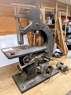

I've been doing more work on the bandsaw. Now that I have a 5HP motor, I needed a pulley.
Fortunately I had this bar of 6061 hanging around that I picked upon speculation some time ago:

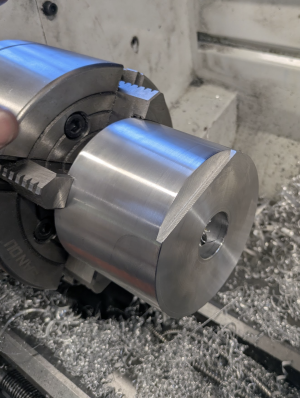

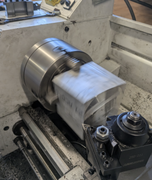

Then a 4-jaw face-off:

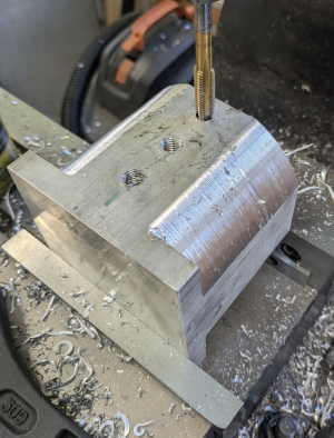

And before losing my starting faces, which are square enough for my purposes, I dropped in a set of tapped holes to drop some square-ended set screws to engage the keyway in the motor shaft.
I added some indexing faces so I could drop the pulley on a set of narrow parallels in a vice. These are exactly opposite and perpendicular to the tapped holes in case I decide I want to remachine the holes or set it up in a shaper for a real keyway.
For now this will do to get a belt length measurement off to Jack Forsberg to make me up a flat belt. I'll post some pics of the final setup when I get the saw going!
That must have been a heck of an interrupted cut!
That was the least pleasant hour of the project. Whup whup whup whup...clench clench clench clench

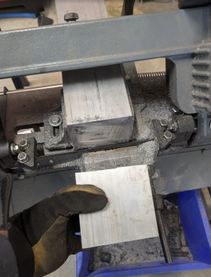

Removing the 1/2" I left on to hold it was similarly annoying, though with more experience it was less terrible.

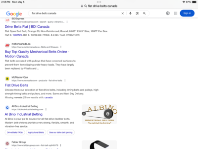

Just a tip...lots of pieces of old round baler flat belts laying around farms now that can be used for short "new flat drive" belts. Susq or one of his neighbors could have a suitable piece laying around. The alligator jaw joining clips can be had at any farm supply.
used a piece to build a new belt for my Hendey Lathe, any length or width you desire, easily cuts to width in a wood bandsaw
I'm far enough from farm country to make this harder than it might look!
I don't mind sending some business Jack's way. I enjoy his woodworking machinery videos, and he's been plenty generous in time and advice getting a decent drive on my bandsaw. And I'm not particularly financially constrained at this level, so I'll spread it around a bit.
