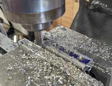

I was going to mount the new slide on a face plate, but I lack any way to easily center the new slide blank and hold it in place, so I figured I'd put it on the rotary table and to the excavation with the mill.

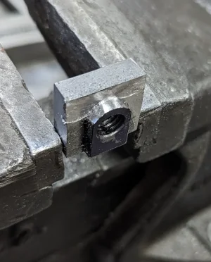

You guessed it, the rotary table T-slots are 1/2", all my T-nuts are 5/8":
And the T-nut slots are awkwardly rounded, so in the absence of the RT alignment pin, I hit them in the vise with a file:
Which let me learn how to indicate both the rotary table and the part on top of it. Really too bad I don't have an MT3 center thingy. This is after remembering to raise it up off the table to avoid carving up the table:
I got quite a ways further wasting away a pile of circular cuts before somethign went "clack" and the RT started to judder with about 1 degree of backlash during the cuts. Grump.

Figured out that much of the judder was from climb milling the inside diameters. The first work I did on the table was on an outside diameter, and I neglected to think through the change in cutting direction. You'd think that would have been automatic for my brain given how many years I've driven a router.
