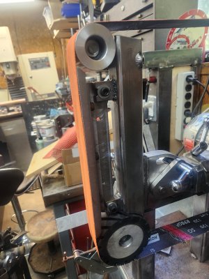

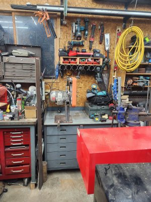

Big day today. First sparks.....

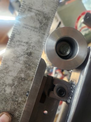

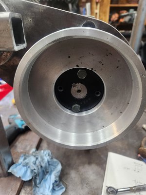

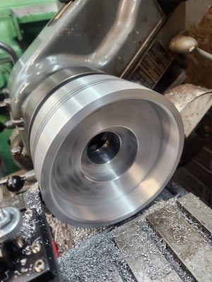

Finished machining the wheel, and boring for the taper lock.
Tracked the first belt by hand, and it landed in the middle of travel. Ran it a bit and it didn't budge....I'm pretty impressed.
Still lots to do, platten, tables, accessories (a spot to actually put it....) but now that it actually works, it's a huge weight off my mind.
Once I get the table done I'll clean it up, paint it, then do a full build thread for it. I may have lost the cad model along the way, So I won't be able to go through all the iteration stuff like I wanted to, but I took lots of pics.....
Not sure happy is the right word, but it's close. 🙂

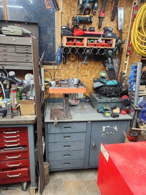

Every new addition requires a reorganization.....I think here might be a good spot for it. For now.....
This will force my hand to finally move my battery tool storage to a better spot. They just ended up here because it was easy. Never liked them there....

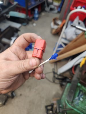

Thats enough for today. Got a lot done, but imo the most impressive was bluing in the taper lock for the wheel and not getting a drop of Prussian blue anywhere that it shouldn't be. First time for everything I guess.....

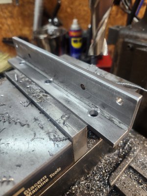

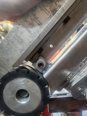

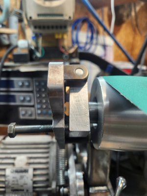

Flat platten done.
Lots of adjustment, and symmetrical 4 ways so I can flip it if it starts to wear.

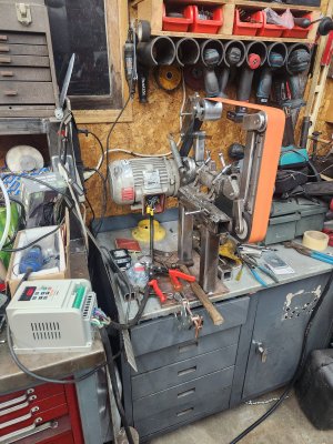

I have a bit of (re) design work to finish before I get started on the table. Also ordered a vevor vfd for it, which should be here tomorrow. I found my motivation for this project again.....snowball effect, I just needed to get rolling again...
Waiting around for the VFD to show up today while modeling the rest of the grinder again, and got a service call to Brampton at just before noon. Drove there 1:20, fixed machine in 15 minutes, drove home 1:35 to a VFD still not here. Showed up around 6. Start gathering all the wire and stuff I KNOW THAT I HAVE, and realize I already used that stuff I thought I had when I wired up the MIll VFD. Damn it. I drove past countless Home depots on my adventure today too....Argh. I DID have enough stuff to wire a new 20amp 240v circuit over there for it, so once I make a trip to the $100 store in the morning, I should be up and running by lunch. That is if this Vevor VFD purchase goes better than the last one.....

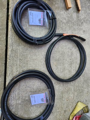

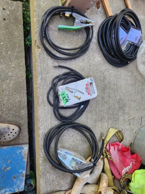

Nice productive day today. Trip into town for a market place buy of some welding cable/ground clamps. I stopped at Homedepot on the way home for the cable I needed to wire up the grinder. Ended up getting some off cuts for 30% off.

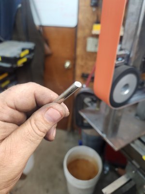

I like that VFD from Vevor so far. Variable speed pot built right in, and easy to setup. Much better than my last Vevor VFD experience where it let the smoke out immediately lol. Grinder runs from 0, to 120hz without issue. Only ground a bit of steel so far, but it's a beast. And that's only with a 120g Norton blaze belt. Will have to try some coarser ones tomorrow. Looking forward to getting the table done and put into action, so I can move on from this and onto some other more exiting projects (that the grinder will be very handy on).
The welding cable was $25 each 1x12' 4awg, and 2x 14' 2awg with ground clamps. I thought that wasn't too bad. I can finally wire up my old lincoln buzz box again, and pass it on to a buddy of mine that will actually use it. I hung onto it for a semi portable machine able to run off the generator but that little inverter lunch box I bought a couple weeks ago negates the need for that heavy beast, so it needs to go.
