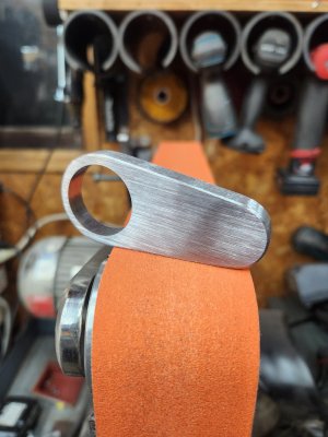

Played around with the grinder a bit today. Tossed a 36 grit belt on, and let er rip.....Nearest thing I can describe is burying a facemill into a block of steel with a horizontal mill. WOW. That brought a big smile to my face. Even moreso when I put a 120g belt on and slowed it down. I really can't wait to use this more and more. Gonna wish I didn't take like 5-6 years to design/build it now.....:D
Here's a pic of the finished part. Just a tab for a spring plunger to lock the tension arm down for belt changes.

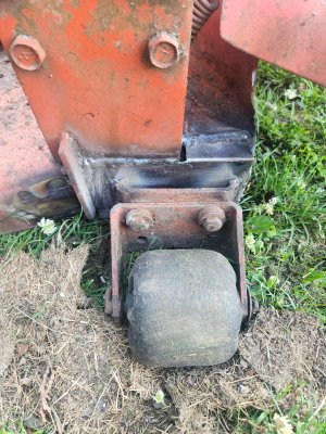

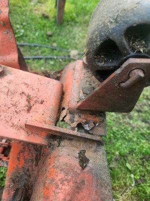

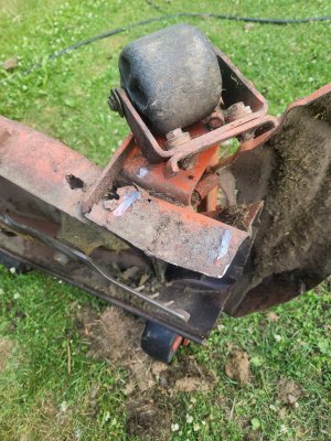

Went to cut the grass this afternoon, and it completely slipped my mind that the mower deck was broke.....and that I was supposed to fix it last week.......
This corner is gouging and scalping the grass.

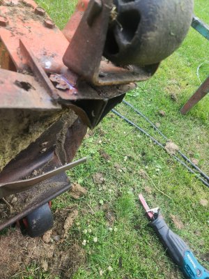

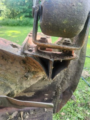

I cut off the wheel bracket with the recip saw and a diablo blade. I love those things.

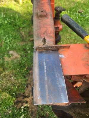

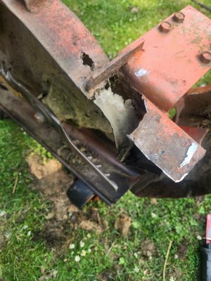

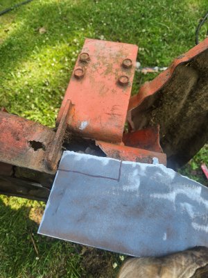

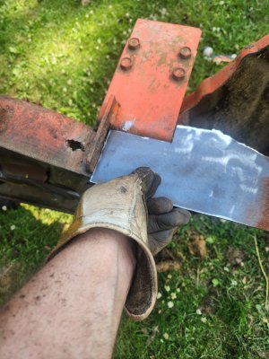

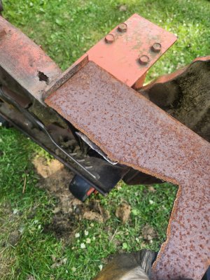

Pulled out the rusted crap, and found a piece of 10ga hanging out on the back bench.

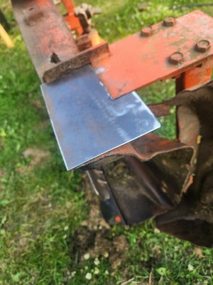

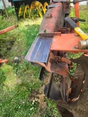

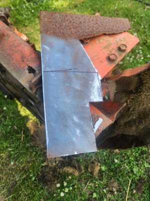

Started drawing and cutting...

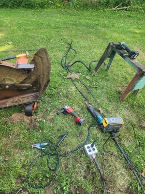

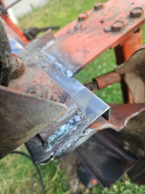

This job was a great first test of the little lunchbox Toolium.

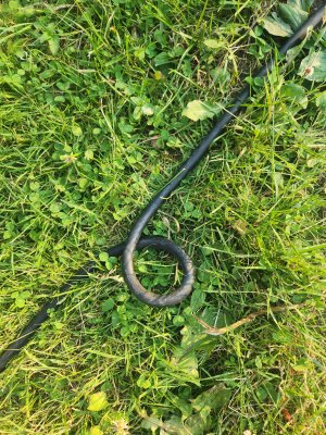

Not my best work, but it's a lawnmower deck.....the little Toolium was great for this. Running off a 50' extension cord was alright, but I had to play around with amperage a bit. Hard to light up sometimes, but not terrible.
Now, finish dinner, sharpen the blades, and cut the grass....finally....

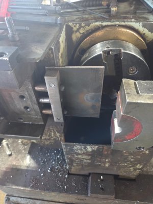

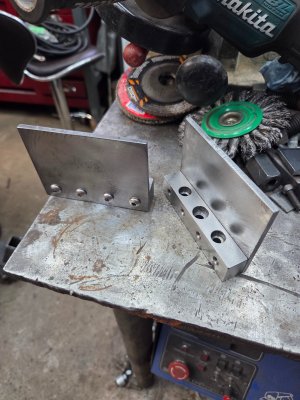

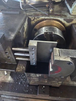

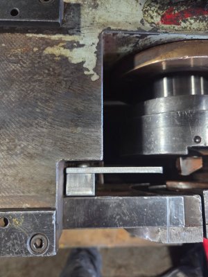

Last week I got called to fix a couple end facers. The stop blocks were perpetually breaking, so I proposed making some new ones and beefing them up as much as I could. Here's what I came up with.
Those are the existing ones. 5/8" square with a 1/8" plate.

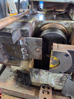

And the new ones I made. 5/8"x7/8" main block with a 3/16" plate.
Not much room to play in there, but it should be stronger than what was there.
I have a few more improvements for another machine to quote for them today.

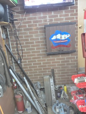

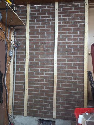

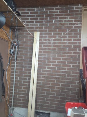

Knocking off a bit of a barrier project today. Finally hanging some osb on the brick wall by the doors in the shop so I can move all my battery tool storage over here.
Its a bit of a catch all back there....
And that's where I'm at for lunch break.
Thought 2' centers for the full sheet would be fine, and it probably would, but I'm going to pull it down and go 16" instead before hanging sheets.
Not really enough room there to every hang anything heavy, but ya never know......
