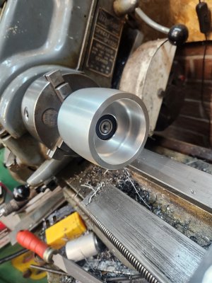

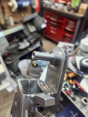

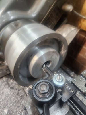

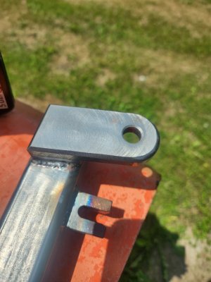

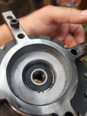

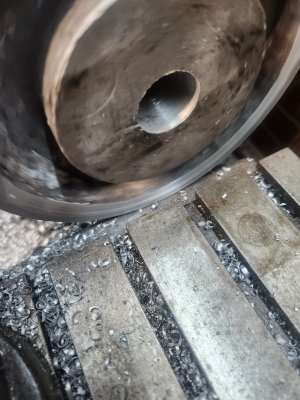

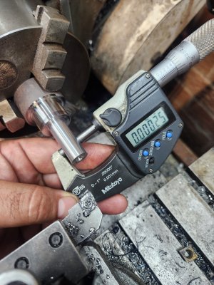

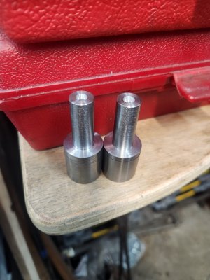

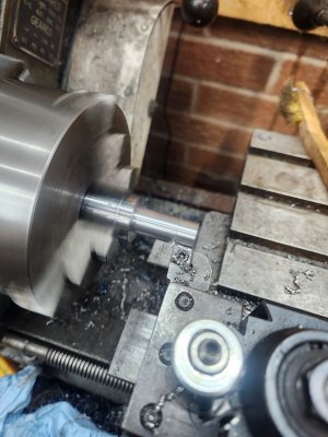

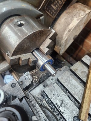

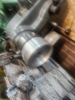

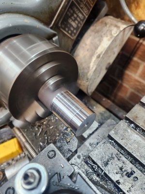

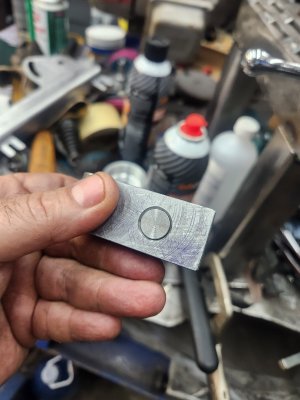

Also finished the contact wheel snap ring groove, and the tracking wheel axle.

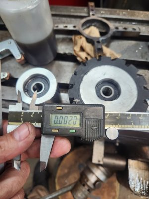

Machined the bought wheel to length, then measure how close i got the bearing bore depths between the two.
Not bad, for the hokiest setup for depth control ive done yet....
The axel was made from a large fhcs
Thats all for today.....

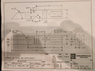

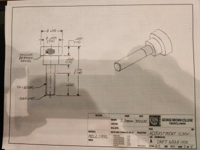

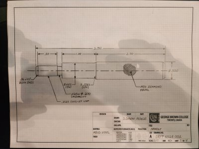

Spent the morning redoing the cad modeling for the grinder. Still not "done", but done enough that I can finish the axles for the platten attachment wheels. I had prints printed from the original model pre crash, but I made a call to flip the wheels end for end to what I originally had, so wanted to draw them to make sure it would be right. Still a few more things left to model until I'm back to where I was, but I'm not doing all the revisions and major design changes I made along the way. Still really bummed about losing those, as that was a major thing I wanted to highlight when I get to the point of doing a build thread on it. Oh well, something, something spilled milk......

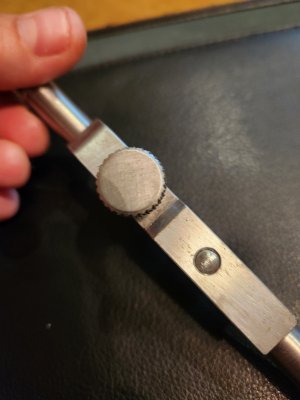

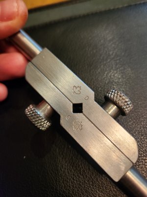

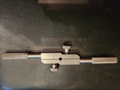

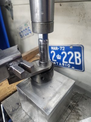

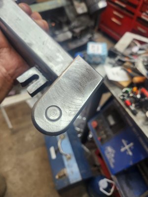

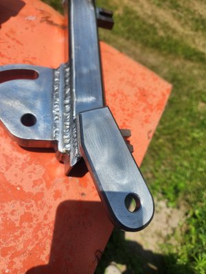

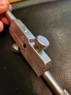

Then I started cleaning up from my school work and took some pics of my final drafting project, and machine shop project (tap wrench). See If you can spot the difference between them......

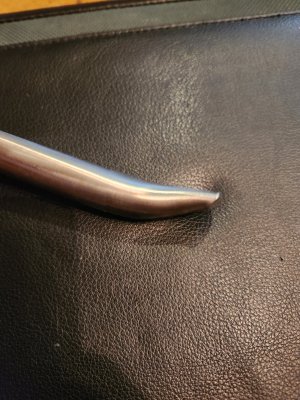

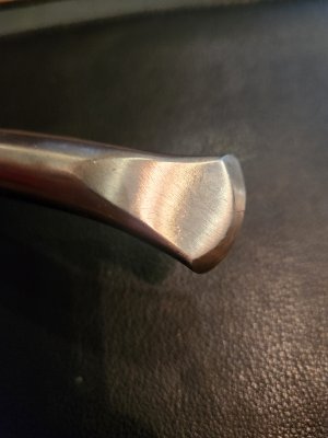

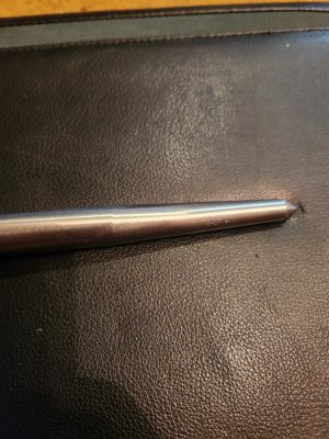

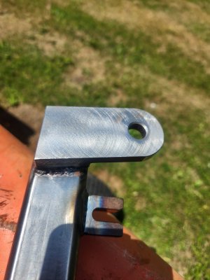

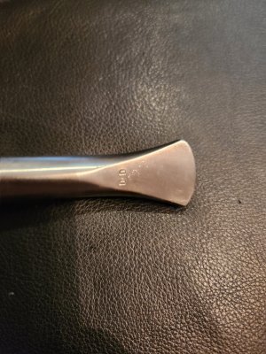

We also made a prybar from c1045. Machined taper, forged pry end. Normalized, Hardened and tempered. What looks to be a crack in the tip is just a scratch. Just noticed it after taking the picture......Had a bit of a panic when I saw the pics lol
Should be pretty handy at work. Not sure I'll ever use the tap wrench, but it was a fun one....

That is a nice looking tap wrench, it would get used a fair bit around here.

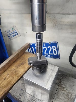

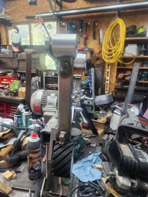

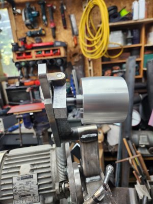

Found a few axles hiding in these today...Salvaged 6"x1-1/4" FHCS from rock crusher wear plates I worked on a few months back. I save everything 😀
Have not pressed them in fully yet, but will probably do them tomorrow, as well as a few more finishing touches. All wheels except the drive wheel are mounted and rolling now...

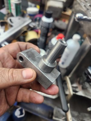

Got some finishing touches done today. The axles pressed in, and all the wheels but one mounted.
There is about a 1 thou interference on the 1/2" diameter, and I will eventually weld the backside, but want to run it first incase there's any issues with that design.

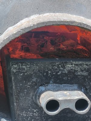

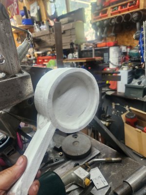

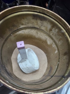

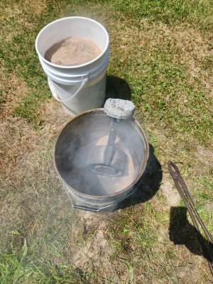

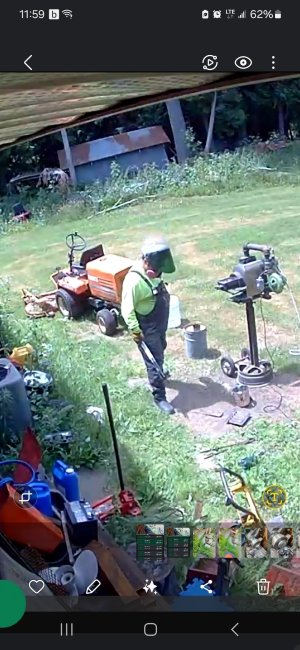

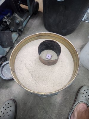

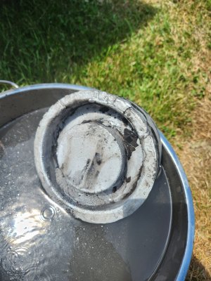

Well, I finally had a successful lost foam wheel casting today.
Deja vu yet?
Here's something not seen yet. A good casting...

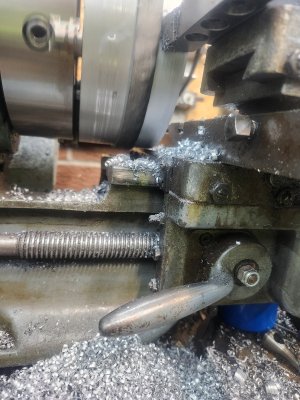

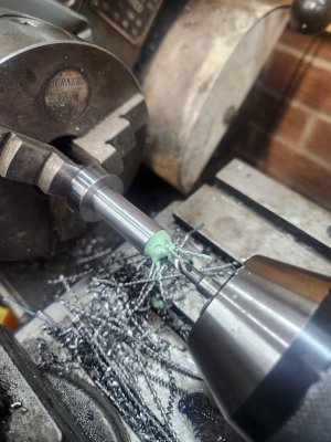

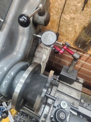

Almost got it all machined, but i got called into work tonight, so had to quit early. Only the taper lock bore left. It cleaned up pretty good, some slight porosity/sand inclusions, but not bad enough to worry about.
Pretty happy right now 🙂. If I didn't have to work tonight I'd have a running grinder before I went to bed tonight.....tomorrow for sure 🙂
Wasn't sure the myford could get it all, but was no prob. But clearance is clearance....almost like i planned it....
Crocs. The preferred footwear for those who deal with hot, liquid metal... 😛

No progress on the wheel today. Work kicked my ass last night, and I slept all day to go back in tonight. Was rebuilding the vanes of a large fan separator that grenaded it internals. Fun time......

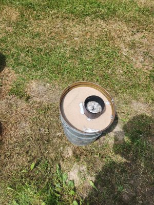

I did have a thought last night around 4/5am though....Not sure if it was a fever dream or not, but the crucible I made to pour this using my forge is really no longer of any use. It was basically just to get me through this job, and I'm going to focus on building a proper foundry to use graphite crucibles next, before I do anymore large castings. I'd thought about using it as a large ingot mold when I was finished with it, and that's why I made it drafted on all sides. But I had another idea last night to make a lid for it and use it for hardening/case hardening. Maybe like a sliding lid that I would be able to get off in a hurry to quench. Bolts would be too slow I think. I'd like to be able to play around with colour case hardening with various carbon sources, and having a large vessel like this would be very handy. Any thoughts, ideas, anecdotes, or good limericks?
