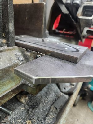

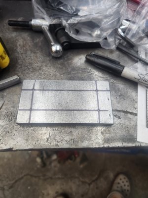

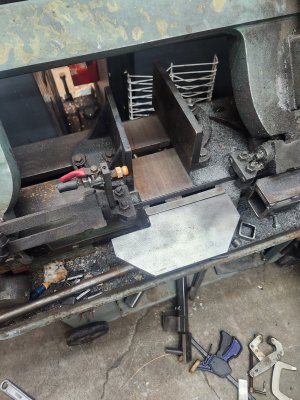

First grabbed an off cut of 3/8" plate sitting on the welding table, cleaned it up, cut 2" off for the face mount, and drilled some holes.

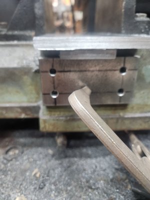

Drilled and tapped some 1/4"-20 holes in the saw casting. Then clamped up some spacers from the table and tightened it down.

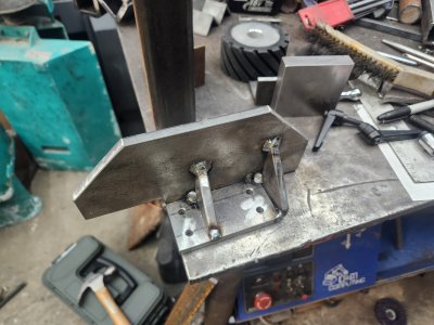

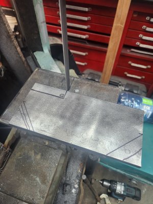

Took the rest of the plate, and cut the corners off, and clearance for the blade guides. The corners will be my gussets for underneath.
That was last night, and not wanting to take chances welding over an oily chip pan at 20:00....I called it a night on this.

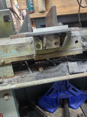

Earlier today, It was a quick task to clamp up the table to some other flat stock to keep it co planer with the saw, and hit it with a couple of tacks. I then held the gussets in there, and tacked them too before removing the entire thing from the saw and welding it up a bit more solid. Not completely, but just made sure everything was secure.

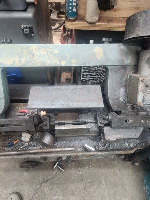

Mounted back on the saw, it fits great, and is dead flat across the saw table.
This is just another one of those little things I've always wanted to make, but never get around to. I have a lot of these projects.....Losing motivation to slog through the grinder build, so this was a nice pallet cleanser with a sense of accomplishment, and should be a useful addition to the saw. The one good thing about building my own design of a grinder so far is that it's forcing me to complete so many other side projects because I don't feel like working on it all the time lol.

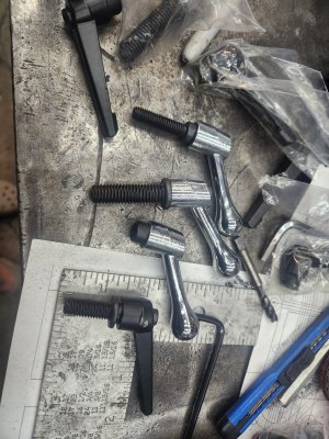

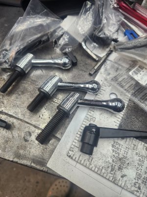

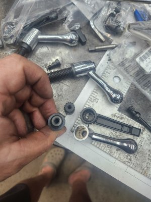

I also was playing around with some hardware for the grinder last night. I ordered these steel adjustable clamp levers because I really liked the look of them, but I couldn't get them in all the sizes and m/f threads I needed. Bummed about the mismatch in hardware I decided to take them apart to see how they worked, and discovered that they are interchangeable. Jackpot. I just have to order a few more, and I'll have the entire grinder with matching hardware now. Little things like that bug me, and I was almost at the point of machining my own mold so I could pour my own Al handles and have them all matching lol. I was intially going to pour my own thumbscrews for the entire build with the mould I made a while back, but I like these adjustable ones way better than thumbscrews. I will use one of my screws for the tracking knob though.
How they came.
The insides. The retention screws are different, One is Phillips, one is hex socket. Different thread sizes. But the splines match, and interchange fine in either handle.
and how I need them
Initially I could only find them in m8x25, and m10x20. I needed one to be at least 1.5" (40mm) so I ordered an orange handle m10x40, and was disappointed to find that those splines are different and they won't interchange with either lol. Searched the internet again, and google turned up an amazon link (yet searching from amazon did not for some reason) for an m12x40 with the chrome steel handle, so I made a slight design change to accommodate that. Which is funny, because that was the part I procrastinated on the other night, and I would have had to rework it had I went ahead and made it........Premonition? No idea.....But it was a rare occurrence when something actually works out in my favour.....

I have used a make-shift platform like that a couple times for my saw. I just use a 8 inch wide piece of heavy web 6" angle iron C-clamped to the same spot on the saw as Dan's is
I almost went that route too, but there's a few degrees draft on the saw casting, so I figured by the time I bent that down to level, it would be just as easy to make an ugly weldment.

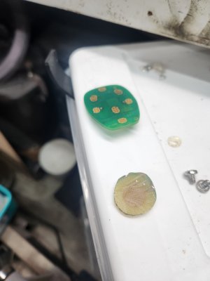

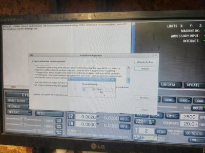

Wireless adapter arrived, and was plug and play (thankfully). Currently downloading pathpilot update 2.6.0 to 2.12.0, then hopefully I can easily talk to it via my laptop using map network drive.
All was going good until....
Dammit

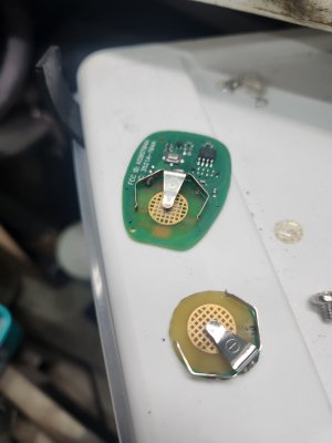

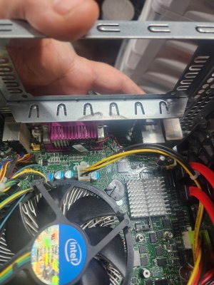

NBD, open up the case, find the battery and
Dammit....

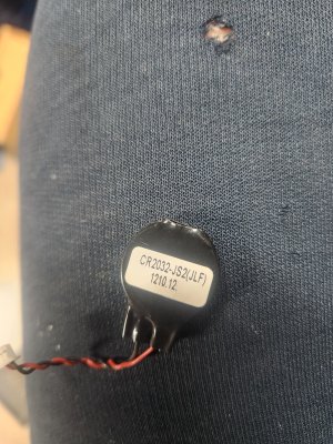

Soldered tab with plug....12 years old is a pretty good run IMO...
Not wanting to solder tabs/wires to a button cell, I figured I can whip up a battery holder from an old car keyfob, and be back in business.....Took it outside to massage it into it's new form, and then went back downstairs to solder the old wires onto it.
Dammit.....Now I cant find the old battery anywhere. I have no idea where it got to. I was only gone for less than 5 minutes, kids are in bed, wife wasn't home yet either. The only possible "thing" that could have moved it is the cat lol. I cleaned up the workbench quite a bit (loooooong overdue) trying to find it to no avail. Ugh.....

Not wanting to admit defeat tonight, I mixed a drink, went back downstairs and start tidying up again hoping to find it. Or at least end up with a clean workbench....SO much crap just gets piled on and around my workbench down there, Things like an old empty coffee can I saved to store stuff in......For some reason, I looked down at that can on the floor, picked it up to move it somewhere else, and the battery was UNDERNEATH it. How, why? I really don't know....Must have been the cat........but I have my battery back, and will solder up the holder with the old leads and hopefully be back in business tomorrow morning.
I also found an old usb memory stick buried on the bench from about 5 years ago, that contains a few cad files of projects I thought were lost. Like a version of my belt grinder I started back in 2017. And the cut files for the Yarn winder I built for the Wife in 2019. I must have used it for the Resin printer and forgot about it, as it had a couple print files from around that time. Finding that was a nice bonus.
Finally a check in the win column. Soldered "new" battery holder to old wires, checked with a meter, wrapped in tape because I didn't have heat shrink big enough (add to cart....), hooked everything back up and voila. Path pilot upgraded to latest version, and it was quick and painless to map the drive to my laptop. I just need to figure it out on the linux end, so that when that computer is off I can still post my files to the laptop, then when I turn it on, I can simply grab them from there, instead of having to move them from the laptop. Not a huge deal, but it would be nice to connect both ways. I just don't know how to do it from the linux/pathpilot side of things or if it's even possible.
If I understand what you want to do, (read and write data to your drives from various sources) it isn't going to work. It will always have to be read and written to the drive from the same computer that's because the file and data allocation tables are stored on the control computer. They are usually also stored on the storage itself, but only for backup and restore purposes. If all your machines have to read that first, they will make a jumbled up mess of things.
Your best option is a file server. The file server does all the reads and writes to your drives and the rest of your network asks the file server to get them what they need.
Not sure we're talking about the same thing. I can read and write TO my control computer FROM my laptop just fine right now, thanks to the wireless adapter. What I'm hoping to also do is the opposite, but I'm not sure how to "map network drive" (or equivalent function) from the pathpilot/linux side of things. I.e. Make a shared folder on my linux directory that points to a shared folder on my laptop. I'll have to look up how to do that, I'm not at all familiar with how linux does things, or how to even get TO linux things from the pathpilot program that autoboots. I'll poke around later tonight and hopefully not screw things up 😀
I agree a file server as the intermediary would be best, and I would eventually like to get there someday, for many reasons just not CNC file sharing, but for now just having the two talk to each other wirelessly is a step in the right direction. No more thumb drive file loading. Even when I'm programming side by side out there the constant thumbdrive swapping it a pita...
Maybe not. When you read and write the disk from your laptop, you are doing that THROUGH the desktop and the desktop is managing where all the data sectors go on the drive. The same is possible through other network devices.
What you can't do (at least not with any software I am aware of) is write directly to the disk drive from the laptop and the desktop.
There is a special case for USB connected hard drives and NAS drives. These drives have the disk drive controller in the drive enclosure itself. They manage and control the data themselves instead of needing an operating system to do it for them.
