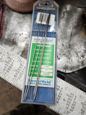

Oh, don't get me wrong, there's plenty of things in the world to gripe about....But what the hell can I do about any of it? I'm just another tooth on the cog. All I can do is just focus on the positives, and just keep doing what I do. Like making some "emergency" 1.5mm knitting needles out of Tungsten Tig electrodes for the Wife :D
Yeah, I’d really go with lanthanated tungsten for - wait what kind of yarn is it?
(You knit wool on DC, cotton on AC, pulse is good for synthetics… )

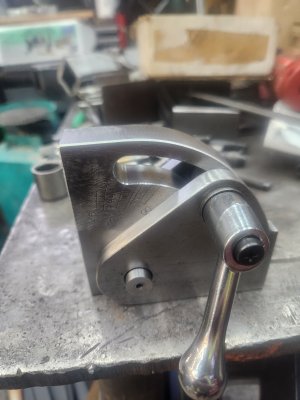

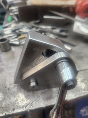

Finally got some uninterrupted shop time today while the kids were at school. Finished the flat platten attachment hinge for the grinder, and finally started going through a bunch of the tooling from my work boxes to integrate with my home boxes. Hopefully I can consolidate everything and get rid of at least one toolbox shortly. Actually I'm counting on being able to do that to actually have room for the grinder when it's finished lol. Taps galore, but do you think I could find a GOOD M12x1.75? I had to use the one from one of those cheap Canadian tire sets and hold my breath....Found a million M8's for some reason....:D I know I have some good ones around, but no idea where. I still have multiple drawers and boxes where the same things are stored. I'll do some digging after dinner while the CNC is running some other parts I'm programming right now.

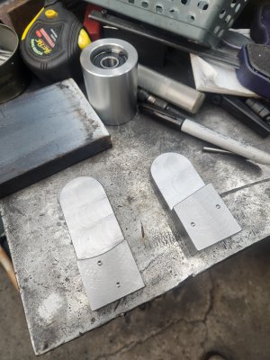

A good productive day today. I got the two wheel arms done tonight. All that's left is to machine now is the platen mount tabs, and a couple anti rotation tabs then I can start welding up the main frame and platen attachment. Oh still need to make (finish designing) the motor mount plate too, and cast the drive wheel....and the tension arm....and everything related to the work rest......:D

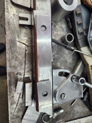

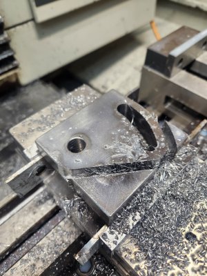

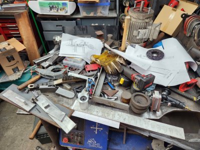

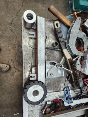

Today was a bit more productive in the shop though. Dragged my ass all morning and didn't get started until after lunch but I officially have all the parts machined for the fixed platen attachment, but still a few more to go before I can start welding. Hoping I can get an early start tomorrow though.
It's all in this pic somewhere.....still need to release a few parts from their stock though.....My 10" contact wheel came too, as well as the rest of the hardware I need to finish it, so no excuses now....:D
This is the first time things have been layed out thus far. Encouraging.....

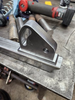

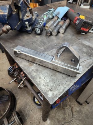

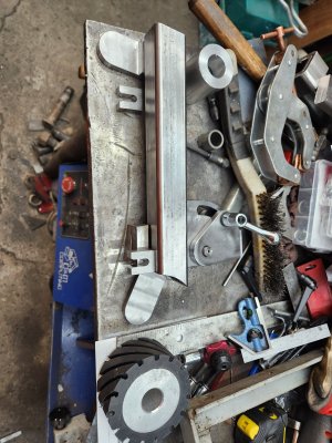

Another productive day. Didn't get to the axle turning like I was hoping to, but did get to some lathe stuff.

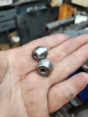

Nothing fancy, just some adjustable rotational stops. They will get welded from the backside so the front side still looks clean like that. Don't think I'll get to the rest of the turning tonight. My back is screaming, and my lathe is short.....Just doing those was enough for today. That's a problem for tomorrow hopefully......I might square up the material for the tracking hinge after dinner if I'm feeling it. The mill is tall....:D. That's one of the last things to machine (besides the axles) and then I'm on to assembly. Another solid day and I should be done with all the components.

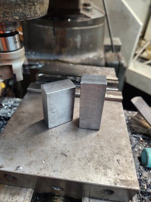

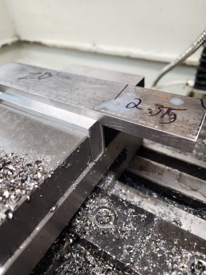

Another thing I did today was cut down some parallels to 4" lengths. I've accumulated 5 sets of these things over the years, and now that I have double 4" vises in the Tormach, the extra overhang can actually get in the way sometimes. This part had some profiling on both sides of the jaws, so I would have hit the std 6" ones. Thought about seting up the surface grinder with a cutoff wheel, and doing it "proper", but elected for the get it done, zip wheel in an angle grinder method for expediency.....
SO much better. I will zip an entire set down to 4" next time I get some play time, and maybe another set too. I don't need 5 anymore and the leftovers will be handy for small grinding vises, or other setup blocks.

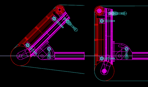

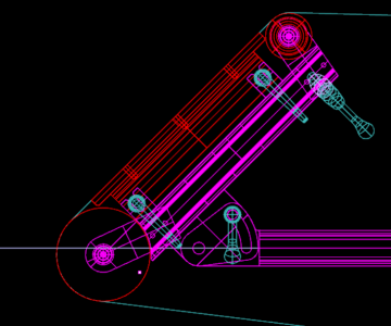

One of the reasons I decided to design my own grinder is because I enjoy the challenge of coming up with different ways to do things. That's one of the most enjoyable parts of this hobby for me. One of the design goals of this grinder was to have the all contact wheels rotate around the same pivot point, and be the same vertical or horizontal. I have a 4" rubber contact wheel on the bottom of the flat platen attachment, and when I tilt the platen back 45*, the contact wheel comes up to the center of the pivot. Then when I tilt the grinder horizontally, it'll swing through the center of the wheel. This was an important feature I wanted to incorporate, and it took some head scratching to get it to work, and even more to actually fit in the space I had available. I was initially using a 2"sq tube for the backbone of the platen attachment, but another design goal I wanted to maintain was to keep everything as neat and tucked into the middle of the belt and clear down both sides as much as possible. I felt with the 2" tube, and 2" belt I'd have to shift it side to side, to do any shoulder grinding. So I made the switch to 1.5" sq tube on the fly........sure I'd updated the CAD model, but at no point did the alarm bells go off that I also needed to adjust the hinge geometry to accommodate for the dimensional change. I'd also taken that time to adjust the throat in the front to give me more slack belt room when I removed the platen..... Long story short, Those two changes affected my pivot geometry and I didn't notice it until last night when I was playing around in cad checking clearances in all positions for some new attachments I was working on, and discovered that for some reason, my carefully calculated hinge point wasn't bringing my wheel up to center anymore.....
Here's the model showing the issue. That horizontal line is the pivot point of the grinder, and as you can see, as built something was amiss....
I was racking my brain trying to figure it out how and where it happened, until I hit on the tube change on the fly. Fault found, The designer and machinist were both blaming each other for that one....but where do I go from here? Between the tube change, and added clearance, the distance deficit ended up being 0.375", so I could either remake the entire piece making it 3/8" longer (not the most appealing fix), or ad a spacer. I thought about welding a piece onto the back of the hinge block and then trying to blend it all in to hide it, but an old co worker/journeyman of mine used to say, "if you're going to F*&K something up, at least turn the fix into a feature".... With that in mind, I decided to make a shim piece, and "turn it into a feature" Thanks Pauly. :D
Here's the updated model, showing the proper function again with the spacer.
