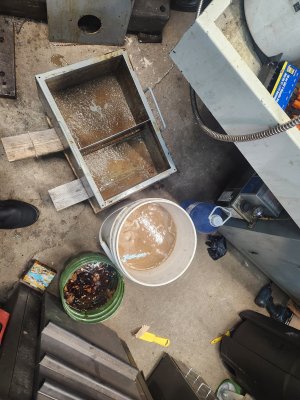

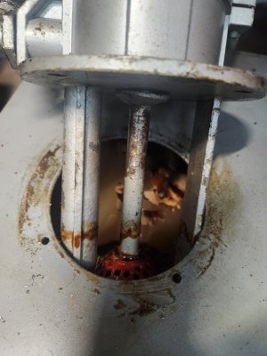

Probably going to take a couple days before I start making chips again but there's progress.

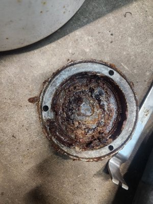

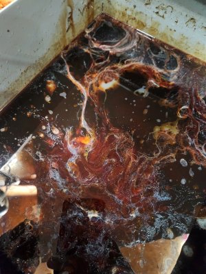

Tramp oil, or distant galaxy....you tell me....I mean, that's almost art it's so beautiful.....
Yummy stuff.....

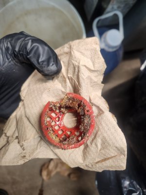

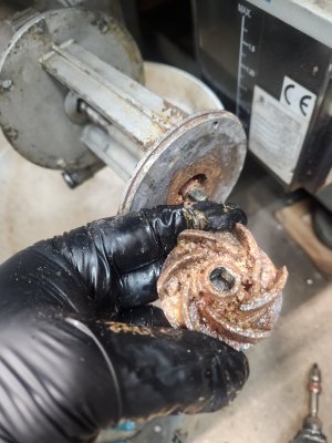

No wonder the coolant system wasn't working......Anyway, a bit of elbow grease later I got it all cleaned up. I've always found the best solvent for coolant, was always the coolant itself, but even that wasn't touching it, this was too far gone. Brake cleaner didn't budge it either. Tried a few things, but WD40 of all things worked the best. Most of it slid right off, and I picked, scraped, and brushed the hard stuff that wouldn't. Then it was brake cleaner to clean the wd off, which worked great. Wish I had a big ultrasonic to just toss them in....
Good as used.

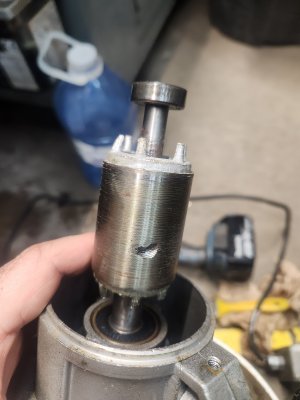

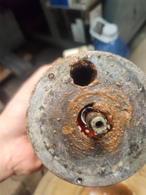

Had to laugh at this though, that can't be good.....No damage, or repair marks anywhere else, so I'm assuming it happened prior to machining at the factory. Ship it.....
Took a couple shots of penicillin afterwards, so I might only come down with a mild case of syphilis from this.

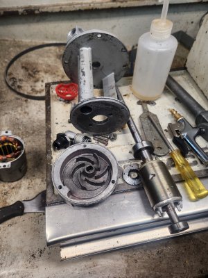

I still need to clean the actual sump, which shouldn't be too bad, and I'm going to do away with the fabulous Tormach shower hose and replumb the entire line and nozzles. I think the entire machine needs a good cleaning too. I wasn't going to, but I really don't want any of the old stuff contaminating the new stuff, so it's going to be worth it to take the extra time to do it right and start from scratch. This coolant pump is also pretty terrible and a very common upgrade, so I'll start shopping around now. I'd also like to add an oil skimmer or aerator (or both) as well.

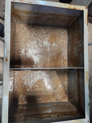

Got called in for a breakdown last Tuesday morning with my coffee in hand as I was heading out the door to run some errands, and it turned into a week+ long adventure.....So, now I'm finally back on the sump cleanout. Procrastinated most of the morning holding the couch down, toying with some cad modeling until the fedex guy showed up with some parts for a project. One I need the CNC for, so I figured I better put some rubber gloves back on and get at it.....
First I put the pump back together, and then skimmed the oil/flubber off the top into a separate tub. Then I used the pump to drain what was left of the old coolant into a pail.
Yummy stuff. Wish I would have done this way back when I bought it, but I was in a hurry to make stuff, and one thing lead to another......but here I am.....
There was about 1/4"-3/4" of sludge/chips on the bottom of the sump, I scraped off into the garbage can.
Mmmmm, Taco Tuesday.....
Next was the wd40 to break up the remaining stuff stuck to the sides/bottom, followed by a couple rounds of brake/parts cleaner.
Good as new.
I need to pull the pump apart again and clean it again, as it gummed up pumping the the leftovers off. It really has no tolerance for digesting crap. Should be a lot easier this time....

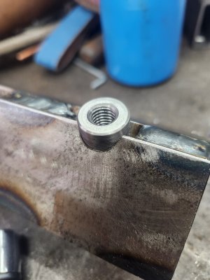

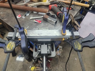

I actually made some physical progress on the grinder today. I've been designing, and redesigning for what seems like forever. Trying to add as many features as I can while future proof myself from silly mistakes that might pop up with later designed attachments, but I think I finally have a solid enough base that I can start building. Last night I again changed back to a very early design of my hinge because of clearance issues something else caused. It's a pretty involved design, way more complicated than is necessary and that was the reason I went away from it at the start, but the more I added, the more I realized it was the lesser of 10 evils. Oh well, it'll look cool, and be fun to machine......😀.
Teaser pics of my tubes welded up. I initially went with doubled up pop cans on each side (0.009-0.010" total), and found them too tight for my liking so I cut half apart, and went with a single slice of steel banding strap @ 0.018" as a shim. IMO they seem about perfect. If I had something at 0.015" I think that would have been just right.
Now I have to sit down and finalize my hinge design to the material I dug out that should work, and will get to machine them this week. Those are the big ticket items, and once done, the rest should be pretty straight forward.
