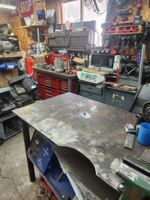

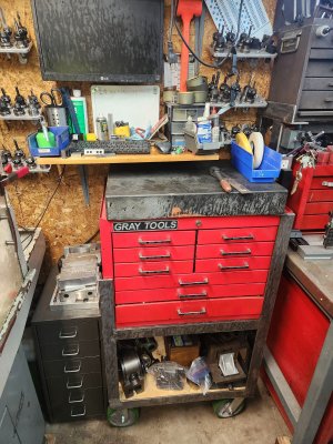

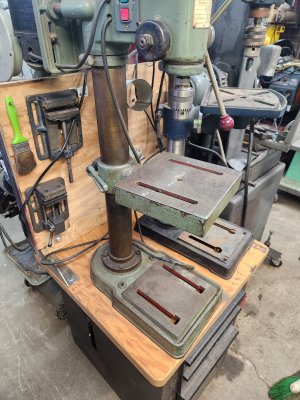

Then I just moved around the shop cleaning and putting things back in their homes. If they didn't have a home, I made one. The drill presses got cleaned up, and I made a spot to hang the vises on the backboard. Little things like this go a long way to keeping things tidy and organized for me. I can work in clutter, but I'm much more productive when I'm organized.

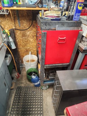

Beside the drill presses is the CNC area that has been in disarray since I needed to shift stuff to get that hydraulic powerpack out from under the CNC enclosure to yank the motor for the grinder a while back. I just never bothered to move these boxes back where they belong, and it was blocking my access to my workbench/toolbox. One of those things I'll ignore/work around for so long until I just can't anymore.......
Back together as it should be.
I can walk through here again....

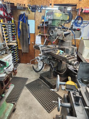

Next I moved onto cleaning up the manual mill and gave that area a good clean up and chip removal....It was bad....Once this grinder is done I need to make some way covers and table covers too. Then turn some attention to tooling storage along that back wall.....It's also bad.....

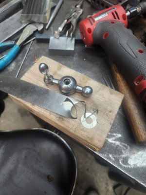

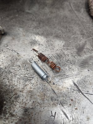

Along the way there were a few side quests.....Like fixing these stuck and sticky vise grips. The spring was streched and kept coming off, and they were also a bit tight. I cleaned them all out with brake cleaner, wire brush and penetrating oil, then heated them up a bit to melt wax into the moving parts and screw. This is the first time I've tried wax for this after reading about it a while back. Seems to work great, I'll see how good it still works in a few days, weeks, etc....Found a spring that fit great, and they're back together and working great again.
https://i.imgur.com/WDUOrOk.mp4

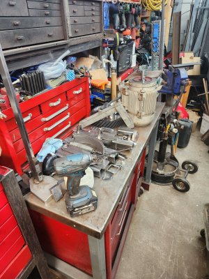

While cleaning up I found all these guys on the ground under my welding table covered in filth. I normally keep them stuck underneath my table, but they all fell down at some point, and as you can see, were quite a mess....I have a love hate relationship with these magnets.....They work great for some situations, but boy do they collect a mess....
A quick and vigorous brush with a wire brush over the garbage can knocked almost all the crap off them, and a quick blast with the air finished them off.
Now to store them in a place free from grit, they're not going back under the table again.....

Is your drill press a Kira? I sure regret selling mine... :(
This one is a Jet. I've seen the same model with different tags though. It's a decent mid size drill press. Wish it had a bit more power and variable speed though. I may try and fit a treadmill motor to it someday.
I bought it because I needed something bigger and better than my 10" skil, and then a month later my Dad moved, and traded me his mastercraft for my little one. Don't need both in there, but the mastercraft start rusting in the barn so I brought it in before it got worse, and I don't have another spot for it yet, but that's going to change soon.

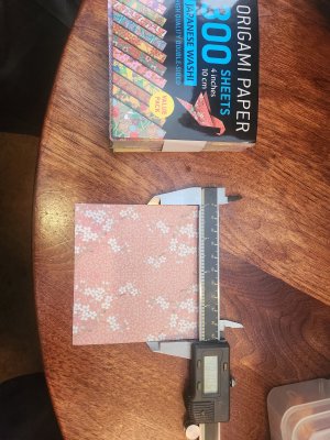

Had a proud Dad moment this morning while I was brushing my Daughters hair before school. She spotted this pack of origami paper on the coffee table and said "4 inches or 10cm.....Well which is it, because they are different....". So we grabbed the calipers to verify, and they are indeed a bit over 4", but certainly not 10cm.
Thought some here might find that amusing....I certainly did.

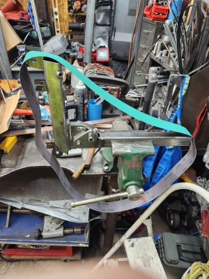

Moving on.....I have almost all the welding done on the platen assembly. I didn't drill the axle holes when i made the arms because I wanted to do it after it was all welded up and skim the face and pitch them out. Probably overkill, but it's a pretty guaranteed way to ensure that they are in the same plane as each other, and take all welding warpage and movement out of the question. Letting it cool now, and will throw it in the mill, skim the faces and drill the holes later tonight. Then I can weld on the platen mount tabs, as they'd be in the way of clamping.

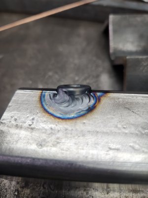

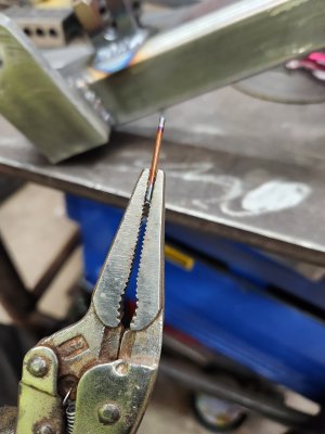

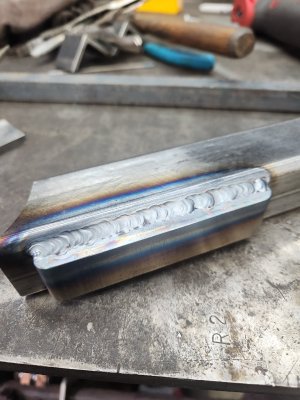

First TIG welds in a while....I've certainly done worse, but could be better.....
Next welds on the feature plate. Freehand, because I've never got along with props. Too much stick/slip, and I find my tempo is worse. I need to work on it though....just practice. Oh look at that prefect 1/2" spacing to the bottom.....Nailed it too lol.

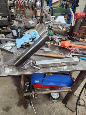

Oh, wait, WTF happend here Dan.....(the tab is 1", and my setup block here). This is when I discovered my second mistake on this same part.

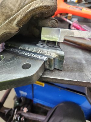

Here's how I aligned the wheel arms. Drilled 1/8" holes at specific locations and used some roll pins to fixture them in place.

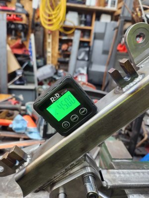

Worked great, and as the next picture shows, the 1.5" radius on the end of the bottom arm, sits flat on the table at 45* verifying that centerline pivot I've been trying to maintain.
Only dipped 3 tungstens too :D. Still need lots more practice though. Pretty rough and inconsistent still. Always was to be honest about my ability. I'm way too shakey for instagram welding......
Thanks David. The nice part about tig on steel, is that you can just wash over it again lol. There are a few of spots on here like that........

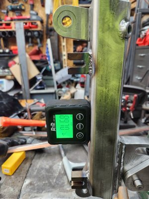

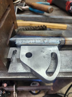

Drilled the axles holes, and spotfaced a Z reference, then welded the platen tabs on after dinner. The platen attachment is DONE. :D
With the tube held square in the vise, I ran an indicator across the hinge plate, it was basically zero in one direction (in/out), and had a 0.005" run in the vertical. You will have to take my word for that, as I must have fat fingered my phone and not got that video of the up down....The arms were as I expected, quite out, but most of that is probably warpage from milling. I really had no concern for that, as I was drilling the holes square to the frame anyway, and perpendicularity of my axles will come from that press fit. Am I taking this too far? Probably....:D

After dinner I went out and finished machining the tracking hinge assembly.
Old school style...
If you don't own some of these deburing blades, you should. They don't get used much, but they sure work great when nothing else will
Had to dust off my old daily driver......It's been a while....
And a quick fit test....This is straight off the mill, just deburring. Good enough for me....:D
https://i.imgur.com/YG4fCBB.mp4
It's actually a bit tighter than I'd like it, so I might file fit it a bit but I'll see what it's like when assembled. I kind of made a design error, and made this a weld on assembly, when I probably should have bolted it. I think the weld joint might pull it open a bit, but I can toss a clamp on it during fitup. One of those things that looks great in cad, but when you actually start making it.....Damn designers......
