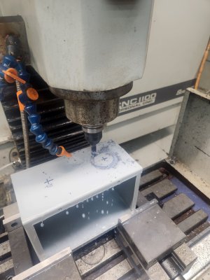

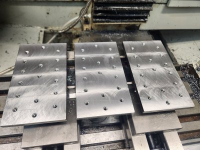

This post has been a long time coming. It was all the way back in June when the axis stepper on the Tormach shit the bed, and for a variety of reasons (mostly money) I've only been able to chip away at it here and there to get it back up and running, the coolant system all flushed, fixed and refilled with new. But it's now done and working again as it should. My initial impression of the Trimsol is very good. Time will tell, but I like it so far, compared to what was in it before, and the old Cimcool stuff we used to use at work. I am curious to see how it does with rusting, as the old stuff was terrible. As you can see......
I've never been a big fan of the stock Tormach coolant system, It's undersized for a bandsaw, let alone a VMC, even a baby one like the this, but it'll work for now until I can build a much better system. Started imagineering something while watching it run these cutouts, and think I have a pretty good plan of what I want, but it'll have to wait until the warmer weather as I need to pull it out from the corner, and chop up the enclosure a bunch.
Got as far as I could tonight on the splitter box until parts come tomorrow. Should be able to wrap it up quick once they get here, and then post what it is actually for...... Until then, I'm going to start cutting parts for the belt grinder now :D.

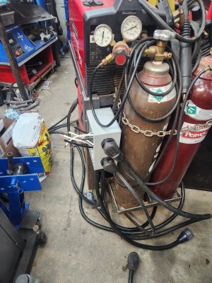

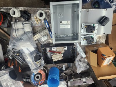

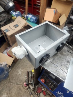

Had this idea a couple of years ago when I built the welding cart. Bought the receptacles, ordered the din rail terminal blocks, (too small) ground bars, and (too small) black plastic box. When they got here and I started to lay stuff out it was apparent that it was way too tight of a squeeze. I also didn't like the terminal blocks. They're rated for the wire and current, but they just felt too janky for the application. Not sure why, but this got shelved and put on the back burner and stuffed in a drawer until a few days ago when I needed to do some tig welding, and had to pull the cart out, swap plugs and push it back in.... It's a major pain in the fat belly.... So I thought, Hey, why don't I finish that splitter box so I never have to do this again....So I ordered a new (bigger and metal) box, some 3 port polaris connectors, and a proper sized ground bar. When they got here, I had a bright idea to also use the cut off female end of the 8awg extension cord I was using for incoming power, as another plug I can use with my plasma, or spot welder so I had to order more cable glands, and 4 port polaris connectors. The part I was waiting on today.

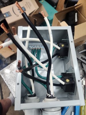

This is where I got to last night waiting for the polaris connectors. Box is fastened to the cart with 4x#10-24 button heads.

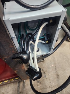

Quick job to torque them down when they got here.
https://imgur.com/D0lDrlU
Now there's enough cord that I can wheel the cart out to either the front or back doors of the garage and use either welder, plus my spot, or plasma at any time without having to pull it out from the wall and squeeze in there to swap plugs everytime. I know these are a polarizing topic on the web with regards to legality and safety but in single user shop I'm not worried. This is a much better way to do it than adding extra receptacles on the same circuit in my opinion. And also provides a bit more utility in my shop. The polaris connectors feel WAY more solid than those din rail terminal blocks.
Didn't get to machining anything on the grinder today either. Snowblower repairs......But that's two long term projects crossed off my list this weekend. Back to work this week so I probably wont get much done on the grinder for a while :(
Those Polaris connectors look great! I'll have to remember that.
I despise working in too-small electrical enclosures, typically with wiring cut too short to help it fit. Guaranteed swearing fest.
I like the Polaris Connectors too. Ya, as far as I know, they are not approved. But they can be a great space saver and they are quite reliable if they are used correctly. Some people don't like them because they can be very fussy. This is one application where a torque wrench is a good idea. Too little torque can lead to a poor connection and overheating, and too much torque can damage the wire and/or connector. You also need to use the right size for your wire gauge and the right kind to be used without stripping the wire back or that require wire stripping. I prefer the ones you don't strip the insulation.
Having room to work in a box is always a nice luxury. Polaris connectors are great and make a nice and solid connection for larger gauge wires.
Looking at these pics now I wish I would have taken the time to trim the wire to get them to lay in there nicer, but I was in a get it done mood by the time they arrived.....
This is only the second time I've ever used them, but I've never heard of ones that don't require stripping? What application are those used for?
I will give these a double check in a couple weeks after using both welders a bit.
It's a standard application. The packaging should describe which type you have as well as the required torque.
Sounds good.

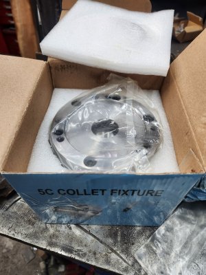

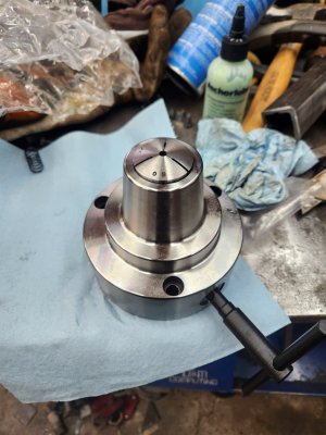

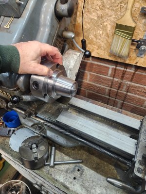

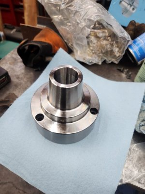

While browsing around the rainforest yesterday, I stumbled on this chuck. Seemed like too good of a deal to be true. $149 with a %20 off coupon? Always wanting a collet chuck for the myford I took a gamble on it.
I've watched reviews on these import 5c chucks before, and they're a mixed bag. Some good, some bad, but I always view this stuff from a "kit" mentality. Until I make a back plate for it, and get it mounted I really have no way of evaluating it for runout, or dimensional accuracy, but I gotta say the fit and finish is really nice. There is a bit of a tight spot/eccentricity when tightening a collet so I will have to investigate that. Not terrible, but enough to annoy. Whether that eccentricity affects accuracy or not remains to be seen but for $135 delivered I think it's workable. Now I just need to find time to make a backplate for it. Thinking about making a set tru style, but will mull it over for a while. Too much other stuff on my plate right now to touch this for a while, so I stuffed it back in the box for another day.
