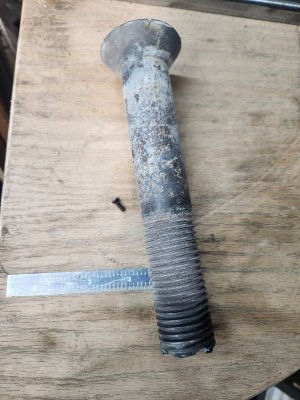

Cleaned out my tools from the car this morning, and couldn't help but laugh about the size difference of hardware I used to work with, compared to what I work with now..... A #4-40x0.375" flat head vs a 1.25"-12x9" (torched shorter) Flat head.
Saved a few from the scrap bin so I can turn the axles for the grinder from them.

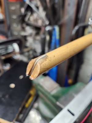

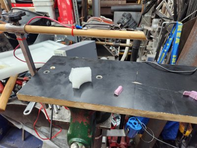

Started mulling over a design the past couple days. Wanted it it to be a quick and simple build and was simply going to hack together something out of plywood but once I got going on it, I start gravitating in a diferent direction....one thing led to another and now I have a hot wire cutter....
I didn't really take a lot of pics along the way, and this was very much a build from the junkpile with minimal effort type of build.

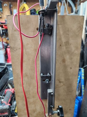

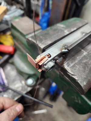

This is the frame underneath. I tried to make it stout, but adjustable in every which way. The wire is clamped to the lower frame with a homemade clamp, it runs through a steel tube (inflator needle) pressed into the table, and then through the same, but curved 90* in the upper arm. A simple loop hooked on a spring completes the connection. The table is adjustable so I can line up the lower bushing with the upper one for square cuts. The arm is adjustable in/out so I can cut a taper if I want to.
I'm pretty happy with it. Still need to make a fence, and adjustable pivot for cutting circles, but that shouldn't be too bad. Right now I'm using 0.02" stainless lock wire, but have a few other types of old guitar string to try out too. Using an adjustable bench power supply to power it.

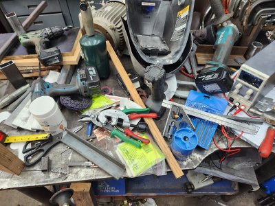

And a shot of the bench while I was building this, just to appease the resident squatch. This is pretty normal around here. A project on top of a project, on top of a project.....
Well, at least I got one project finished on the bench today.....
atta boy...thats how they should look all the time!!
About 90% of the time, that's how ALL my benches look. I can't be trusted with flat surfaces. When I'm done with a project however, I love nothing more than cleaning up, and putting all my tools back into their homes. The problem is I always have multiple projects going on, so that's a rarity, but it does actually happen once in a while......
