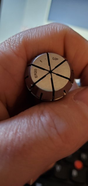

So I now have a ER20 collet in 1mm. Boy is that a small and one ER25 collet in 15mm

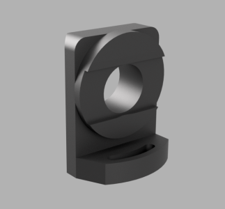

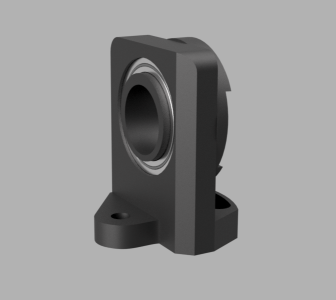

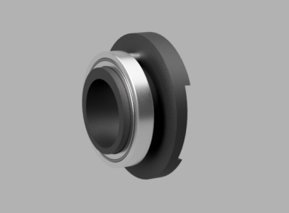

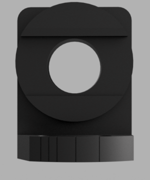

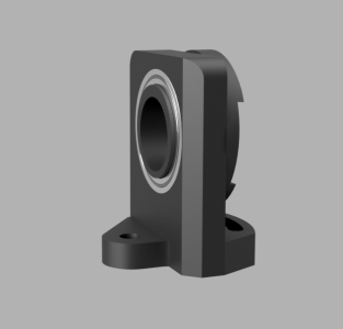

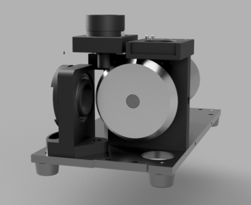

I modeled up the grinding seat..
I'm pretty sure that I have the right anglular offsets and such, but I think they have made the 90 degree stops differently than I have. I'' change what i've done later.
They use a 35mm ID and 47mm OD bearing 6807-2RS with the tool holder pressed into the ID.

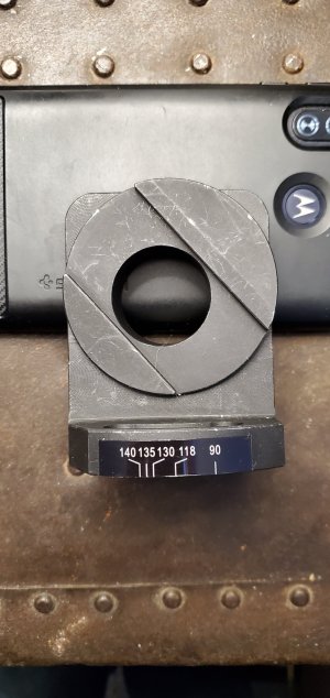

This is how I elected to limit the range of motion on the grinding seat and some of how I modeled the part (for the benefit of @Susquatch ).
I believe the manufacturer intended to allow a rotational travel between 0 to 45 degrees. I may very well be wrong. Perhaps others can examine their grinding seat and see what they think?

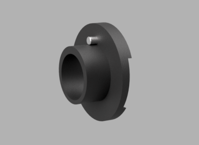

I've elected to use a 5mm pin set in the tool insert as a stop.
The tool insert in held in the base by the press fit bearing. Show here pressed on out of order, but you should get the gist of things.

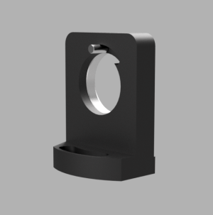

The base with milled slot to allow the 45 degrees of travel, and stop pin which is fixed into the tool insert.
I don't think the factory has a good alignment technique for press fitting the bearing, or their stop mechanism is poorly designed/made, since my grinding seat has an imperfect alignment.

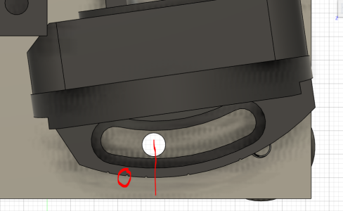

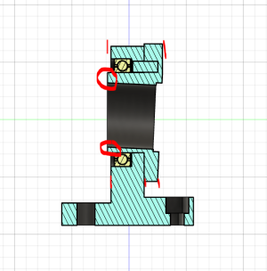

I had to guesstimate a couple of criteria (by sketching a section drawing of the part) based on how and what I could measure at home without proper metrology tools other than my calipers.
I wanted to get the vertical offset angle thru the bore as precise as possible not knowing how critical this angle is. I measured the offset of the bore where it exits the protruding shaft on the bearing side. Shown circled below.
On my grinding seat I thought these were 4.5mm on top, and 2.5mm on the bottom, or a 1mm offset from center. The tricky part for me was to find out what angle that offset resulted in. I also measured the total depth of the insert from the thickest flat portion of the flange to the end of the shaft section.

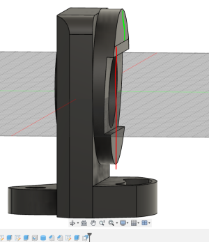

I used the dimensions to lay out a section drawing similar to what is shown above. From there I extruded the solid tool insert part perpendicular to the base and the width of the full width dimensions.
Then I cut the offset angle out of a portion of the flange. The green section remains perpendicular to the base while the red section is the offset. I did this by selecting that area of the sketch and extruding a cut thru the existing part.
Then I cut out the 30mm slot thru the flange at the same angular offset as is on the face. I did this by selecting that section of the sketch and extruding it thru the part horizontally.
Only now did I have a reference to accurately draw and extrude a bore thru the tool holder. I selected the face of the cut out slot, and drew construction lines to find the center of the face. I then drew 28mm circle on the face and extruded the hole to create the bore thru the part at the correct offset angle.

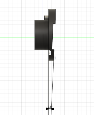

Only one thing bothers me. The thinnest section of the flange at the bottom seems bigger than the actual measured part on my part. Everything else seems correct as far as I can tell.
Here is what my offset angle is... I'm thinking maybe that is 2.5 degrees in the manufacturer's design? I wont need to know for sure until I decide to make a grinding seat in ER40 size, or make more seats to use in end mill sharpener.

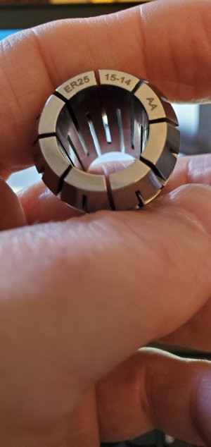

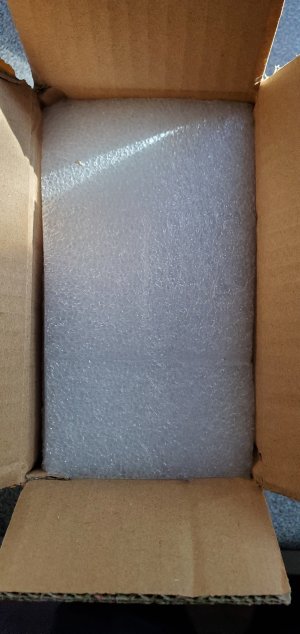

My ER25 chuck arrived today...
Best packaged shipment I've ever received. It was a little pricier than I'd like but it is good to see where the money went.
Silky smooth threading.
It fits my grinding tool holders, a little snug going in then fine. I'm sure it will wear in a bit in use or when I buff the chamfers a bit
All four sides were like this, with a shipping label from local logistics company stuck over top on one side.
Perfectly fitted foam padding.
swaddled in bed and wrapped in a blankie

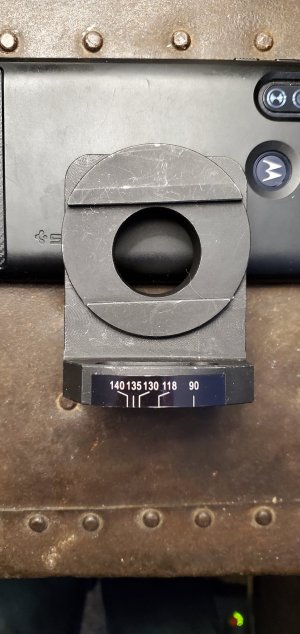

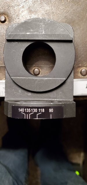

My seat starts out at -3.0 degrees and moves to 40.1 deg measured with my SmartTool digital level. I zeroed it first.
This would be 43 deg of movement, I think.
Great thanks.
I suspect that with two showing similar results that maybe this is what they wanted in the way of travel

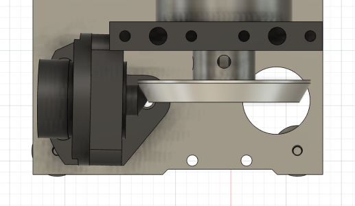

Slowly as I have time the model grows

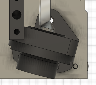

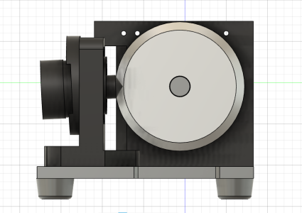

reality check, I modeled the part independently and then positioned it to align with the mounting holes in the base plate... and the result is this:
here is the alignment, the pointer is 118 degrees..
Seems to be perfectly centered. But the grinding seat will crash against the vertical motor mount where it has been extended... so I need to trim that back.
The degree scale on the grinding seat doesn't match the actual scale...
I think I am right, maybe it is just the imaging that is off? I can test this...
Mine at 90 degree angle looks correct... looks like the bit needs more projection. But I can see an issue. This is 14mm drill bit.
Wider bits will need a deeper wheel to grind at 90 degrees. Time to check every other setting, but I expect the same
Houston we have a problem...
135 degrees on the cone, the grinding seat shifted over looks good so far...
back to the drawing board
