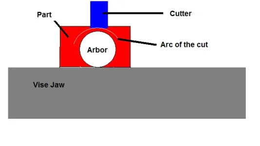

Here's a trick. locate or make an arbor that is the same diameter as your hole (or close, it doesn't have to be perfect)
Clamp the workpiece in the vice with the arbor resting on top of the jaws. You can take successive cuts, making a concentric arc made of short lines that way - the result if very nice, and no thought or extra work to follow the inside circle...

This might not help much, but cuts are made across the part along the Y axis, and the part is indexed (or rotated, if you will) around the arbor, makinc a segmented OD cut in an arc to make very nice flexible clamping.....

At my daughters place. Just taking a short break. I see now. I thought you were describing another way to bore the hole. But you are telling me how to make a more flexible motor clamp.

I see why the arbour isn't critical at all. All it does is maintain the spacing between the ID of the hole and the end mill. One could take as many cuts as desired to make it round or multi faceted.
I really like the possibility of a multi faceted result so I may try this. Unfortunately, my vice isn't deep enough to allow the bottom of the hole to be level with the top of the vice. Perhaps some bar stock on top of the vice just for spacing purposes.
