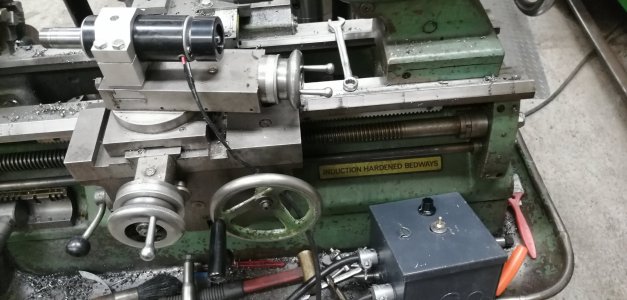

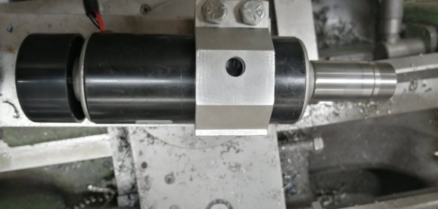

OK, done. Main issue i am seeing is that the collet wobbles at over 6000 rpm. But otherwise great. I have speed control and even on off switch.
You can see where I milled it thin. I hope now it's more clear.

I should show you my design. No issues - used original aluminium. Less work. Just make it square and add an adapter plate to the bottom. The whole thing is very rigid. It is held with 3/8 bolt against T-nut.
Basically I machined T-nut - simple - right?
I machined the original clamp square so its even. I measured how much higher it needs to be then my spindle - about 5.5mm. I machined adapter plate of 5.5mm. I added adapter plate to the bottom via 4 tiny cap screws - I think size 10-24. The 3/8 just holds the adapter plate against T-nut. Works great. Very rigid. Maybe I would not lift the whole lathe by it but I am sure it will work for the grind stones.

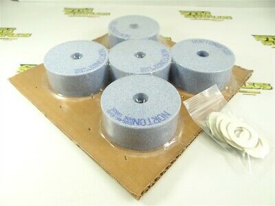

I might take you up on cup wheel. I need to figure out adaptability to my bench grinder. Is 1.25 the hole ID I assume?
NORTON ALUNDUM CUP GRINDING WHEELS 4"/3" X 1-1/2" X 1-1/4"
Yes, 1 1/4 is I think standard for SG. You can always use adapter - my TC&G is 1 in and I have some adapters to use same wheels as on SG.

Collet is attached via two set screws. Its a DC motor and you simply lower the voltage to get speed down. I do not think it will be a big deal, these grinders are usually not too powerful - I mean 6" pedestal grinders are usually 250w and they move two 6" stones doing far more cutting action then 3" or similar stone.
AH. I see.
I'd heard that those ER11 chucks were impossible to remove from the shaft.
Did you buy or make a new er20 collet chuck? I may just buy a dedicated tool post grinder spindle
Yes the ER11 chuck was like .1mm smaller then the spindle. Same with the ER20. I could not have put them on, it was not even close to interference fit. So I reamed 8mm. Not sure whatever that was a great idea - I guess I see soon.
